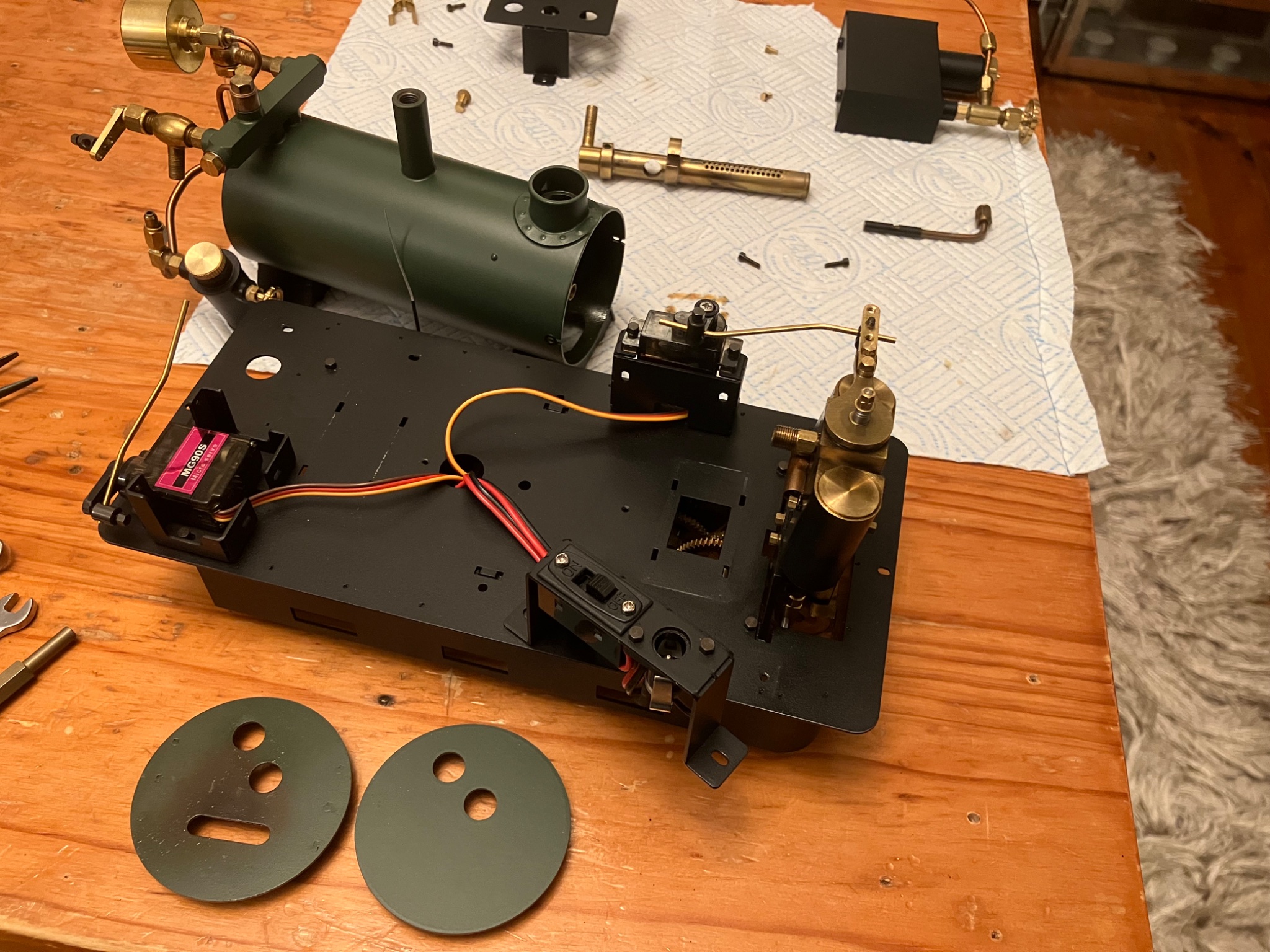

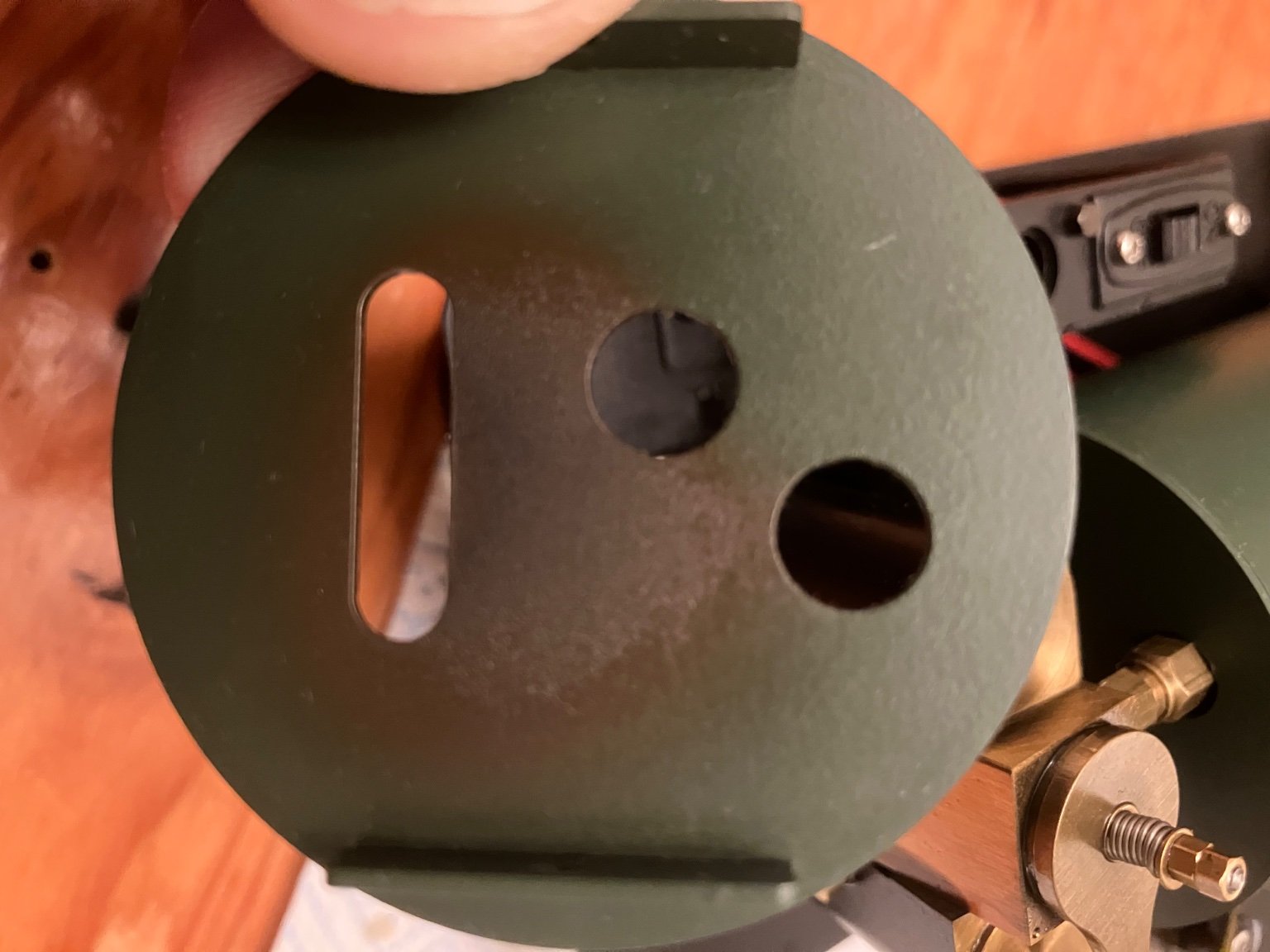

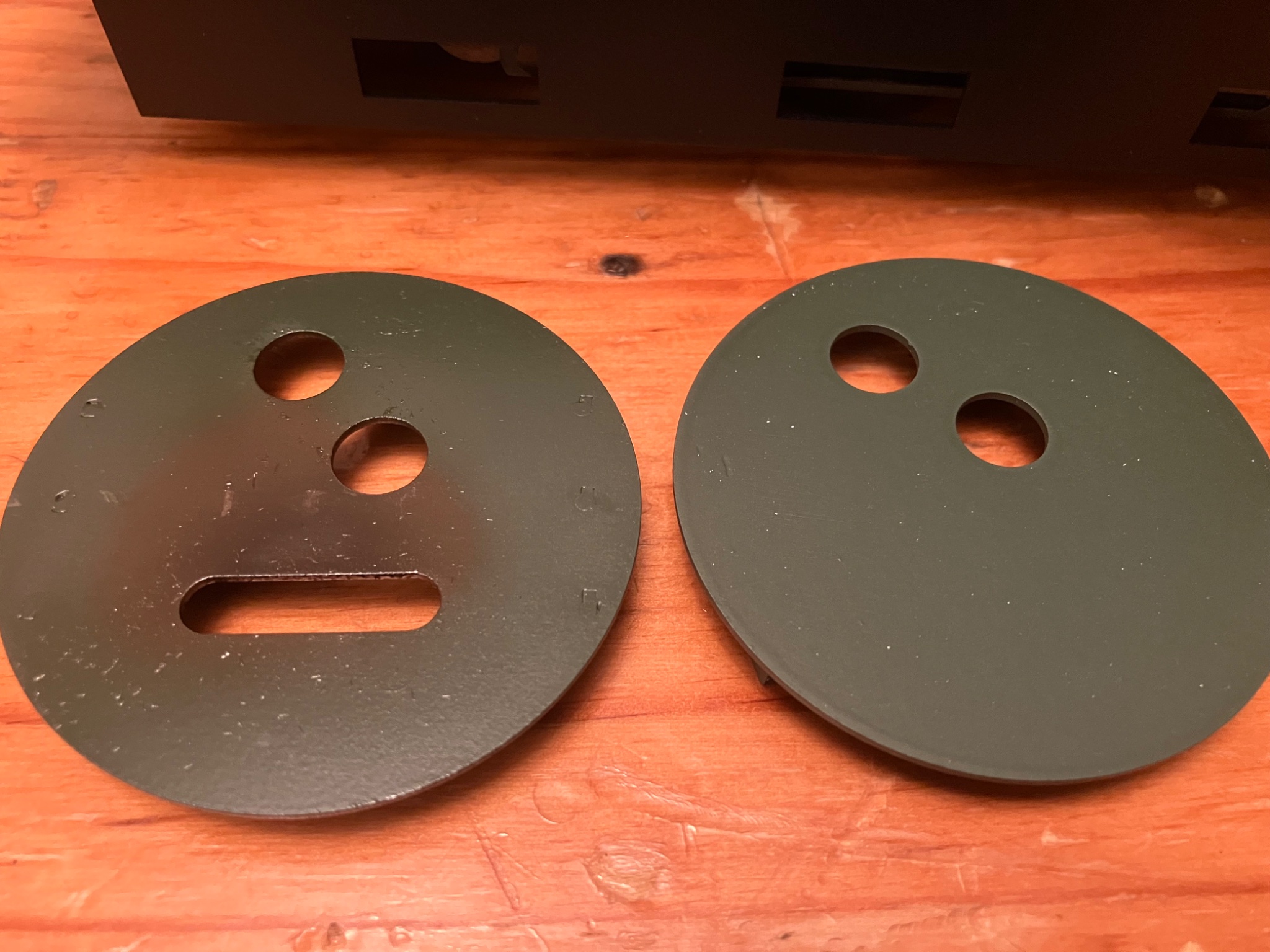

I decided to fit the later smokebox door, after a few steamings & noticed discolouration around the slot in the door. Even with the gas turned down low, the heat was starting to affect the paint. So a call to Graham at GRL & the replacement door was here in a few weeks. Some partial disassembly was required to remove the boiler & slacken off the union nuts to the steam & exhaust pipes

Comparison of the two parts with the discolouration
So Graham's solution is closing the slot entirely? I suspect the heat on the back of the door will discolor it fairly quickly! You can't easily see it anyway, so why are you bothered?

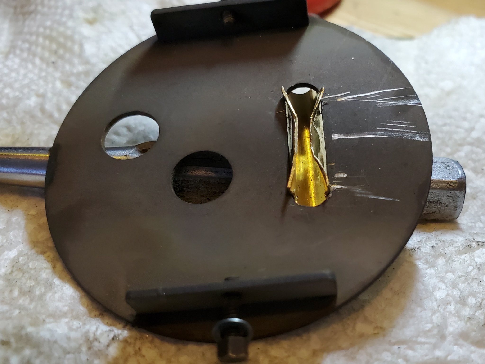

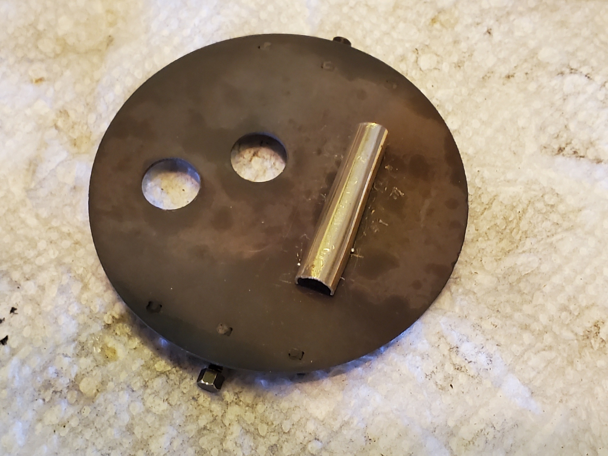

I inserted a brass diverter in the slot to keep the heat away from the springs.
Here's the inside view. Just a folded strip with the ends bent to make it stay:

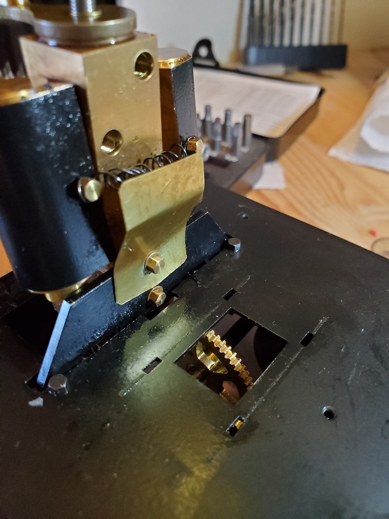

And this is the plate that diverts heat away from the springs. I made it, but a similar one is supplied by my US dealer, TTD.
A worthy upgrade to anyone who owns one of the very early Paul tram’s, despite the fiddly steam pipe connections. Hopefully this will keep the cylinder springs from weakening.
No detrimental effect to the boiler, lighting up ok & flame popping back with air collar in place on the burner.
Live steam test ok, just bodywork to refit, then ready for another summers steaming in the garden.
No, the replacement part is from Regner, but was ordered via Graham.
I think Regner now fit (or supply with the kit) the closed door on all newer models, to alleviate the problem with the weakened cylinder springs.
