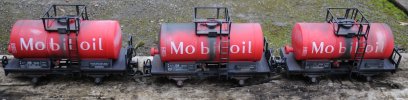

I had a rake of 'Train' tanker wagons plus one LGB tanker. For weathering I prefer to dismantle evrything, be it wagons, coaches or locos. No problem for the other stock but those 'Train' tankers had to be done as best as possible by brush with the final overall spraying done fitted together as usual. Yes, some technical terms in broad Derbyshire dialect were applied along with various tools (all except Mr Lumphammer - but it was close).
At least you straightened out the 'Mobil Oil' signwriting on those tankers.... :clap:
That was just plain luck Gizzy, I bought them on eBay unseen but as said they were 'Train' and not 'NukeKiddo' so possibly made in a different factory. Still the same useless screws though, you know the ones that if you insist with the wrong tool they go:
