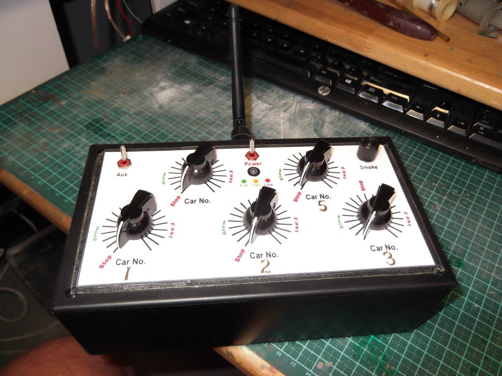

A new traction system for the tramway has been on the cards for a while now. Until this point I've been using conventional straight DC fed via overhead wire, with a maximum voltage of 12v. It worked, but all the inherent problems of straight DC were present, and I really wanted a more robust and flexible system for working outside.
A list of requirements were drawn up:
*independent control of more than one tram at once
*independent lighting
*potential for special function controls
*reliable operation in dirty conditions
*low unit cost
*minimum specialist hardware
The conventional solution, to the first three points at least, is a DCC system. It was an option I looked into, but it falls flat on the last three points, especially cost. The thing that killed it was the need for a a specialist power supply, as well as the DCC equipment that needed to be fitted to each piece of rollingstock.
Instead I decided to go for a radio control system, using the same deltang/RCS equipment I was already using for battery powered rollingstock. Only in this case the radio receiver and motor controller would get power straight from the overhead wire. Of course it wasn't going to be quite that simple, since some ancillary equipment is needed to ensure a clean, reliable DC supply to the motor controller.
