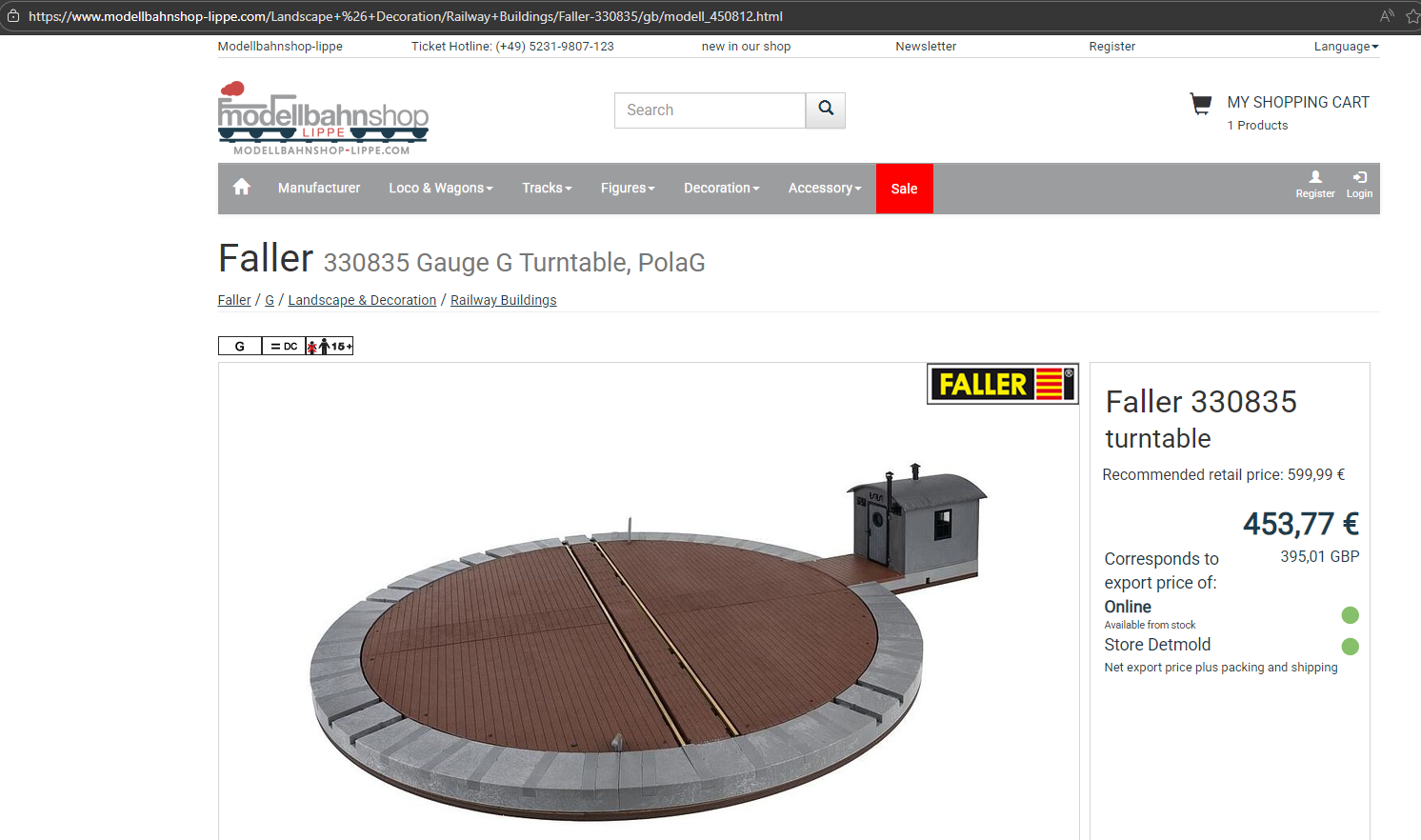

on sale currently in Europe. But i am sure customs will charge me 20% VAT when delivered to UK. still sounds like a good deal, i am tempted. These retails for £700+ in UK

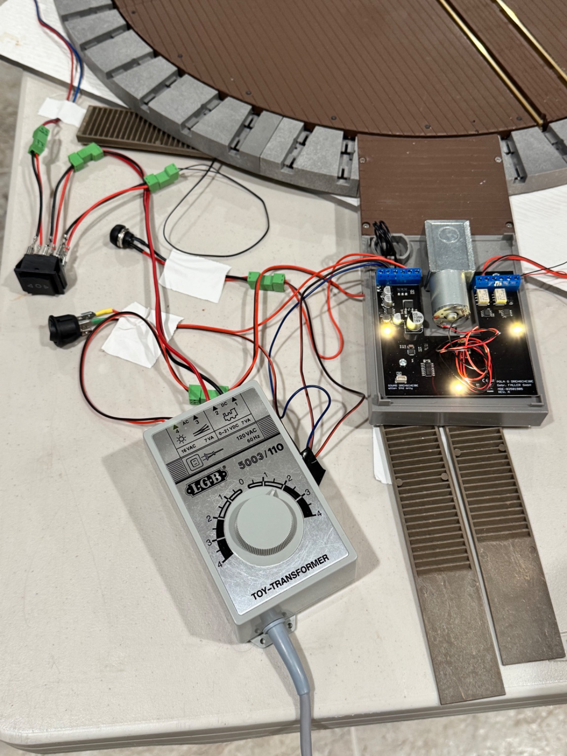

Continued working with the DC setup and testing. Had a Momentary Motor Polarity Reverse Rocker Switch DC 20A 12V DPDT 6 Pin 3 Position ON/Off/ON Motor Control in inventory….photo attached. Putting that between track power and contact plate allowed loco to move from turntable to main track. Not graceful but it works. Hopefully the DCC will utilize the reverse loop in the decoder.

Setup and test of the Pola Turntable in DC mode is complete.
I have now wired the turntable to the Roco Z21 XL control unit. Specifically, from the Program Track terminal to the turntable decoder unit terminals X1 and X2. And the turntable contact plate to decoder terminals X7 and X8. Multimeter indicates power coming into decoder and power at X7 and X8 but the decoder’s led lights are not on. Various programming attempts fail.
I will continue researching the turntable instructions to discover my errors.
Suggestions welcome.
DCC control unit reads the cv values from turntable decoder and displays them in the Z21 app. Unfortunately, the turntable does not respond to the Z21 app commands. I feel sure that I’m missing a necessary communication step.
I should also add the loco runs nicely onto turntable even when I manually rotate table 180•. I believe this indicates the reverse loop function in decoder is active.
You need to give it a name and CV1 number in the Z21, I would think it would be in the locomotive area rather than as an accessory as with the motor it is effectively a locomotive.
Long day on the learning curve to program DCC communication between Roco Z21 XL controller and the Pola Turntable. Assigning an address to the turntable as a Loco did not succeed to establish control of the turntable via the Z21 app. I reviewed all the CV values and was able to activate the circuit board led lights and the lights that I attached to terminals X9/X10 and X11/X12. I assigned track numbers via CV addresses. All the various CV values did not produce rotation activation.
The Z21 app is a graphic application. There is a graphic turntable representation in the app. The turntable did not respond via the app as a loco graphic nor as a turntable graphic.
Not having access to the instructions:
Is it a 'driving' decoder? - Needing a loco address.
OR:
Is it an 'accessory' decoder? - Needing an address like those used for driving points etc.
CV29 - long address, or short address?
Does it suggest you used the speed control knob to rotate the turntable?
Do you select a road-number, and just press 'go'?
Do you use two function buttons, one for clockwise, one for anti-clockwise?
Just a few ideas to work through..

Got the thing delivered today. The best part - His Majesty Revenue And Customs somehow missed the parcel - it is arrived to my door at exactly £395 . I don't get how HMRC works - sometimes they send a bill before delivery - sometimes not.
