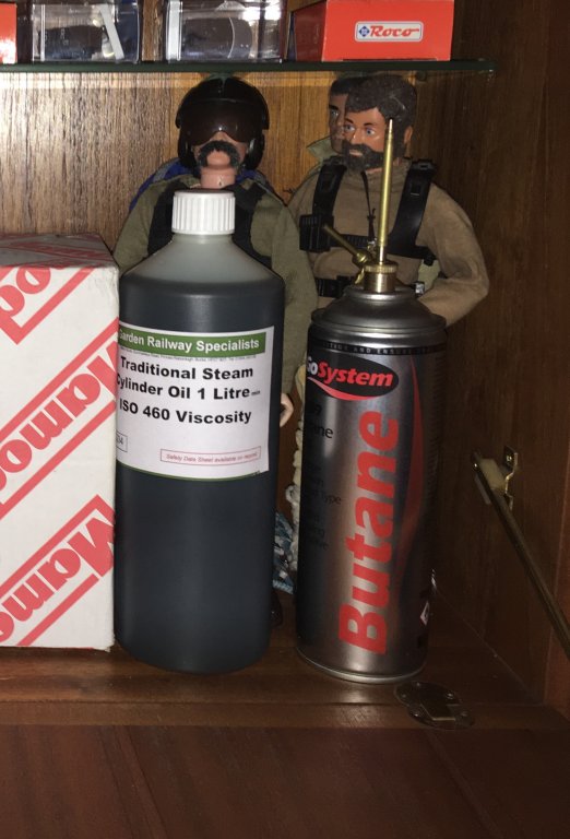

I bought steam oil and a butane only gas canister with the loco will the following suffice?
Yup that will give you a start, oil will last much longer than the Gas.
