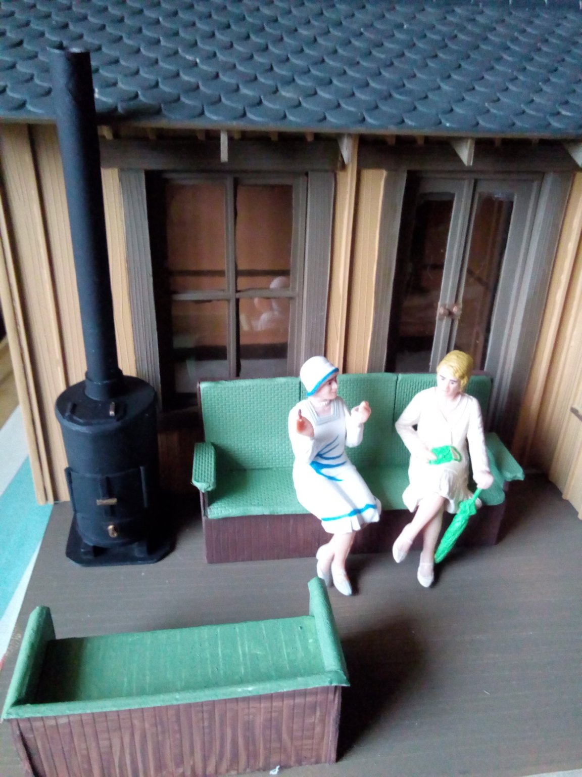

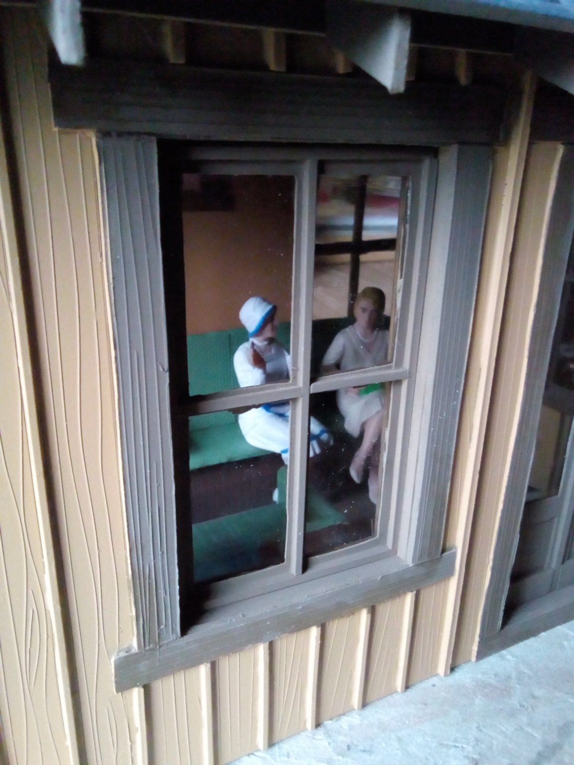

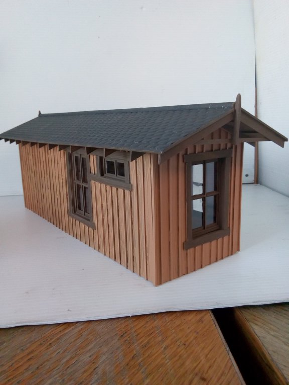

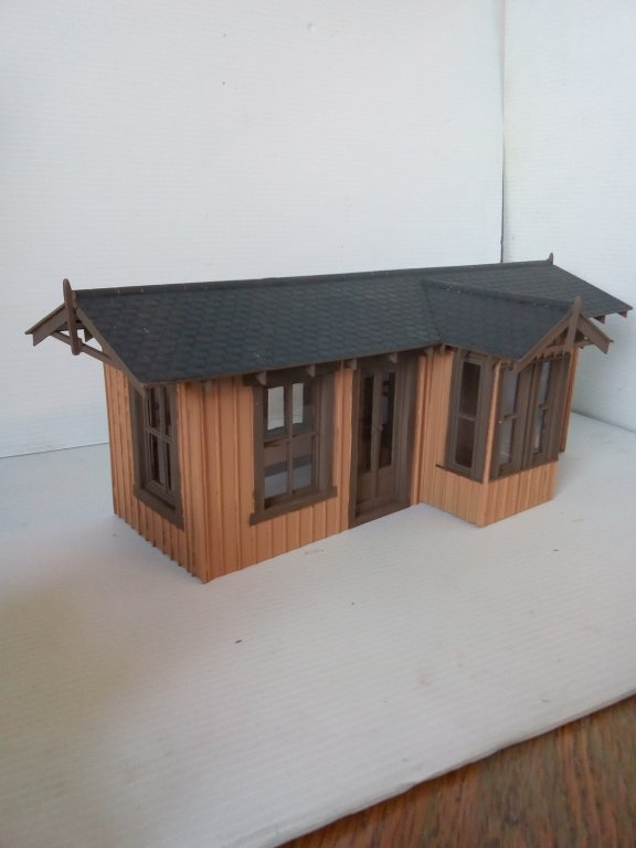

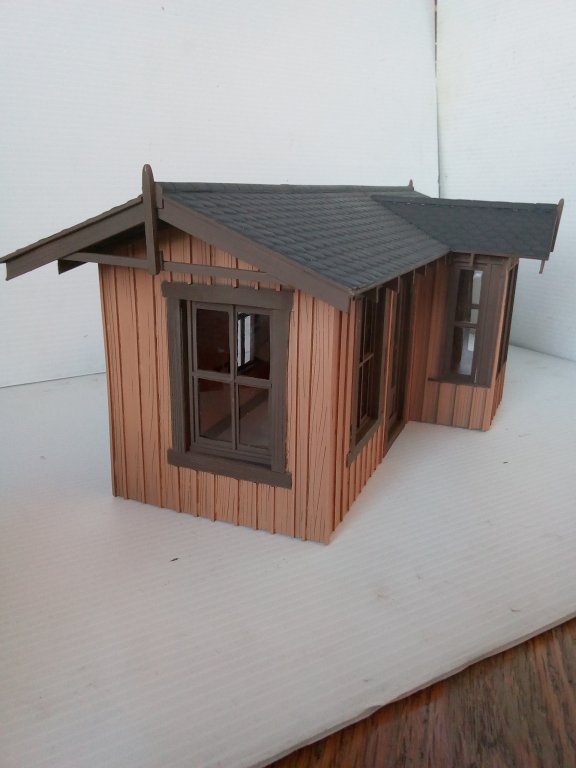

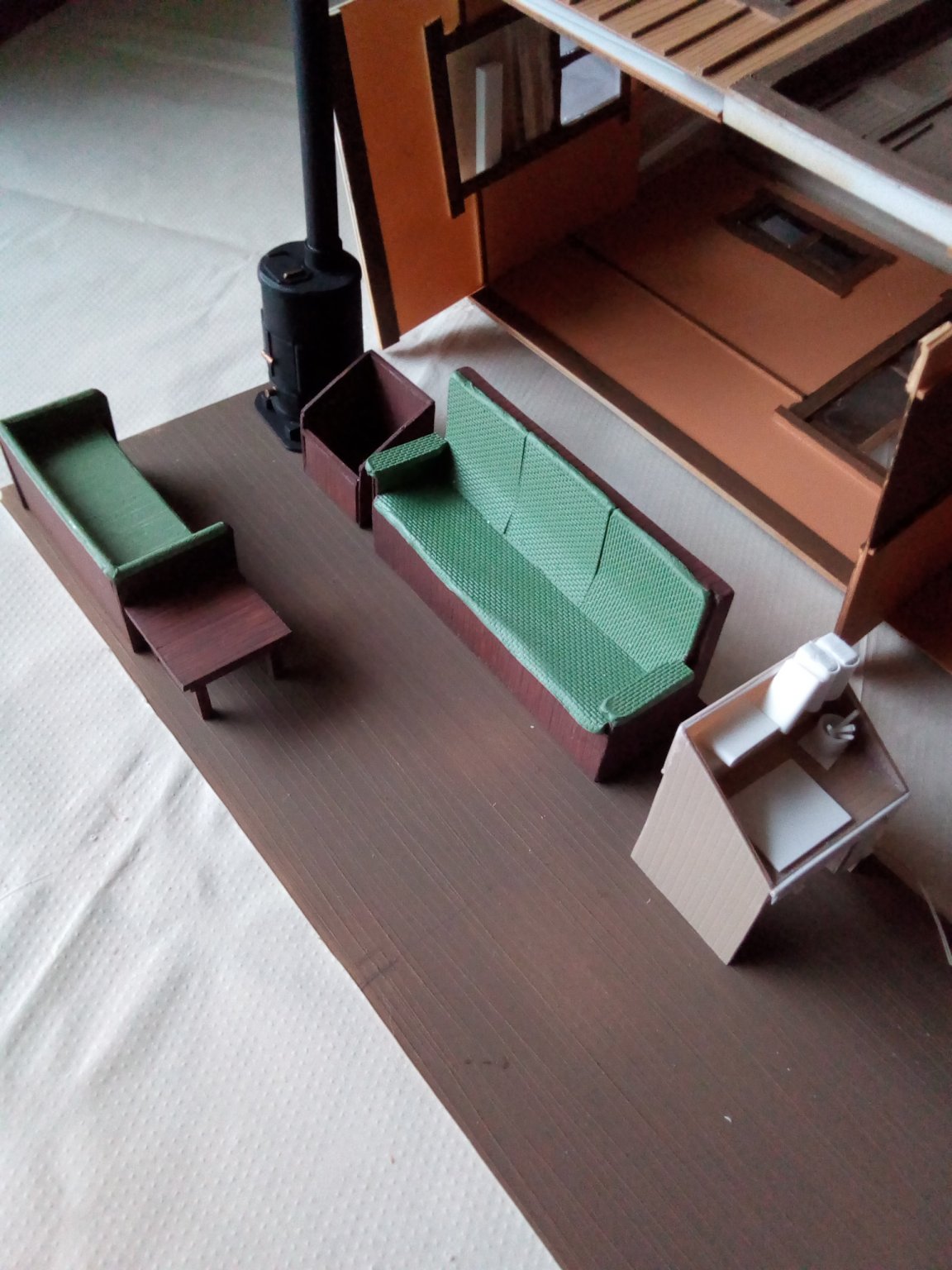

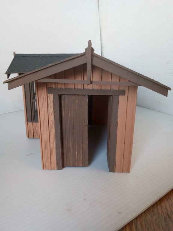

Los Garagos needs a new bigger depot,this was a job I was saving for the winter but while over at Glendale I picked up some roofing slate molding sheet and as was flimsy and a little fragile I decided to shelve the Connie mods(still have Field loco,oil depot and also a Delton caboose to finish
) and start the new depot,I used the normal scribed plasticard wood effect for the walls and frames,
the whole thing was sprayed with dark brown,then all the frames were masked out and then sand was lightly sprayed over to get the final colour but allows the base colour to "bleed" through just slightly,Before the glazing went in the inner walls were cut to size and the window openings marked and cut out,the glaze and the inner walls are all 40thou plasticard/clear and the glaze was cut to fit the openings so the inside window frames fit flush and the inner edge of the frames hold the glaze in place,experience has proved that glaze falls out if just glued in place if buildings left out all year as mine are,the roof tiles then added,laminated with 40 plasticard for strength together with internal supports with a coat of dark grey,still loads to do,second coat roof and tidy paintwork,smoke jack(s)stove,floor,blinds,internal fittings and furniture and some figures etc,the depot name boards will come from the old building,as for the original depot,,,to be moved and converted to another use.
