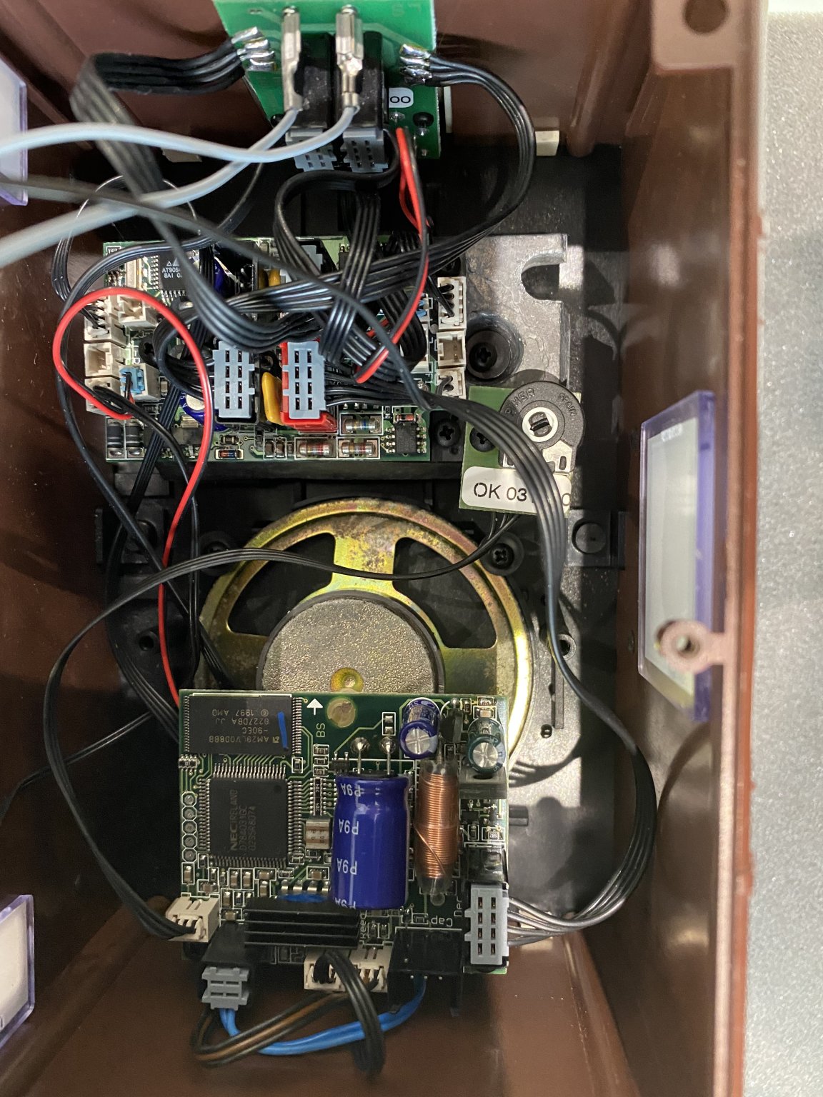

I took the top off the Krokodil and picture of decoder attached also the underside sticker which may be of help.
The loco is no 412, it does have a sound decoder.
Ok so we have a 25402. Crock with LGB on-board Sound Decoder production dating from 2004-2005. Shed has shown the CV values so be worthwhile checking out what values are for CV2,3,4,5 and possibly 29 if you can. That may give a better expert on DCC than me a possible clue to your issues. Write down the values next to the default and Max values a little bit like the table above, so easy to mix things up when changing them! Allow a couple of spare columns to show what you changed them to as well.

HI Robin - This is an LGB On-Board decoder with a separate factory sound decoder (the card with the big capacitor). You may have trouble reading CVs from the decoder - i did even though I was using a Massoth PC Module. The work-around for me was to unplug the sound card from the decoder. I could then read the decoder and change CVs without any trouble. If you find that you need to do this too, just remove the 4-conductor plug from the red socket of the decoder board. Make sure the power is off as a precaution. When you are done, just plug the sound board in again.

The red connector is the SUSI bus for the sound board. You should not have to disconnect the sound board to read CV values.
I would write CV 55 to 55 to do a decoder reset. This is LGB's on board digital decoder and was used in many 2 motor engines and even in the LGB Mogul (needed for the SUSI sound board).
