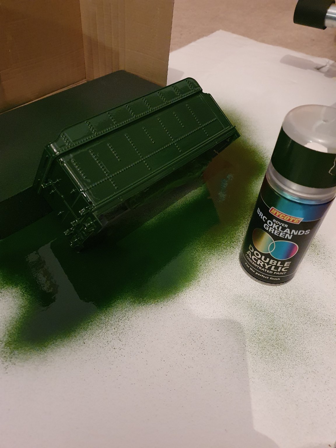

I secured a gen1 Lionel Hogwarts Express a while back which I've started converting to a caricature of a GWR Mogul.
Thankfully because it's the early version, no regauging is necessary.
So it's off with the accoutrements and gut the interior.
The cab steps have been shortened, the second axle in the front pony removed and the smokebox door tidied up. The loco shell was filled where necessary
The pink stuff on the smokebox door is just a latex mask to protect the numbering as im not sure if i want to retain it or not at the moment.
The battery compartment in the tender was trimmed back to accommodate an 11.1v li-ion battery and a power switch wired in to the existing Tamiya connector.
The original speaker which sits behind the firebox was the wrong impedance for the Railpro LM-3S I was going to install, so that was changed out for a correct one in the same diameter.
The tender was sprayed with some Tamiya fine detail primer, then Brooklands Green
Next up wiring everything up, spraying the loco and fitting some details.
The coach is beyond help, so I suspect the 3d-printwd experiment will be pressed into service.
More to come as I progress...
