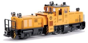

I had one of these track cleaning locos by LGB, expensive (relatively) but it works beautifully. Piko do a smaller one which you could ask @Gizzy about as his boss has one. There are various hand operated devices which work well but are obviously more work.

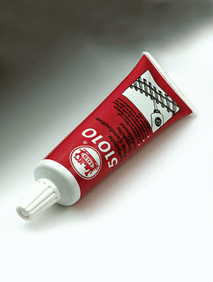

For the fishplates I used a small wire brush then put in a tiny blob of LGB graphite paste when assembling the track, the paste aids conductivity BUT a lot of the people here fit rail clamps instead of fishplates and from experience I can see why as they not only guarantee an electrical connection but hold the track together too which is a huge help especially if your track is not fixed down. An initially expensive outlay but I can see that the results will be well worth it and again something I wish I had used. Shown below are the Massoth (L) and Piko (R) versions.

I am one of those that has a Track Cleaning Loco and uses rail clamps. @pugwash is correct, the rail clamps do have a fairly high initial outlay (I think they're £1.50 each and you'll need 2 per piece of track). However, I've found them to be extremely helpful for the reliability of the railway. Not to say other methods aren't good - just that I can vouch I've been very happy with this approach.
I spoke a bit about this setup in a video (shameless self-plug here!)

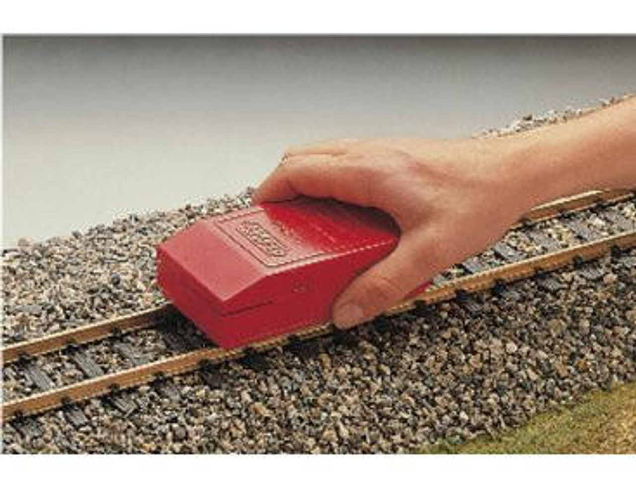

The Track Cleaning loco definitely reduces the effort to clean the track - easy to set it off and potter on other jobs while it does the heavy lifting. Key thing is to run it slowly. However, I'd never be without the LGB Track Cleaning Block (LGB 50040) close to hand to give the odd spot a polish!
Have to agree with Curtis re track clamps, started using them in my old line in Hemel Hempstead back in 2000 a d still using them today in the garden though I went all battery outside some years back now. But I use track clamps on my modest loft railway.
I have the track cleaning locomotive as well - we tend to use it that the start of the period of the year when train running is done.
We used the graphite paste (below, and sometimes a tin of the same stuff from castrol) in the joints whilst laying track and it's made the track power much more reliable - the track has been mostly down for 20 years now.
The manual track cleaning block is also very useful.

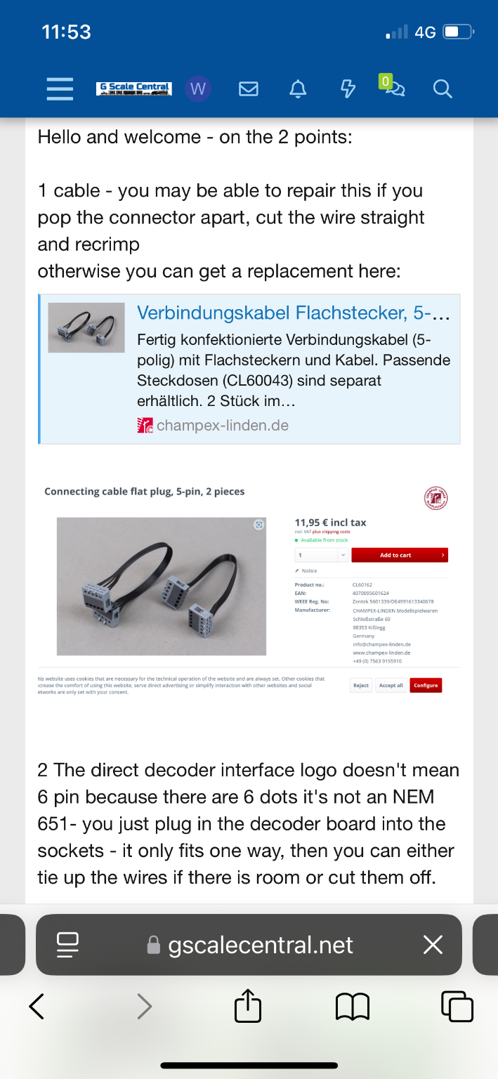

I just now med to find this wire.
Which the team here have told me is a part LGB bought in to use.
So I will start that search.
