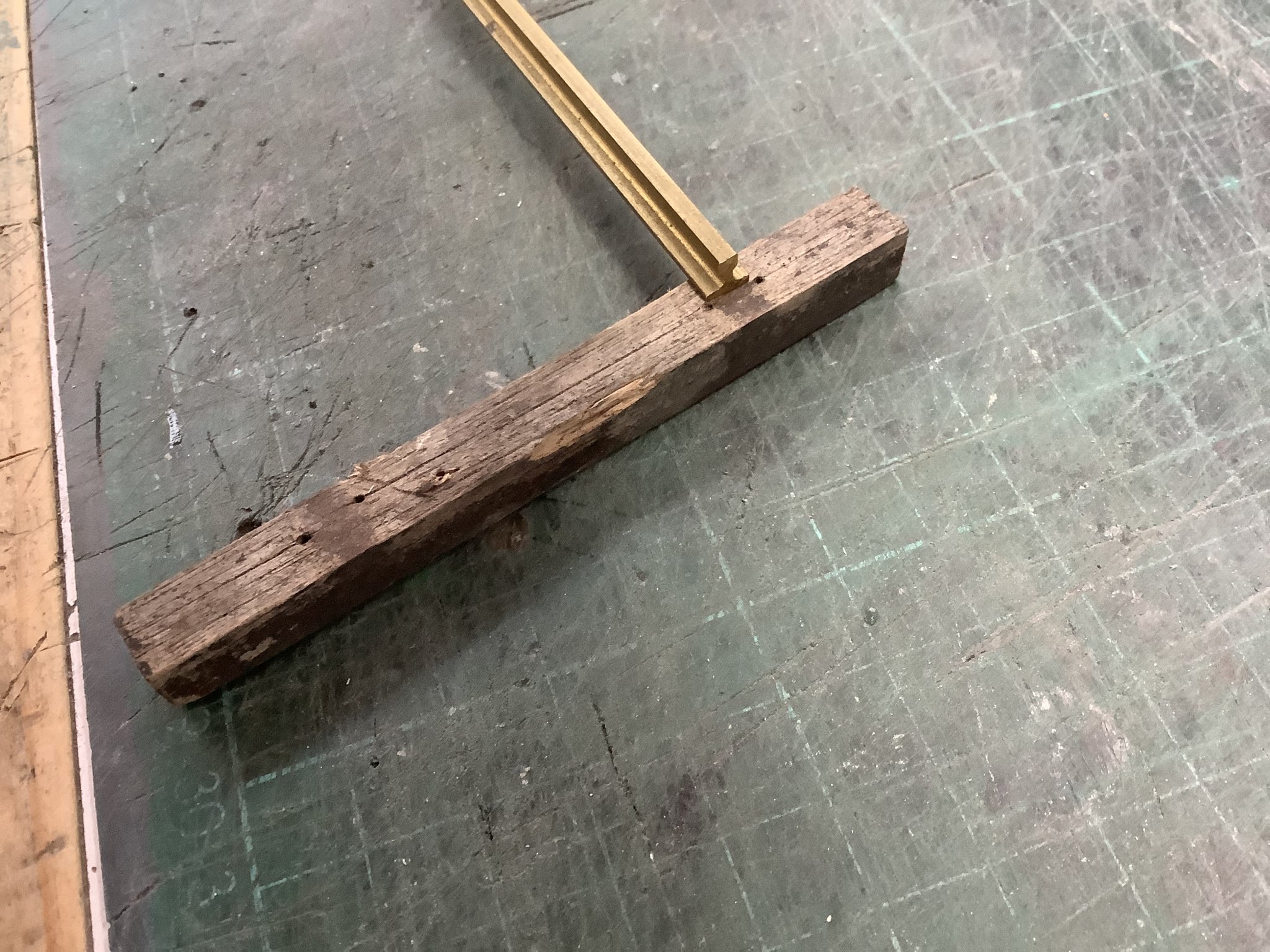

Code 200 FB Rail and 8mm square sleepers by 90mm long showing where the brass pins were inserted. This track proved to be a real pain as the brass pins kept being lifted by weather making sleepers wet then dry. Before every session I had to go round with a pair of pliers and hammer to get them back in place. In the end I got fed up and all the track was replaced with Peco G45, end of the mixed as well. But at least I could run trains though only Live Steam and Battery in them days. I have come round full circle and ditched track power again. I did try it here but failed by getting bored having to bond the rail. Had clamps been available at that time I may well have percevered.
