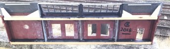

Meanwhile I’ve started on the next building. It is some sort of railway workshop in low relief. I had planned to scratchbuild it, but I picked up a Piko brewery building kit (not the actual brewery) which looked like it would fit the space and be far quicker to build. By using the parts to make a low relief building it fits perfectly. Here it is so far...
Its 36” long but only 2” deep. I’ve used most of the kit parts, with just one wall panel left over which I can probably use for another low relief building. Making the roof is going to be a challenge.

Tonight I’ve added some strengthening sections out of sight, hopefully to make it more robust. As these are a part wood, part plastic, I used superglue to stick them. In the corners I’ve added a fillet by pouring some ‘Rocket Powder’ into the superglue. This works really well as it makes a sort of superglue Milliput that dries quickly.
After it had time to dry, I went to pick it up, it was stuck to the cutting mat on my workbench. Some of the glue had run through a small gap bonding the building to the mat. At least it will make me replace the well used cutting mat.

Here it is with a start made on the roof and a first coat of brick paint.
And a view from the back showing all the strengthening bits.
