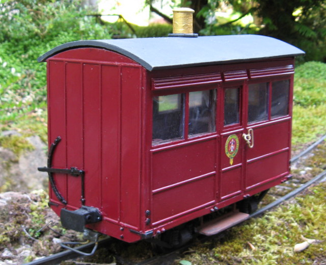

My starting point is the GVT 1901 4-wheeled 3rd class coach - which has a single door on each side.
I've 3D drawn the requisite parts in the ubiquitous Tinkercad - made a lot easier by the fact that the 1901 coaches were based on the earlier 1892 coaches which I've already Tinkercadded

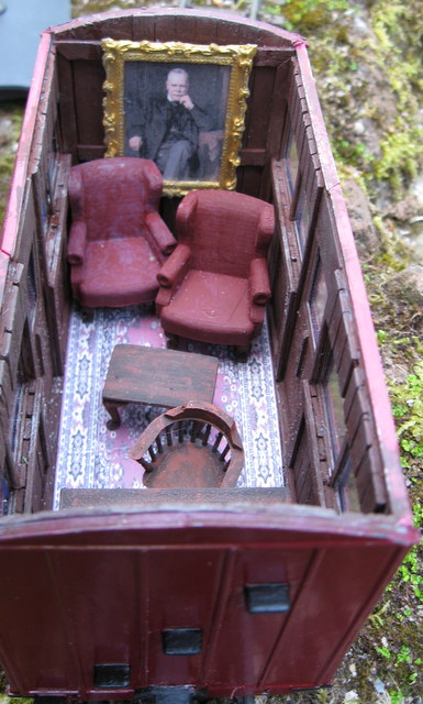

However, as it is a Director's Saloon rather than a bog-standard 3rd class coach, its interior will be a tad more plush.
The (dolls house) furniture was downloaded from Thingiverse and rescaled to 15mm (1:20.3) in Tinkercad. I'll add a few more interior details to add to the opulence (eg drapes and framed artwork) but, hopefully, it will look the part.
