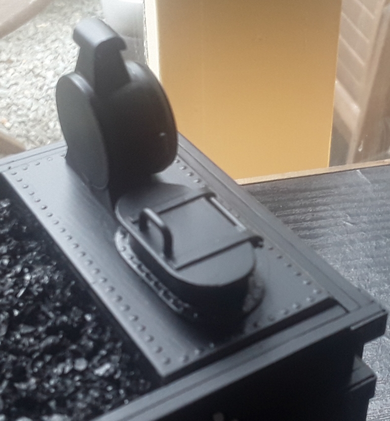

Not so well known here are Archer's Archer Surface Details Their products are waterslide decals that make the process of adding lines of rivets, ok not bolt heads, a doddle. You simply cut a line (or single) from the sheet and apply direct to the model's surface then paint over.
In the picture below they were sprayed over with Halfords rattle can auto paint. Note the carrier film does not show. All I have used is Microscale's "Set" & ""Sol" solutions to aid their settling on the surface. Not cheap and you may have to source direct, a US hobby supplier or ebay traders (there are some UK based) Max

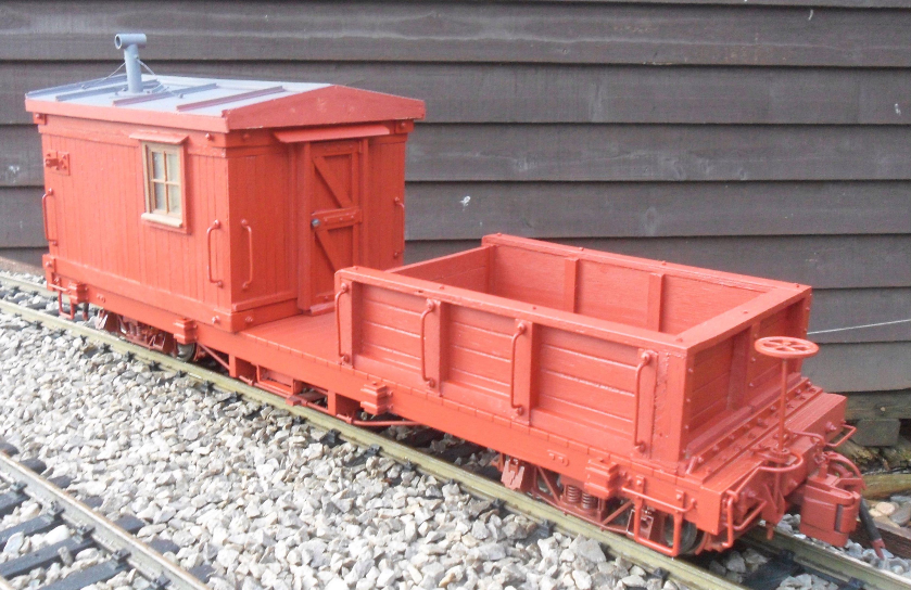

I have used Cambrian products for many years - there are 1584 nuts bolts washers and rivets on this DZ gon -

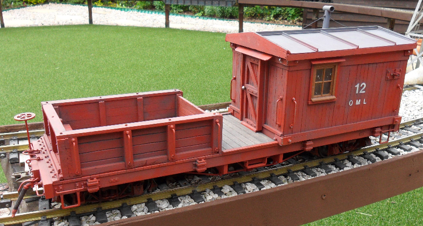

Quite a few on this MoW van...

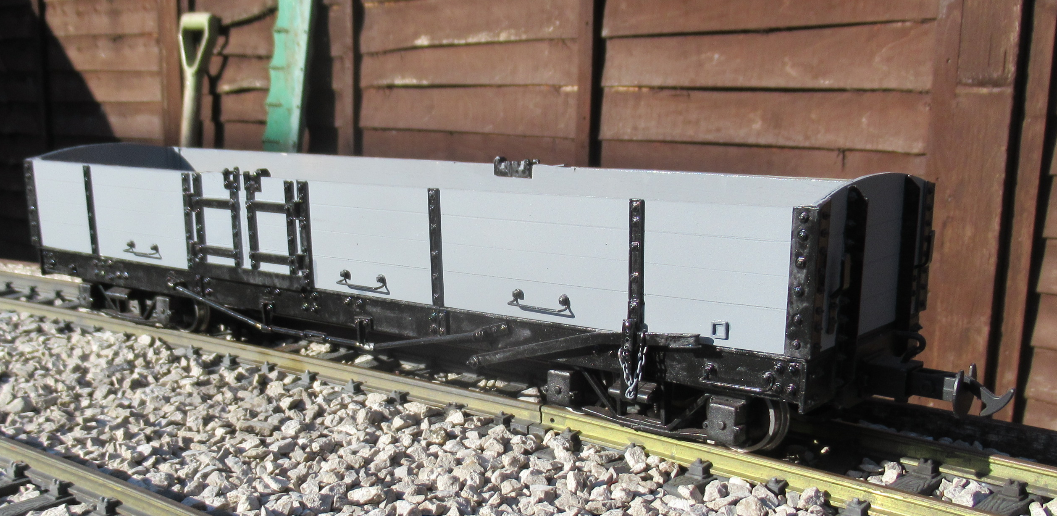

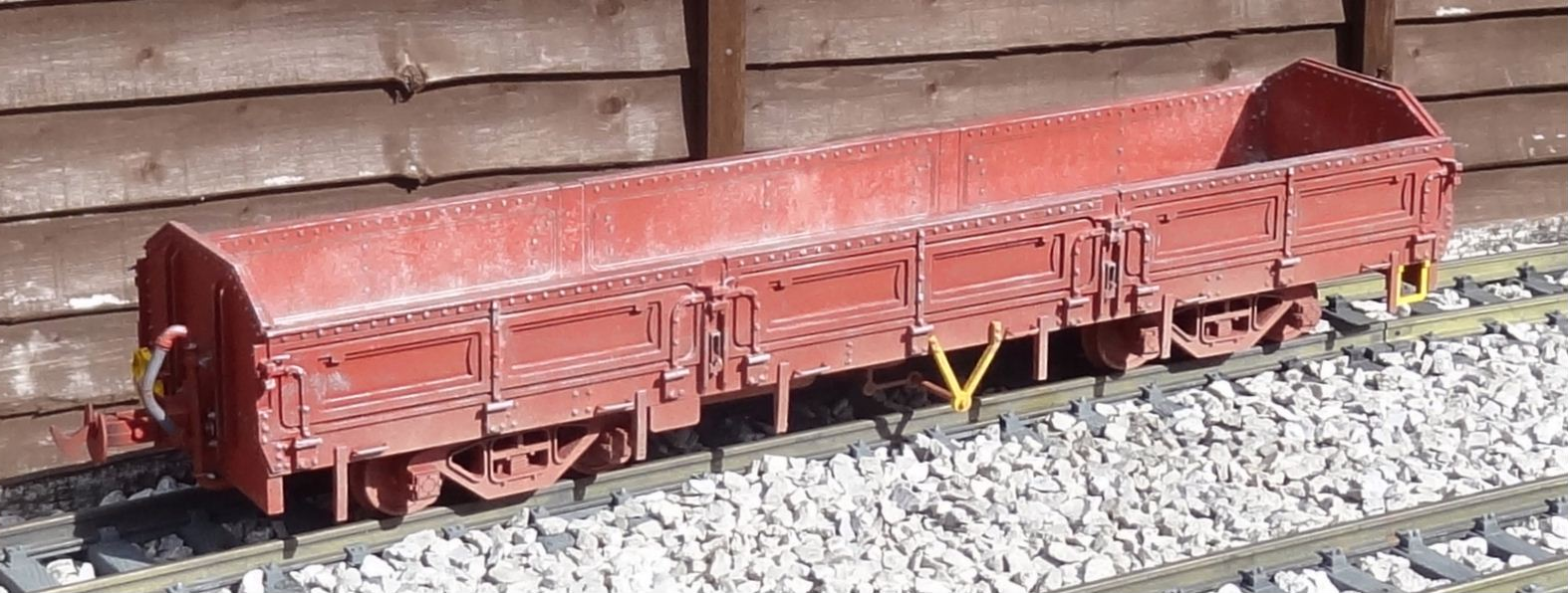

and even more on this...
