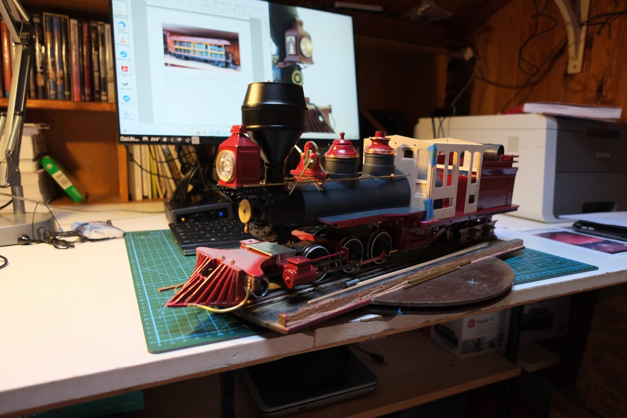

Hhello, this one was made from the same basic chassis (Bachman) on the other side of the chanel and with an american old timer inspiration.

An other conversion ....
with a bit more complication: it comes fro Bachmann 060 chassis sold for nothing without cow catcher and front wheel.
she needs still a bit of work.
Regards.
I like the look of that!
I’s it a Bachmann industrial 2-6-0 chassis?
I bought one at a very attractive price from Bachmann Parts last year and turned it into a Barclay (ish) 0-6-0ST
It’s good to see the diversity of models that can be produced
