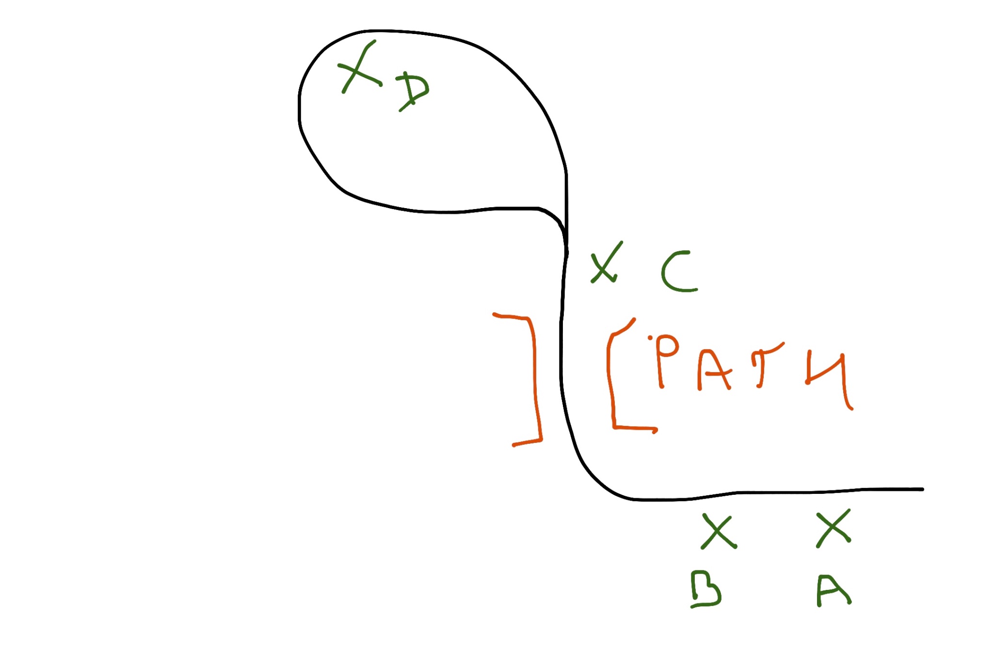

Ok as I see it there is the following logic:-
1 train sets signal to danger for pedestrians Sensor B sensor A inactive
2 Train having crossed the path sets signal clear for pedestrians Sensor C
3 Train sets signal to danger for pedestrians Sensor D sensor B and C inactive
4 Train having crossed the path sets signal clear for pedestrians Sensor A
5 Also as Train activates Sensor A this sets the system normal for the next train.
Notes
Sensors in Green X lettered
Sensor C could be moved into the loop to simplify things though this would assume trains going one route round wherever the choice of placing C within the loop.
Please feel free Experts to update this if there is any fault in my logic.
