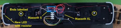

DCC UPGRADE
I did think about buying a 27 pin decoder to simplify the DCC upgrade but once I opened the loco I found the circuit board had been damaged by a previous owner (not the one I bought it from) and hard-wired for DC analogue with some very dodgy soldering. Also the plugs had been cut off the 4-wire motor block cables. I wasn't sure this circuit board would still work so I decided to go my default route of adding a Massoth XL decoder with a Massoth S decoder for sound.
So I made the decision to strip out all the wiring and start from scratch. I did wonder whether to keep the motor block 4-pin plugs which strangely had induction coils fitted, but after some discussion on another thread I decided to keep them. I started off by connecting the wires off the 4 pin motor block plugs together (track + and -, motor + and -) and then connecting track to motor so I could test in DC analogue mode. The inner pins of the 4-pin block go the the track, and the outer pins to the motor.
That all worked so next step was to add a Massoth XL decoder. I used the LGB/Massoth colouring code white/brown/yellow/green for the wires. Once that was tested in DCC and DC analogue the next step was to add the lights. I reused the wires from the blown LEDs with new domed white LEDs and soldered a 1K ohm resistor inline, and connected them to LI-V (front), LI-H (rear) and +22 (+ve common). Without the body shell on it is difficult to know which is the front so I labelled the chassis to avoid confusion. Always test newly installed decoders on programming track (service mode) before putting onto powered track, that way any wiring shorts will show up in programming mode before any damage can be done when you connect power.
With the motor and directional lights working, I added the Massoth S sound decoder and speaker. There is a Massoth sound project for the E10 so I updated the sound decoder before I installed it. I decided to use the SUSI cable connection option rather than connecting the sound decoder to track power. In general SUSI is the easiest installation option but there are some downsides, like there are many configuration options not available in SUSI mode, and it is hard if not impossible to read CV values off the sound decoder when connected this way. You can however write CV settings using "programming on main" mode with the SUSI 900-upwards range of CV addresses. I stuck the sound decoder to a piece of foam, plugged in the SUSI cable and the speaker cable, and proceeded to test. I attached the speaker to the roof of the body shell.
So that's it. Here is the completed loco running with a few coaches. I might have a go at detailing the cab and fitting a driver figure at some point, but for now time to play.
