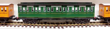

I was about to start a new thread but this seems like the appropriate place. [Paul or anyone else - if you'd like me to move this, just say so. Loved your conversions of the Emily coaches!]
I have an Emily and the Smallbrook conversion kit, plus 2 Thomas coaches and a green Emily coach. I, too, figured that 2 Emily coaches could make a 7-compartment Midland coach.
I also (as I expected) found that the Thomas coach looks much nicer on the 6-wheel underframe:
So today, as I am waiting for parts for my railtruck and as I only have a couple of weeks before heading back to my winter home, I took the 3 coaches down and started tearing them apart. That raised a few questions, which I'd like to pose here before I go any further.
First - the nose on the end of Annie and Clarabell. I flattened it with my belt sander, and I could make up a panelled end to fit on top, but I would end up having to paint the whole coach. If I cut the 2 Emily coaches down to make one long coach, I will have 2 ends left over. They'd be green, but could be repainted.
Looks like I answered my own question = paint will be called for anyway.
The trucks on the 7-compartment coach will be Bachmann J&S type, not Midland bogies, as I got them for $15/pair from Star Hobby (all gone now.) Anyone actually done this conversion?
I was also wondering if I could make the cuts so I have a spare door on an end which might make a brake double-door on one of the coaches.
Comments welcome before I cut too much more!

Hi Fred
First of love the Emily bogie :D I've messed around with Bachmanns a little due to the lack of coach kits in G3 but don't really have any finished examples i'm afraid! Having acquired a nice few I've not needed to recycle a face side as the beading ends with a 6 wheeler/bogie are sufficient when joining a pair and with 4-wheelers I only use the Emily ones.
Regarding the extra door notion I'd recommend a razor saw for cutting up the compartments (with something like an engineers square to keep the flimsy blade guided). A new blade is particularly ideal when you can't afford to waste any material such as with a Stroudley/Tenmille 3rd Class variant.
If you''re brave with a mini cutting disc you could also remove the moulded door and grab handles. My operations aren't perfect up close but with a bit of fine filing afterwards it's passable and hopefully won't be noticeable at all once replacements are added.
Can't help with the bogie bit as i've not crossed that Rubicon yet due to money and G64 options but as your appear to be on G45 track imagine there are some suitable mod examples out there.
Best of luck

I found another Emily coach at Star Hobby for $60, so the cutting began!
I actually cut with both hands holding it steady, but one was holding the camera. The line stays straight due to the fence and the sliding right-angle stop.
One trick is to do a tiny test cut, preferably where it won't show. The blue tape is to help with the measuring and alignment.
After cutting off both ends from one and just one end of the other coach, and carefully measuring and cutting the underframe, more blue tape on the joints and some wooden blocks on the shelf track, and we have a mockup:
That small bit of blue tape is holding the door handle while the glue sets - I decided to make a Brake End so it has a double door. As I was cutting the underframe to size, it could be anything I wanted. The body is actually 23.5", or about 47 real feet. Here's a close-up of the guards end. You can probably see that a little cleanup and a coat of paint and you won't see the joint.
Here's the underframe after gluing some styrene to keep it the right size, and a piece of aluminum rail to make it stronger. I'm thinking of drilling and inserting screws from the other side into the alum'n.
Finally, here's the leftovers - a rather small coach, don't you think?
I am planning to slit the ends off and reuse them on my Annie & Clarabell, though that will force a repaint.

Interesting technique with the tape Fred and the double door joint is rather effective :) I know the above images are mock ups but to avoid a potential jump in body height my advise would be to glue two L lengths across the underneath of the floor joints (either one pair of super lengths or two smaller pairs if you find that easier) and a strip or two around the windows. By gluing the spans to one shell unit first you'll then have a base for the second and third shell pieces to sit on and say 2-part epoxy will give you a bit of tweaking time as it sets.
Well you're definitely giving Timpdon a run for their money :D

Today was quiet so I worked on the frame and body. I glued the old windows where I plan to paint over as blank panels, and I added some grey to remind me they are blank.
The body ends are screwed to the frame with the original screws to hold things in place, and I did screw through the chassis into the metal reinforcing rail.
As Steve suggested, the joints have some "L" section styrene reinforcement, but I'm relying mostly on the frame/chassis to hold everything in situ. Can't do much else until the glue dries, although I did take the overhang off the ends of the roof pieces. And I emailed Smallbrook about the duckets and battery boxes.
