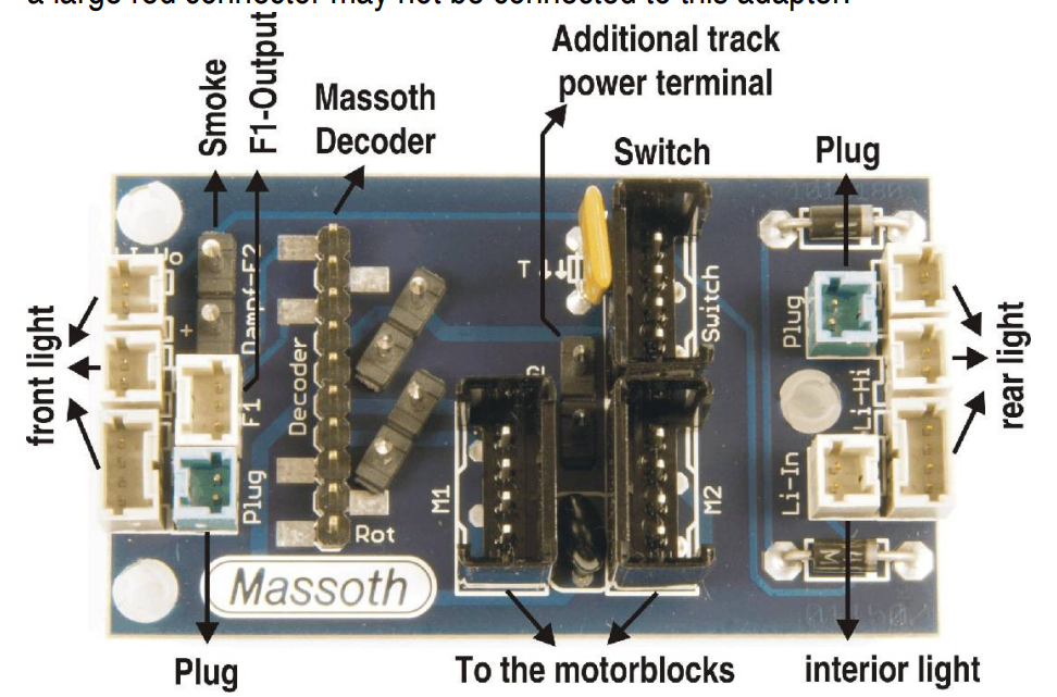

So I recently bought a Massoth XLS decoder and a DCC Onboard Adapter,
I know a lot of people told me not to go down this route and either hard wire or go with ESU brand and such.
But I feel more comfortable with with this set up, (least I can mostly convert the loco back to it's original board if I mess up.)
Anyway the XLS decoder saids the smoke is set to button 7 which is linked to Output F1
But the DCC Onboard Adapter says smoke is F2.
I'm guessing I need to change which Function output is linked to button 7 somehow?
If I read the "The Dummies Guide. - Cv's - Massoth" correctly.
I need to change CV 56 value to 7?
But I thought I'd better confirm it with someone before I go about messing with CVs I'm not familiar with.
Another question.
Does anyone know what the 2 light blueish pin ports called "Plug" are for?
The Massoth guide doesn't really give any information on their function.
Are they what you link the LGB's multiports for coach lighting and such?
