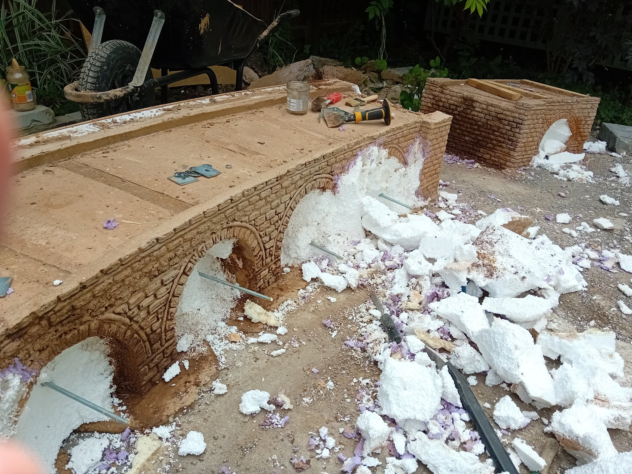

Its definitely just a section where the concrete wasnt mixed properly, as I peel off the front its a lot tougher and no crumbling sections. I got someone to help me with the pour for the second section and he told me to let the dry ingredients mix for a bit before adding water. I was just bunging everything in at once and letting it mix, so its likely the short section I poured alone has lumps that arent properly mixed in.
Because I used a very fine 6mm gravel (the same one I use for ballast) the ratios were:
1-and-a-half bucket cement
2 bucket 6mm gravel
2 bucket sharp sand
2 cups 'buff' and 1 cup 'brown' cement dye powder (this produces a light brown sandstone-y shade)
The front - much nicer see:
Not quite sure why you were putting in gravel?
Mixing should have been done all in one go but another way I have used is to have a central removable section so that you create the outside to be seen faces, then add a mix with gravel in the centre with possibly a few bits of rod to give strength then pull out the separating bits andcomplete the top surface mix. This the central bit could have gravel.
A mix of 1 part cement to 3 parts sharpe or even building sand including your colour option will give you nice clean detail, in the middle a mix of 1 cement 3 parts sharpe sand and possibly 2 parts gravel works nicely.

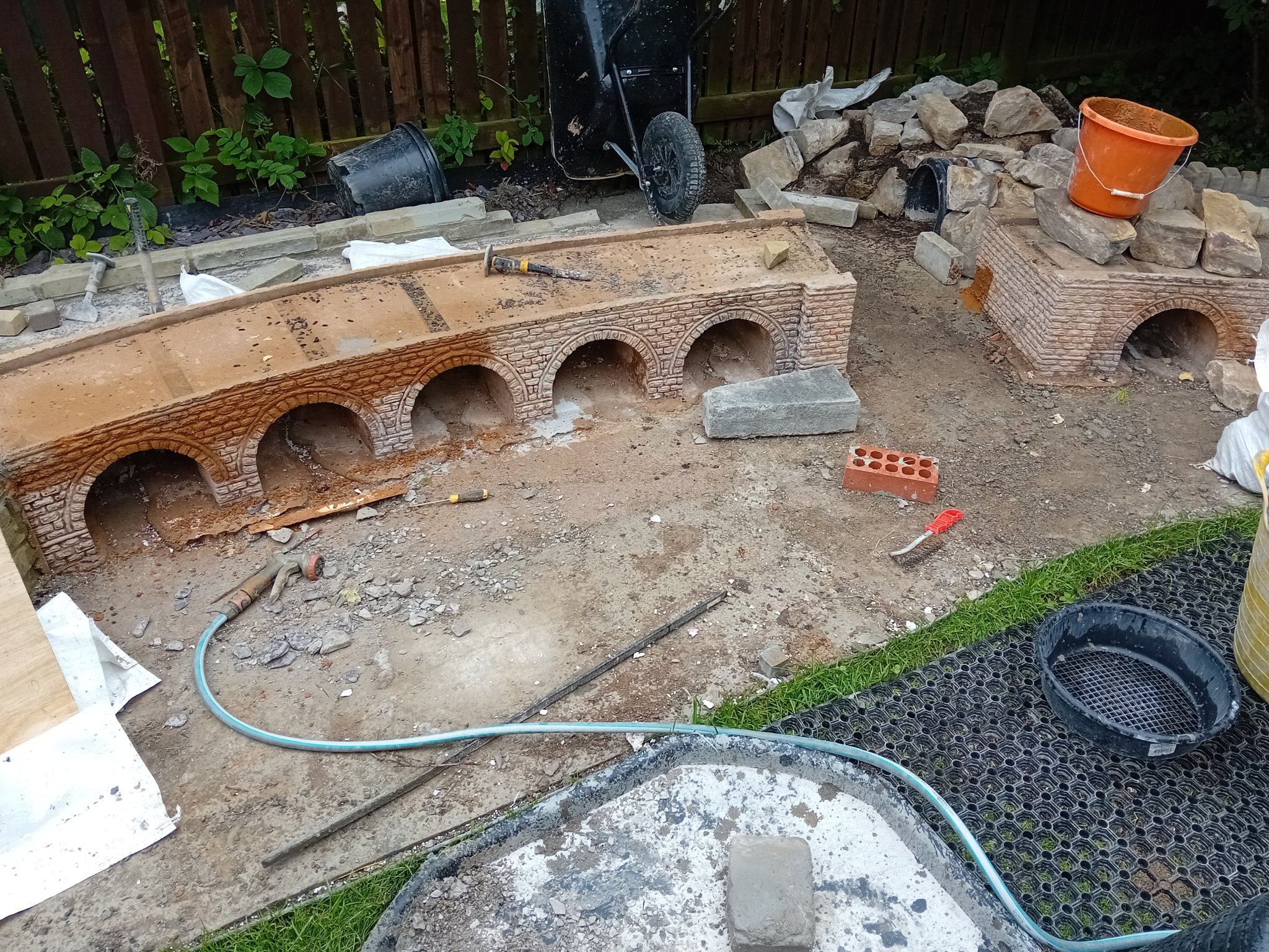

This is all too late to help me but hopefully it will help others. I'm going to try this method of mould making again(because it's quick and looks nice) *but* paint the entire mould inner with a few mm of urethane rubber. To cast tunnel mouths and a platform if it works. Than well know if the viaduct could have been done that way too.
Current state of chipping at the mould:

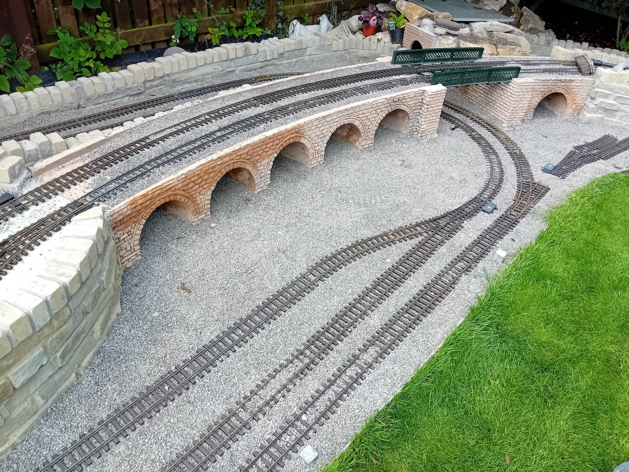

Ive been busy on with the enormous task of adding coping to the top of the >50m of stone walling that makes up my layout, and had wanted to show this off when fully complete, but it'll be another few weeks till my MVL bridge arrives to complete it, plus the rockery/tunnel project (to fill the shadiest corner of the garden that only weeds would grow in otherwise) that you can see behind the viaduct will be another week or so, having ran out of big bits of free sandstone for now - plenty on Marketplace for me to go grab when I get a free evening though.
So here we are now - Ive done a little patch repair on the one bit of missing detail on the long section (dont worry, its identical ratio mix, so will dry light brown). Im thinking I may well 'grout' it with a darker shade to really make the pattern stand out, but I need to research 'external grouts' that would work on this, theres probably some sort of 'pool grout' type product out there in a very dark grey I can test on a hidden section. Theres some dark sections on it to be wire-brushed up, this is where the most stubborn bits of styrene had to be burned out with a weed-burner!
What may work is black concrete dye, just slap a loose mix on then quickly wipe it off with some old foam leaving residue in the mortar lines. Just try a small area at the back first!
