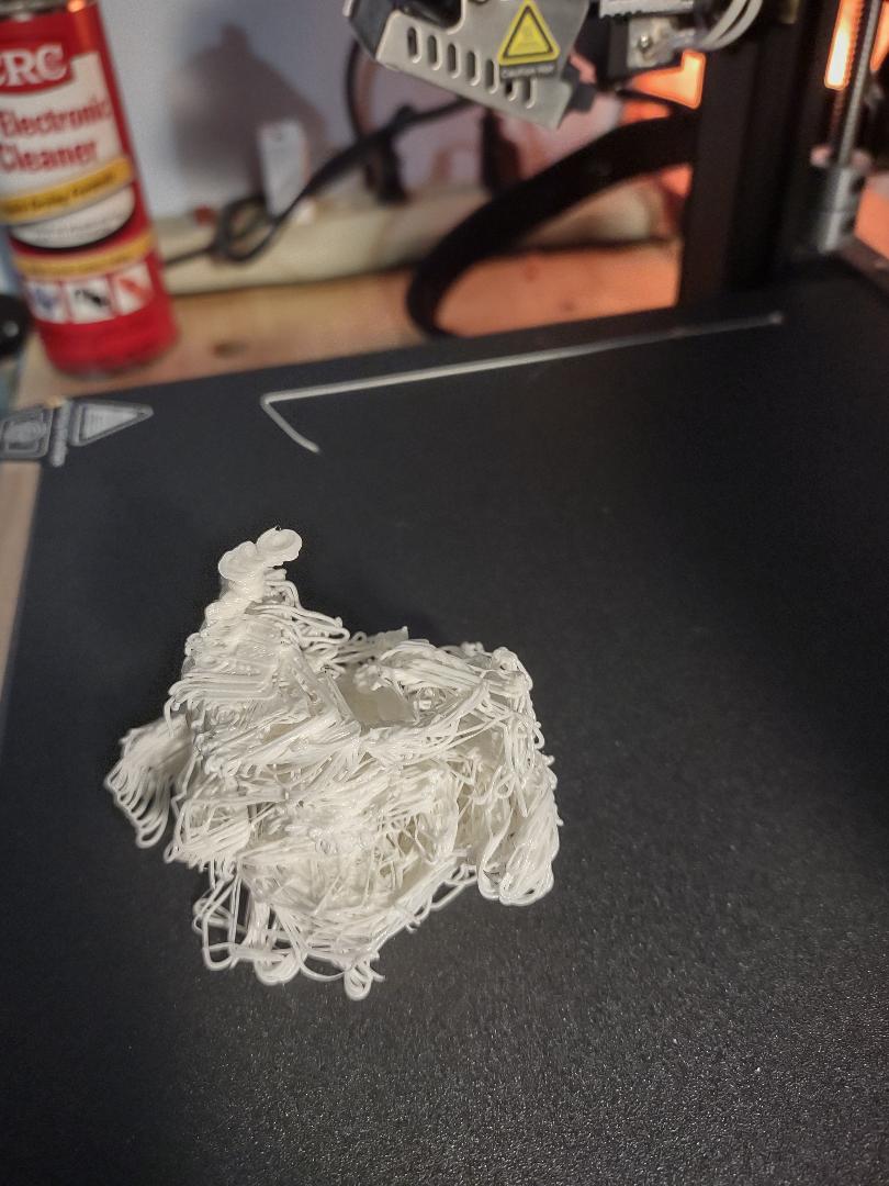

Those look like slicer errors. Check for number of top layers - should be 3. Also check retraction settings and maybe increase a little.Success! Sort of. At least it printed.
My foolishness of course. My z offset was set to 3.32, not -3.32 as required.....
Now to fiddle withe the settings to get the horizontal surfaces to work.
