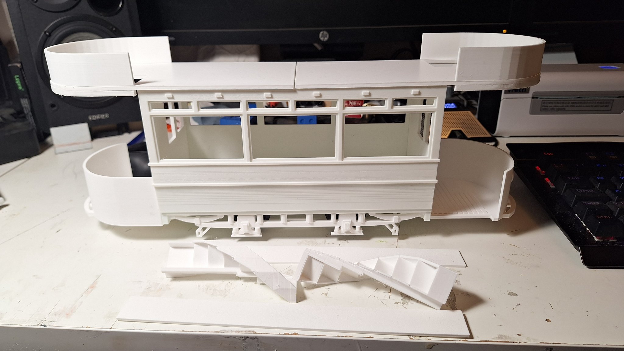

A very nice chap called Derek was kind enough to send me some files for a 7mm tram.
I've scaled them up to G Scale, added more detail and some additional parts such as seating, collector post, steps etc and I must say, they make for a very nice model.
Derek has said I'm welcome to share the files and print parts for anyone else, so please let me know if you're interested. Not everything is shown below, but it gives you a good sense of what's available.

Can you add some comments on how you printed the seperate parts so that they do not give problems of overhanging etc. ?
I usually print the long sides flat on the workplane and if necessary i divide hooked parts with large standing up parts in separate parts flat on the workplane.

Yes, all printed in Filament. Only the stairs need any support and everything else prints flat or vertically. Designed for a Bambu Labs A1 with a 256mm x 256mm bed.

First prototype completed. I need to glue it together and check the motor is gear low enough. Currently at about 6:1, which feels a bit tall. It might need a multi-stage gearbox to give better slow running and more torque.

The smaller wheels are Peter Binnie, with a 3D printed spacer. It adds weight to the axle and reduces any wobble on the 3mm axle.
Everything runs in ball bearings, so should be very smooth running.

Progress has been slow, as other priorities, but things are coming together.
Top deck is almost there, motor and speed controller are tested, so it's final assembly and detailing to go.
There are a few parts I need to re-draw, as the stepping around the curve is pretty terrible.
After a friend showed me the progress he's made with his model - made from the same set of prints I've made this from, I've pulled my finger out and got this a bit more presentable.
Now motorised and a bit more detail added. I'll take it for a spin and add some video.
