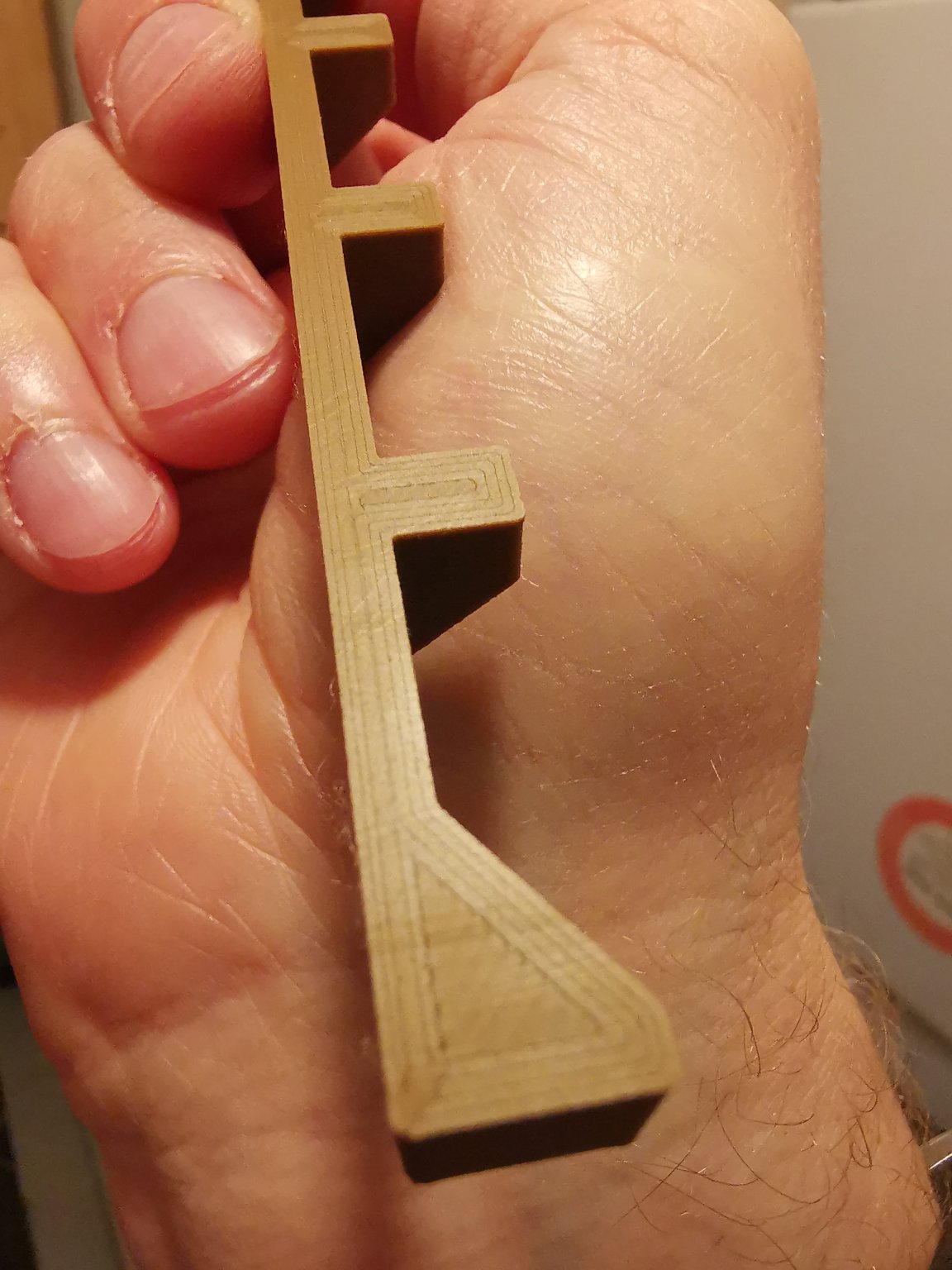

Prints turned out fantastic using the AMOLEN 30% walnut PLA.
Zero complaints and pleasantly surprised how easy it was with almost no modifications of settings.
I had one failure on my first print as I forgot to lower the stock print speed of 80mm/s which my ender 5plus usually runs at. Recommended is 40-60mm/s.
It's also important to note this is with a brand new 0.4mm nozzle. Meaning the nozzle wasn't worn which bores out the hole increasing the diameter. I've seen other wood filaments which recommended a minimum 0.5mm nozzle which is a hassle. No need for that here!
Successful settings were:
210C
120% flow (but I use this for all my filaments as my ender 5 plus has a tendancy to under extrude - you may not need this.)
50mm/s print speed
60C heated bed
This filament even did a better job on the internal supports than I usually get. Regardless of filament my supports are often under extruded even if the outer walls are great.
Not this time though! :party:
I bought this one after seeing Amazon reviews that said it printed just like regular PLA. Can happily confirm and highly recommend. :clap:

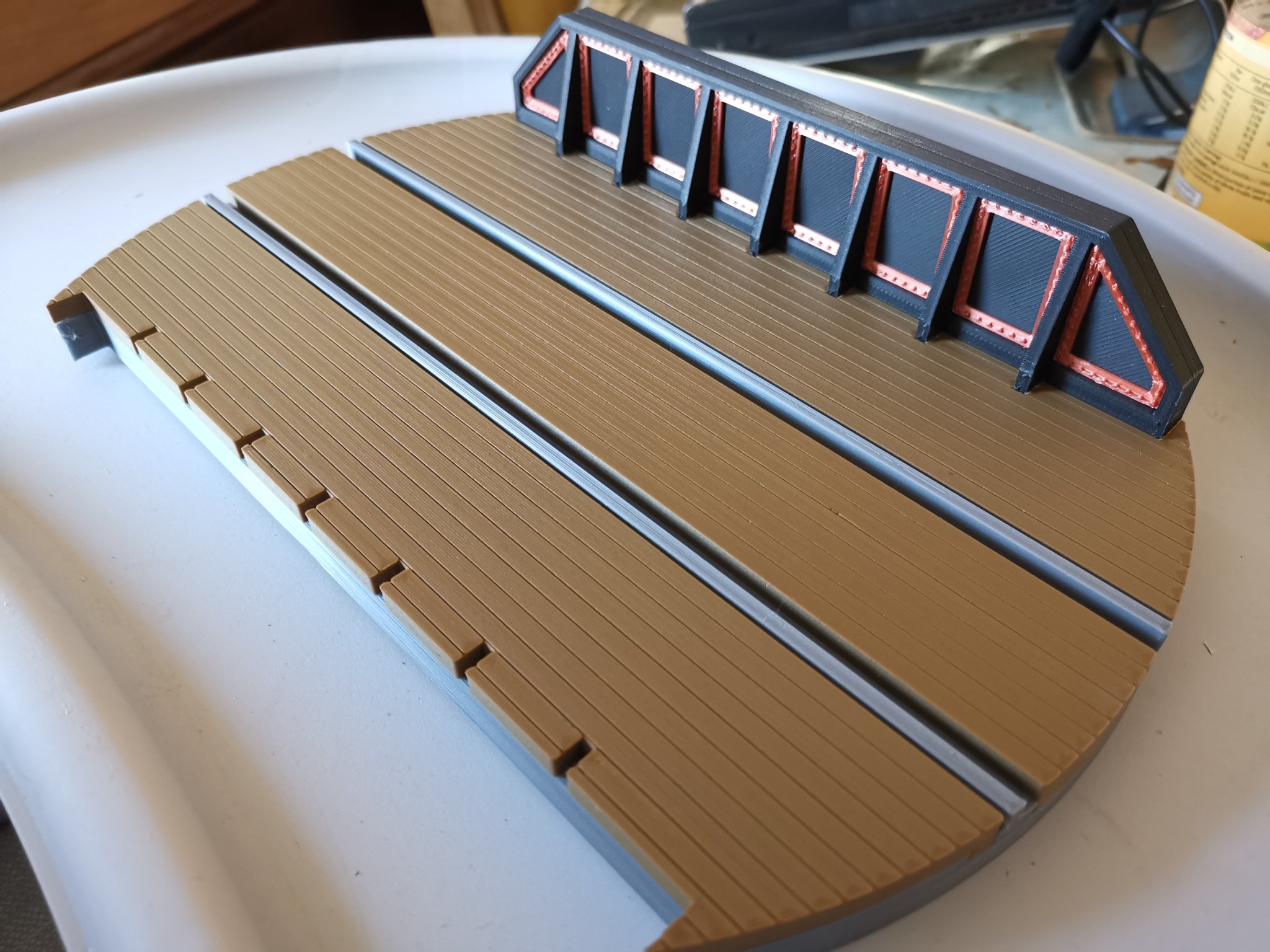

Now that it's loaded and is even printing better than my usual polyterra filaments I'm looking for the next project. I think maybe an agricultural style multi track crossing so the boys can get their tractor to the farm in the middle of my layout :cool:

Looks to be a brilliant result. - Very impressive.
I need a Project like this, like a hole in the head, but some of the results I am seeing, are very tempting..

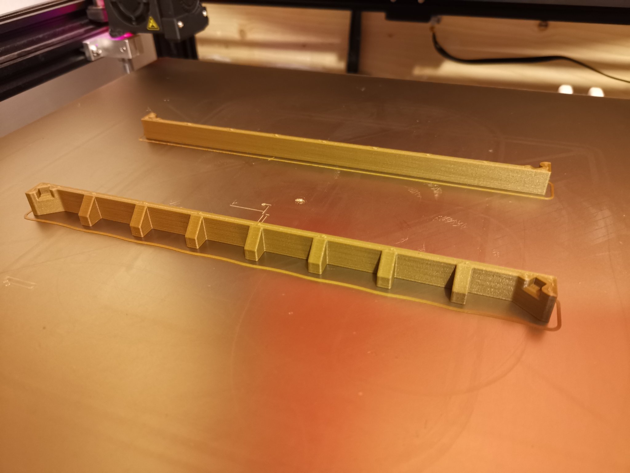

The joist ends are done. Just realised this is also a great test piece for warping. No issues with bed adhesion. Printed one after the other so the furthest one has sat on the printbed for 4hrs without warping or releasing.

I call that pretty much textbook bed adhesion.
