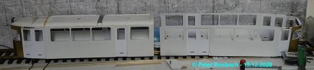

The lockdown, which in Germany led to some of the schools being closed again, gave me a two-hour work until the holidays. So I have a lot of time to do handicrafts, but less money. But I think that was the government's right decision.
This means that the construction of the six-axle tram is going much faster than expected.
Today I was able to finish the roof of the A-part. The resistors and the pantograph are still missing.

Today my friend and I worked on the Hagen tram and the Wuppertal trailer 429. The Hagener got 3/4 of his second roof. The trailer 429 received spring packages.
