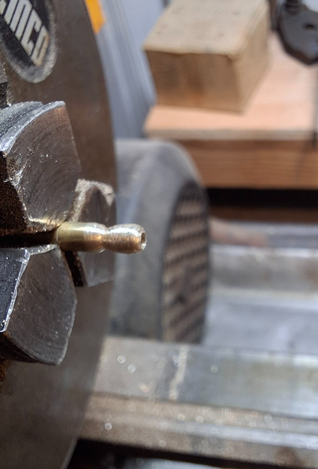

So, the new trick is making a swan-necked brake handle: the book suggests turning up a piece of brass and then cunningly bending it to shape. So a piece of brass was mounted in the lathe chuck and turned to suit:
It was then tickled up with needle files to get the correct profile.

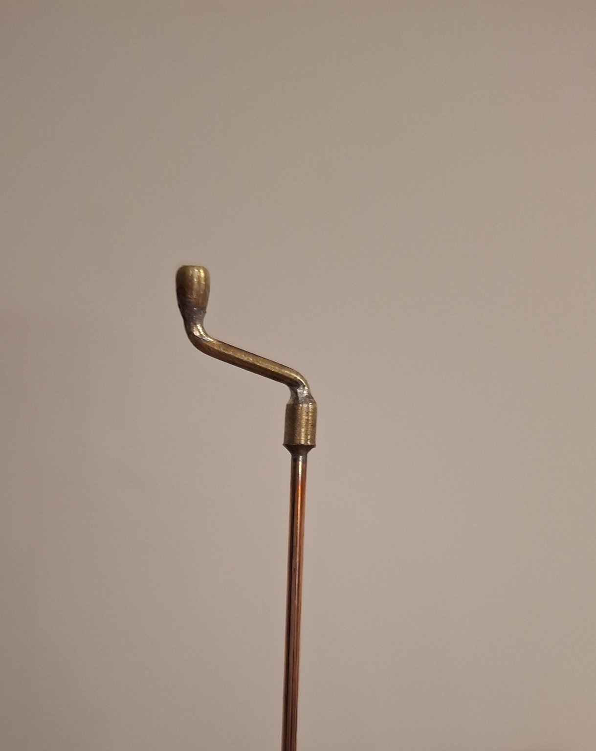

Anyhoo, all three parts were made up, a welding rod shaft added, and soldered up:

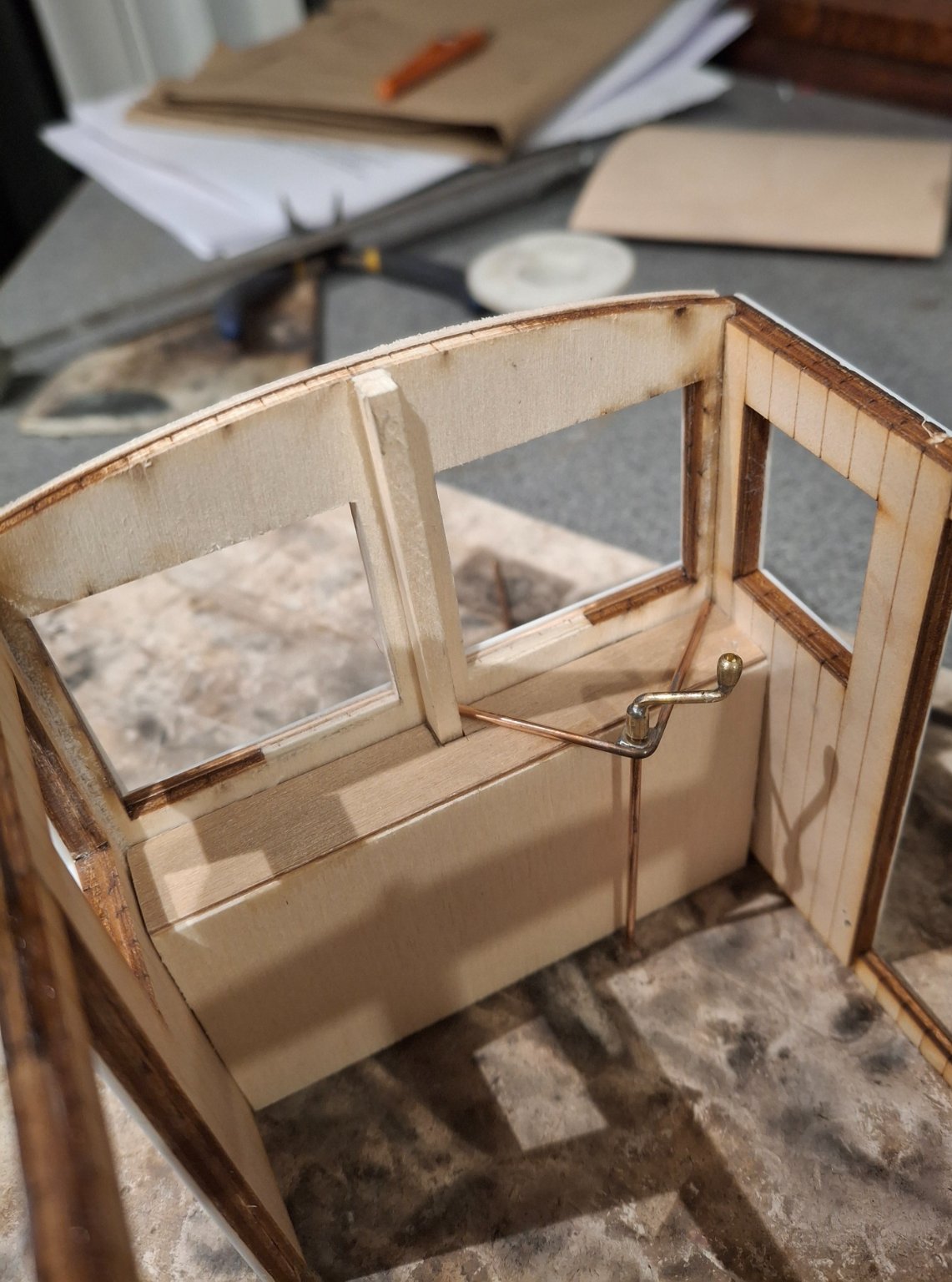

before a support was created from thinned-down welding rod and a brass bush:
I'm quite happy with that. Next up, the General Electric 11a controller...

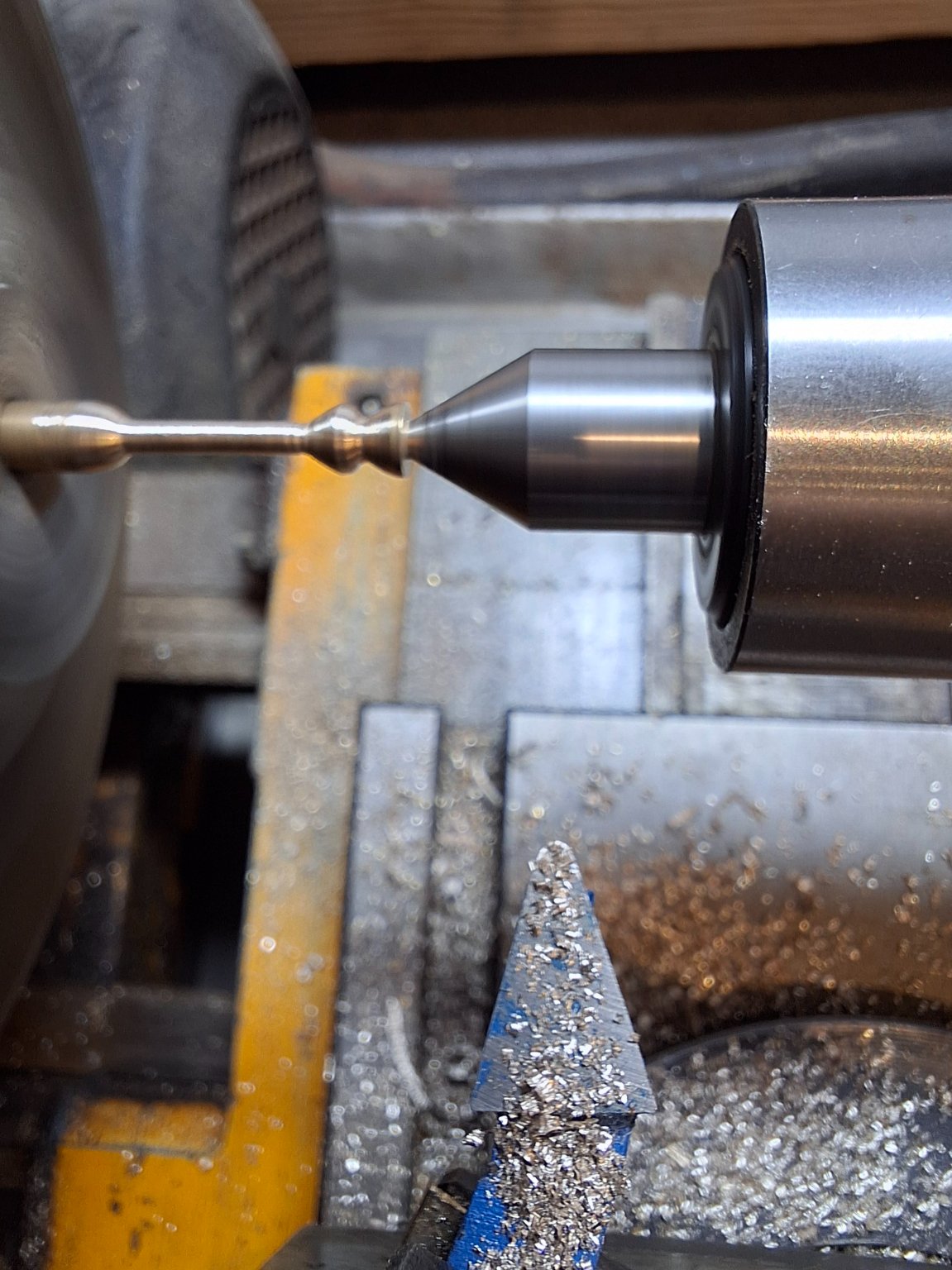

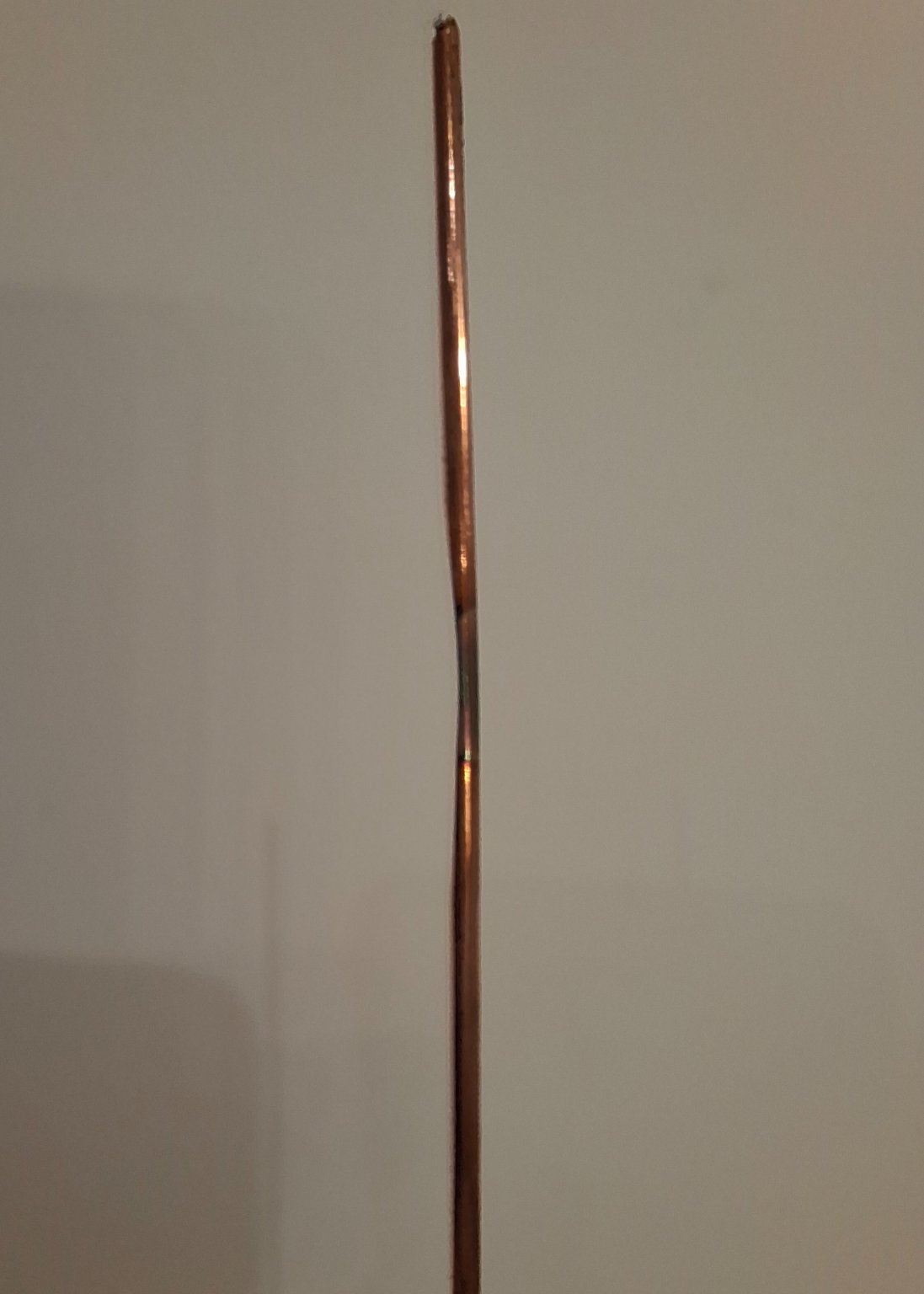

Now, depending on its make-up, brass can be 'hot short' i.e. brittle when hot, or 'cold short'. I had to guess which, and opted for it being cold short, so applied heat, bent it, and...it was hot short.
So the new plan was to solder up a handle, swan-neck and boss...

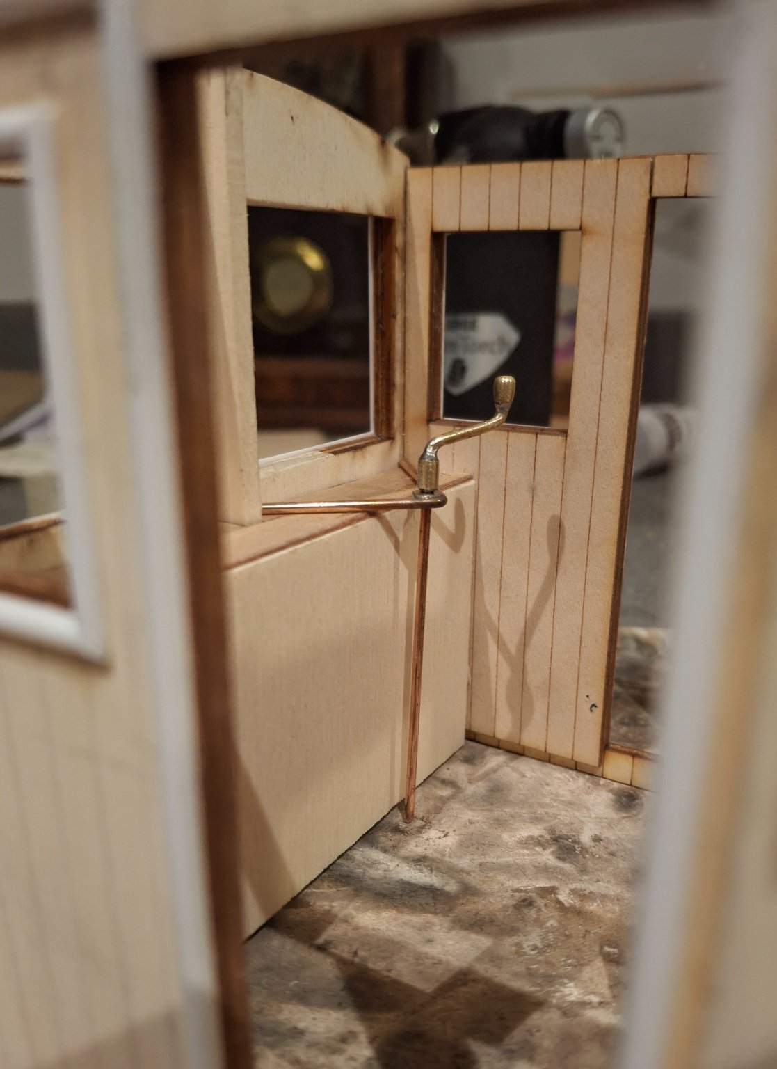

This is the handle, the bit the motorman holds; the original stock is 3mm, so it's quite small, really!
View attachment 351120View attachment 351124View attachment 351125

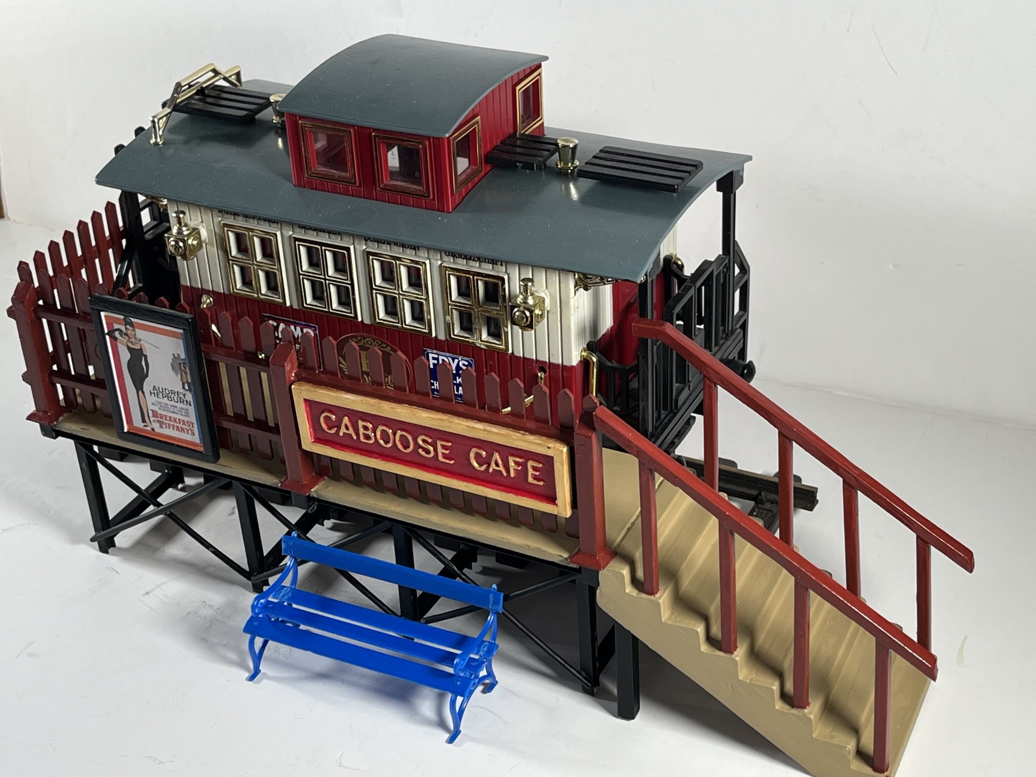

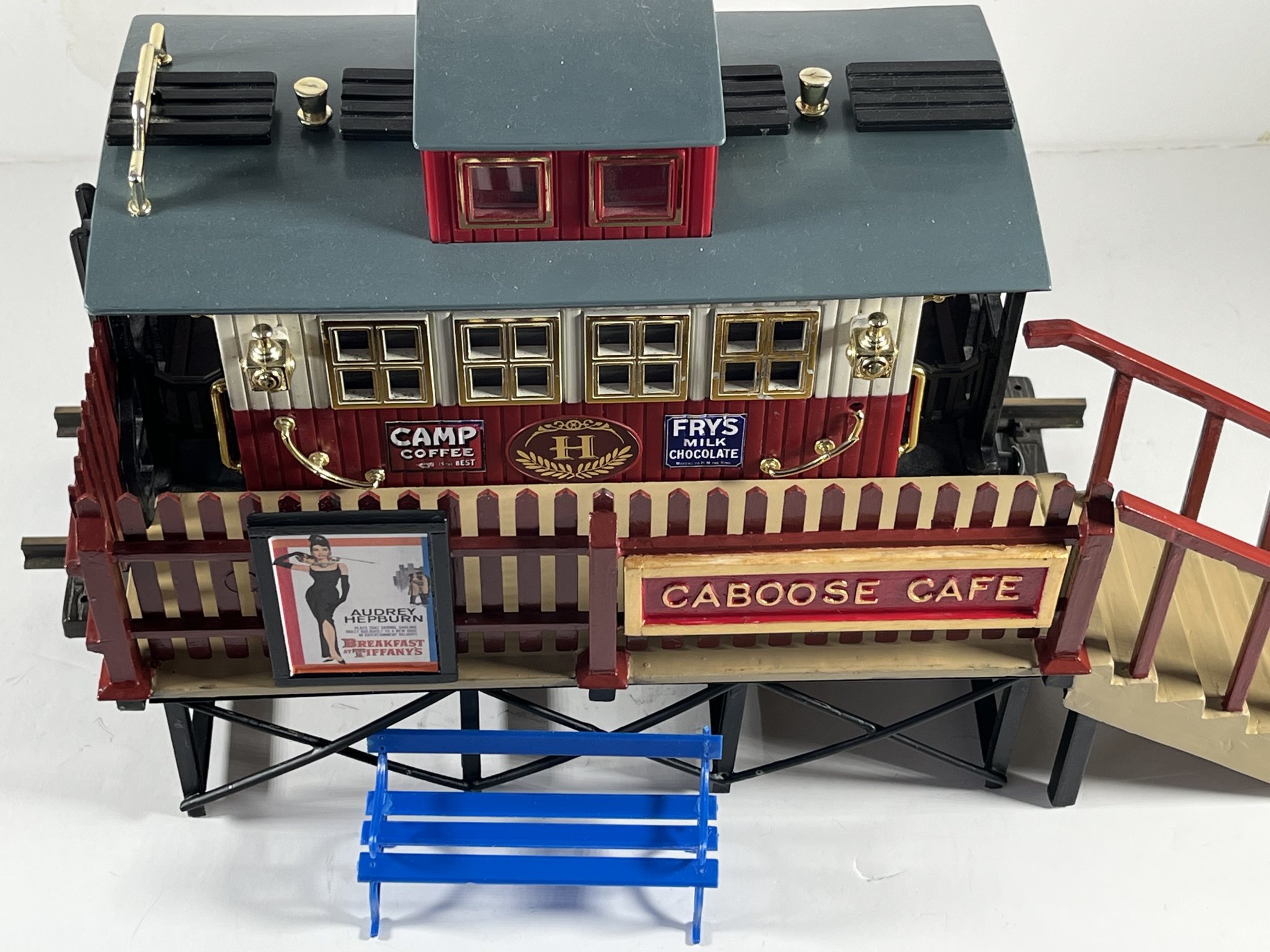

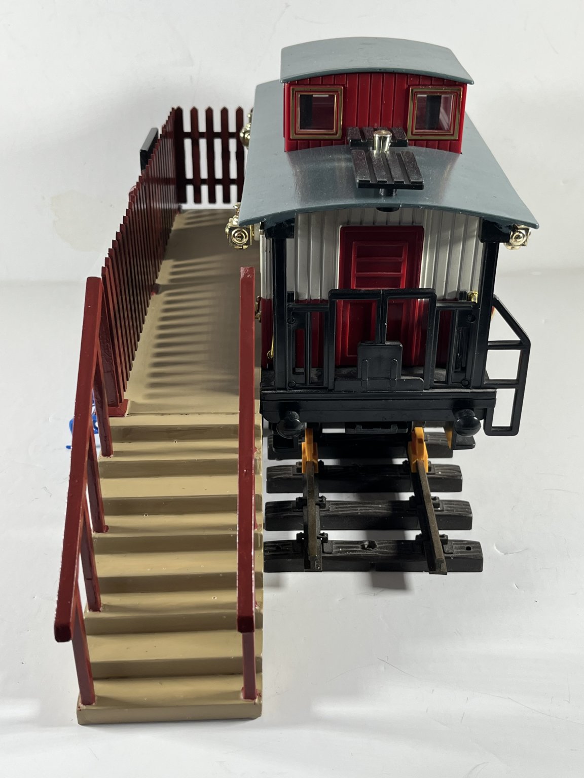

Well this has been on my workbench for months. An old caboose, partly wrecked from a well known auction site, repaired, couplings removed and tidied up. Then a platform and steps built from plasticard, plastistrut, and other preformed plastic extrusions.
And we have Caboose Cafe:
