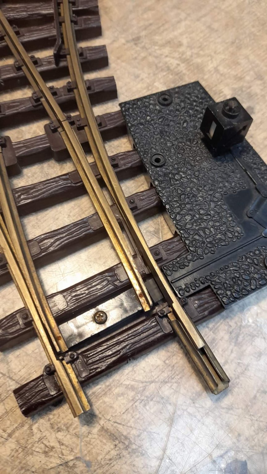

Dear G scale enthusiast!
Do you have any idea of the manufacter of this switch driver? Because it is missing some parts as you can see, and I'd like to know what is missing.
Thank you for your answers in advance! FB_IMG_1674059875360.jpg FB_IMG_1674059872426.jpg w

I have a feeling that these are LGB! But very very early, and not made for long, before the design changed to a rectangular block with a push-pull lever for manual operation.
And also 3 terminal solenoid electric operation

Aha.....a picture.....'borrowed' fron the web...unfortunately not a large file size..so a rather small image. Hopefully someone has a better image...or even one of the original points. In 20+ years, I've only seen 1 or 2.
As to whether it's possible to find out what was inside the mechanism...or even get the parts....!!

if i remember right, to me it looks like the manual turnouts, LGB made in 1968 and parts of 1969. (then seen them in shopwindows, but never afterwards.
since there were two newer generations of turnouts, before LGB was swallowed by Märklin, i doubt, that Märklin-LGB would have spareparts for these.

A little bit of hacking and bodgeling ought to be able to get newer LGB items to fit. Holes may need to be cut into the end of sleepers, screw holes drilled for them to be screwed in and a hole drilled in the moving tie to attach the moving part of the switch. Once done the way would be clear for electric LGB motors, though another sleeper end would need to be cut out as the EPL motors have different distances fitting requirements to the hand operated levers.

As noted above, it's a VERY early LGB product, from the grey box era.

Spare parts are not an issue because we might be able to reproduce it somehow, and thank you for the help, if anybody has a switch like that, I would be courius about what's inside

I have that turnout and manual control and it still works. Next manual/generation version had a tab on the end to change directions and this unit also came in an electric version that had manual and A/C control via 3 wires plus the manual tab.
