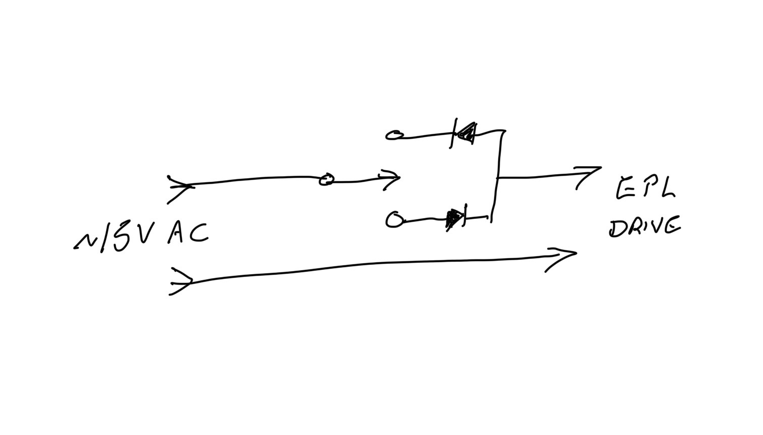

My understanding is half wave (!!!) 18 volts, especially with the LGB controller, but I use 18 volts DC but you need either a double pole double throw centre off none latching switch.
what works for me: (if you got the switchmotor, like in software tools' pic)
the rails get the regulated 0 - 18 (or 24) DC (!) (red and blue)
the AC (minimum12 V, max 20V) goes with one cable (the white) direct to the switchmotor.
the other AC cable (black) goes to a switch-box/reed-contact/bell-button.
(you need either a three way switch, or two momentum switches in parallel)
behind the switch(es) there must be two diodes. (one forward, one backwards connected) (if you got the right box, the diodes are included inside)
behind the diodes you bring both together with the SAME cable (orange) to the switch-motor.
(if your switchmotor looks like the one in dunnyrail's pick, go with two separate cables (yellow and green) to the switchmotor. (that switchmotor would work as well with DC through bell-buttons))
the colours mentioned are following the LGB description.

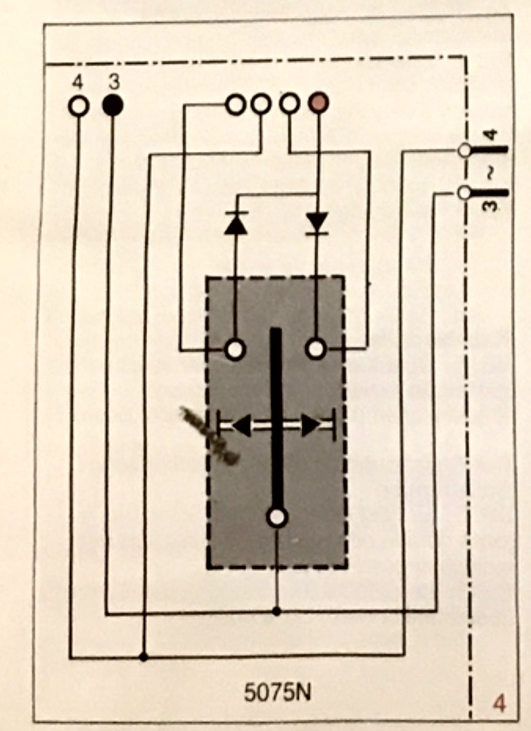

An AC supply is fed to the LGB box, which rectifies it to half wave DC.
AFAIK, the correct LGB box is the orange one. 5075 or 50750 is the part number.
The yellow one LGB 51800 is used for isolation of track and uses simple On/Off switches.
Like Software Tools, I reckon Paul may have the 51800 box.
The switches on the Orange box will be a centre Off, with momentary On either side of the centre position....

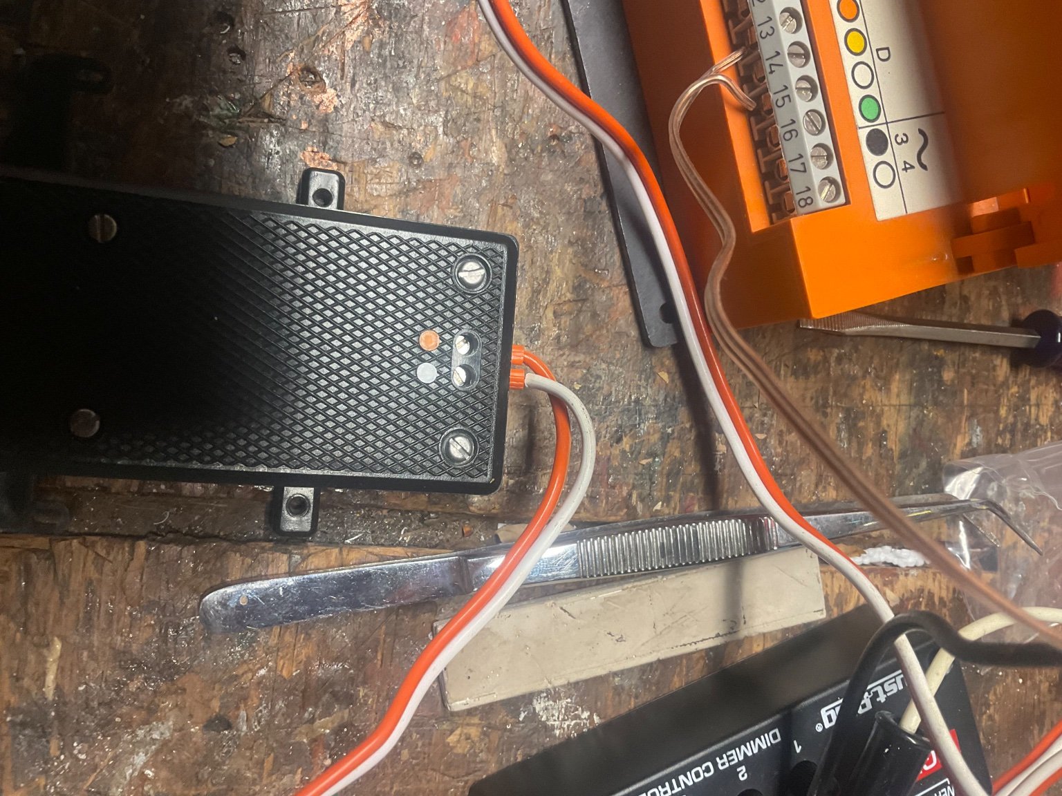

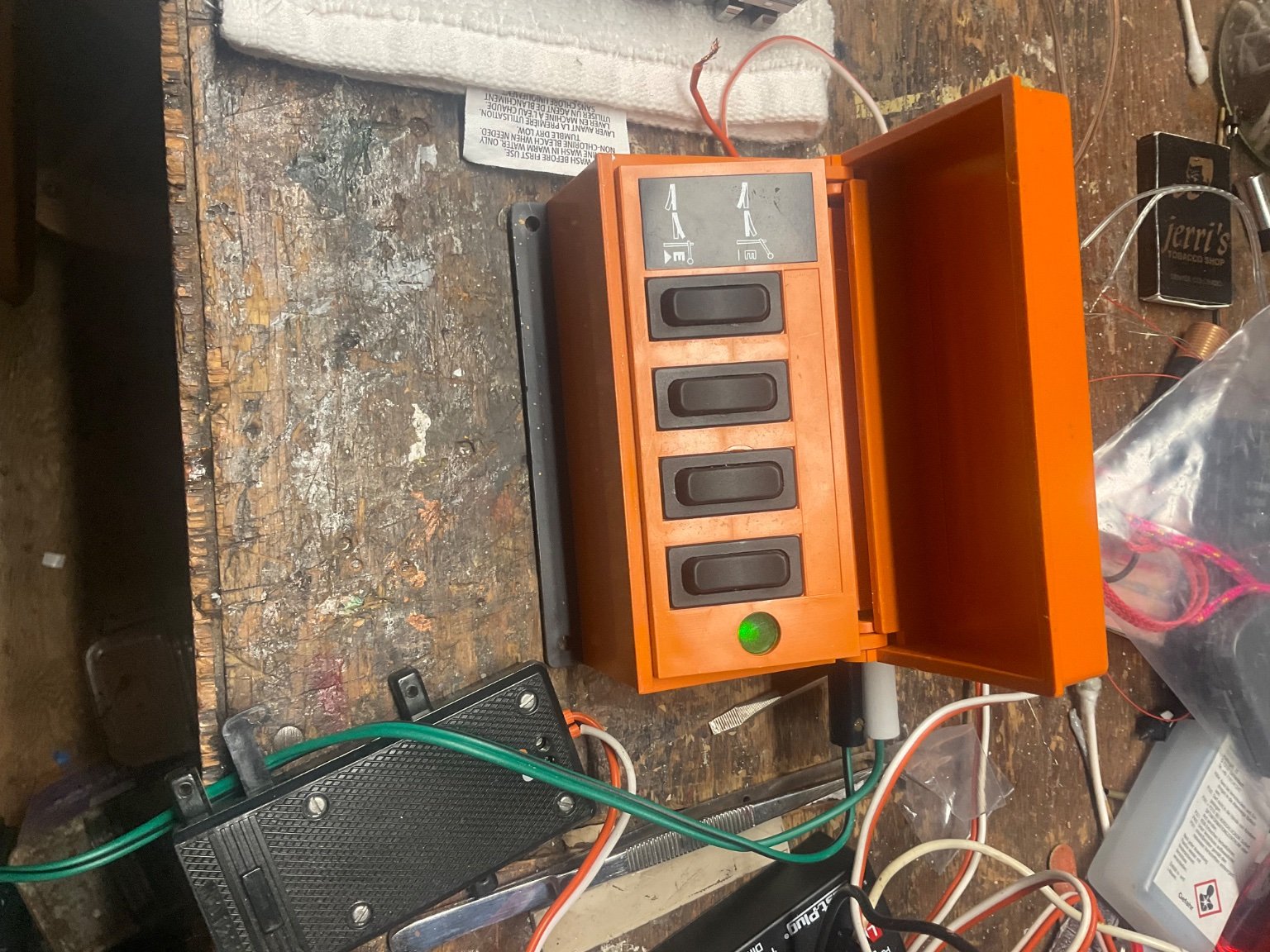

Hi: Thanks for all the replies. To answer the questions:
-I believe these are EPL drives. They are marked 1201/10 on the bottom. 2 inputs, one marked white and one marked orange.
-Switch box is orange, marked 5075 on the bottom.
-I have two transformers available. One is 110-240V in, 18V 1A DC out. The other is 12V 2A DC out.
I plan to have 8 switches on the layout. I have 3 of these orange boxes, which appear to connect together to transfer power from box to box.
