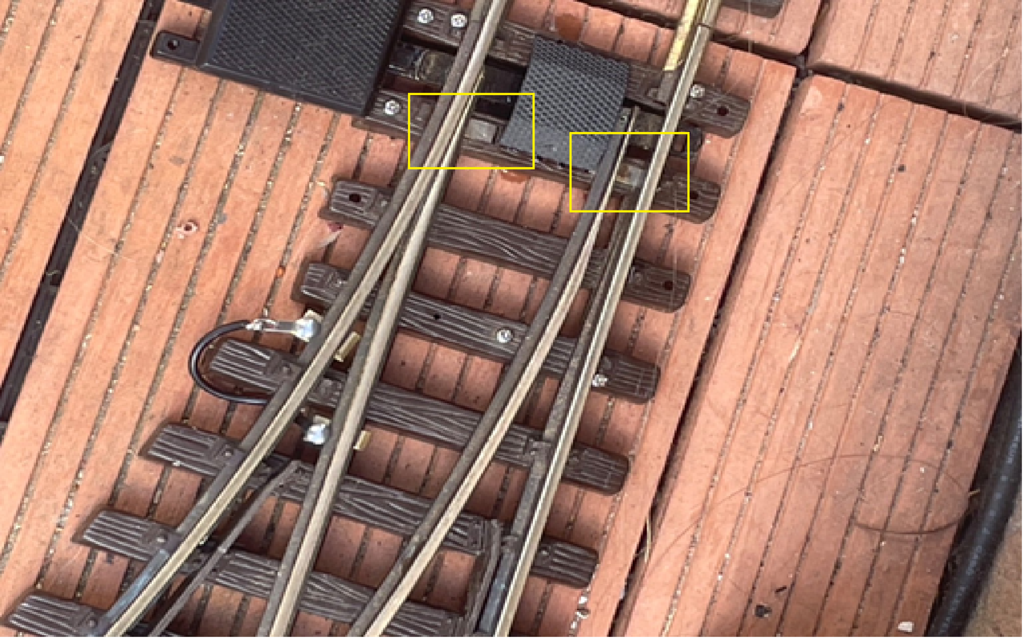

If I have still this running problem I will install a power buffer. The funny thing is that it’s mostly on the same one or 2 turnouts. I bought them second hand but never had a problem with DC. The locomotive drives fine one that turnout which is new.
Problem with the points could be the jumpers that provide power across to the rails the other side of the frog and the moving rails. LGB had 2 ways of doing this, one with pressed flat plate stamped in place the other older version had screws. My plan is always to replace these with jumper wires across to where needed. Bit of a pain but it does make all the difference. As LGB points are not isolating this is a relatively easy job, but you do need a big lumpy soldering iron at least 70watts. Even then solder to the rail webb makes life easier.

If you are having problems with the point blades you may need to make sure that you clean the contact points for the wipers (the one on the right looks particularly dirty) as well as the underside of the point blade. these can be cleaned with a mix of emery paper and contact cleaner.
If you do jumpers on each side the cleanliness of the wipers is irrelevant the reason why I do wire jumpers both sides with black wire also after the frog.

What size are the turnouts that you are having trouble with?
I have almost entirely 16000 and 18000 switches and I fit all short wheelbase locos with power buffers on their decoders. Some switches just dont work the same and will stall when others dont. Power buffers on the decoders always shorts out that problem.

I have 1 lh and 1 rh radius 1 switch which gives me trouble. I have generally sorted it by replaced the skates and brushes but here and there it's still flickering and resetting but it's a bit better now. I'm running on a 22V PIKO power supply. I also bought a new Seuthe smoke unit which is suitable for up to 22v unlike the previous one which was rated 18v.

I understand. Need to see how it goes. I have new brushes and skates installed which improved it a bit. I also ordered a small power buffer
