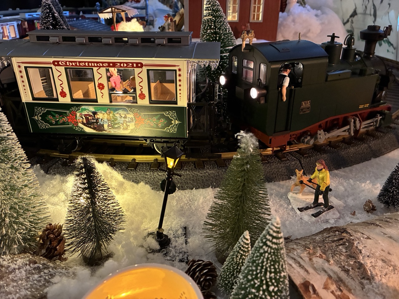

I have one locomotive, the Saxon, 1K, Alexander Thiemer, and its pulse smoke operates reliably.
