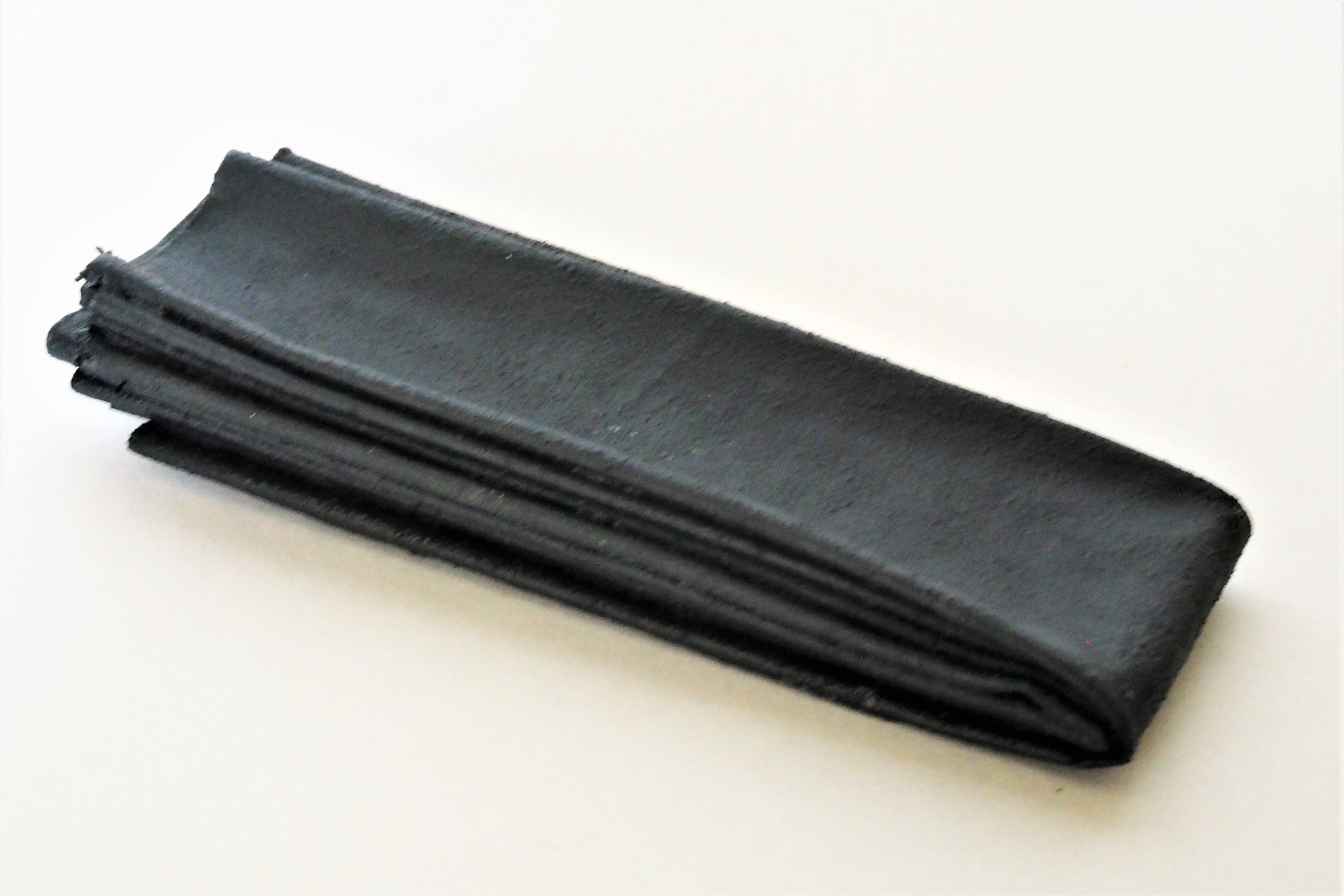

For this conversion, as can be seen in the `yellow` photograph, the saw cuts need to be very precise. The floor and sides are now extended by the insertion of plasticard which is then scribed to match the planking and woodgrain. An extra lenghth of upright strapping is required because of the extended length. This was a piece plasticard channel. You will note that on the original the vertical strapping alternates between channel and plain. I add thin strips of plasticard strip to the sides of the plain strapping to create a uniform appearance. The handrail holes in the balcony end are filled in. The tarpaulin rail brackets and lamp irons are GRS items. The rail is a length of bent wire coat hanger. The tie down cleats for the tarpaulin, are squares of plasticard with brass wire inserted. The axle guards are bent and filed brass strip.
