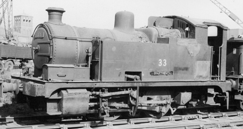

Having as a young trainspotter seen the last Y4 at Stratford the choice was straightforward

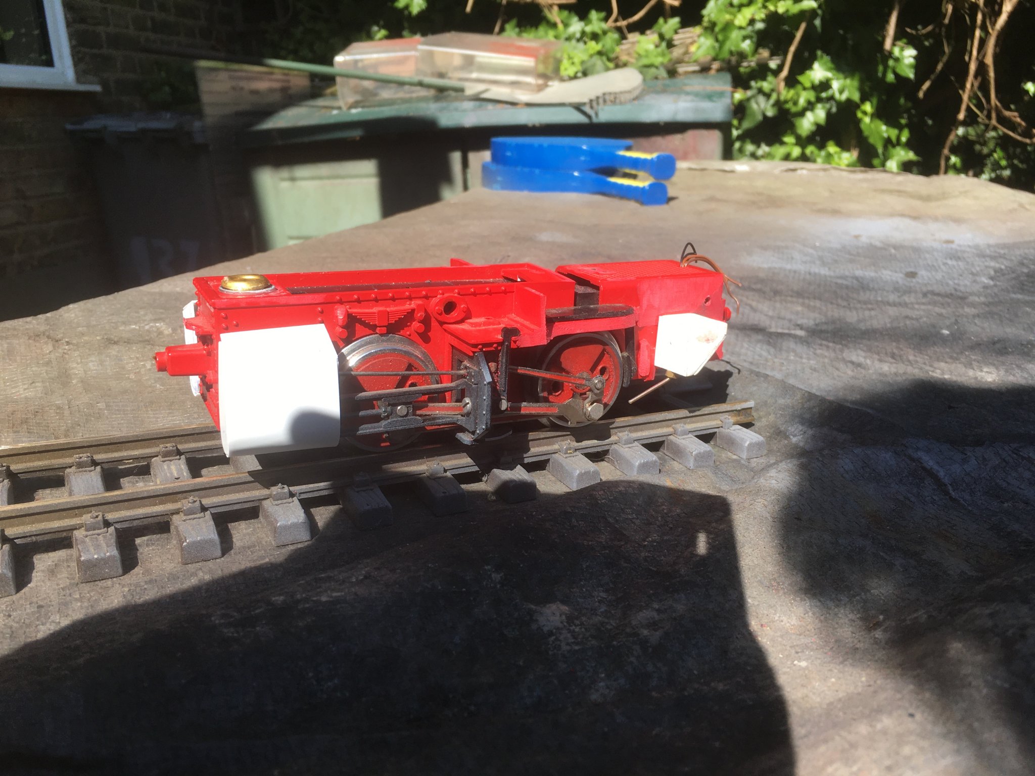

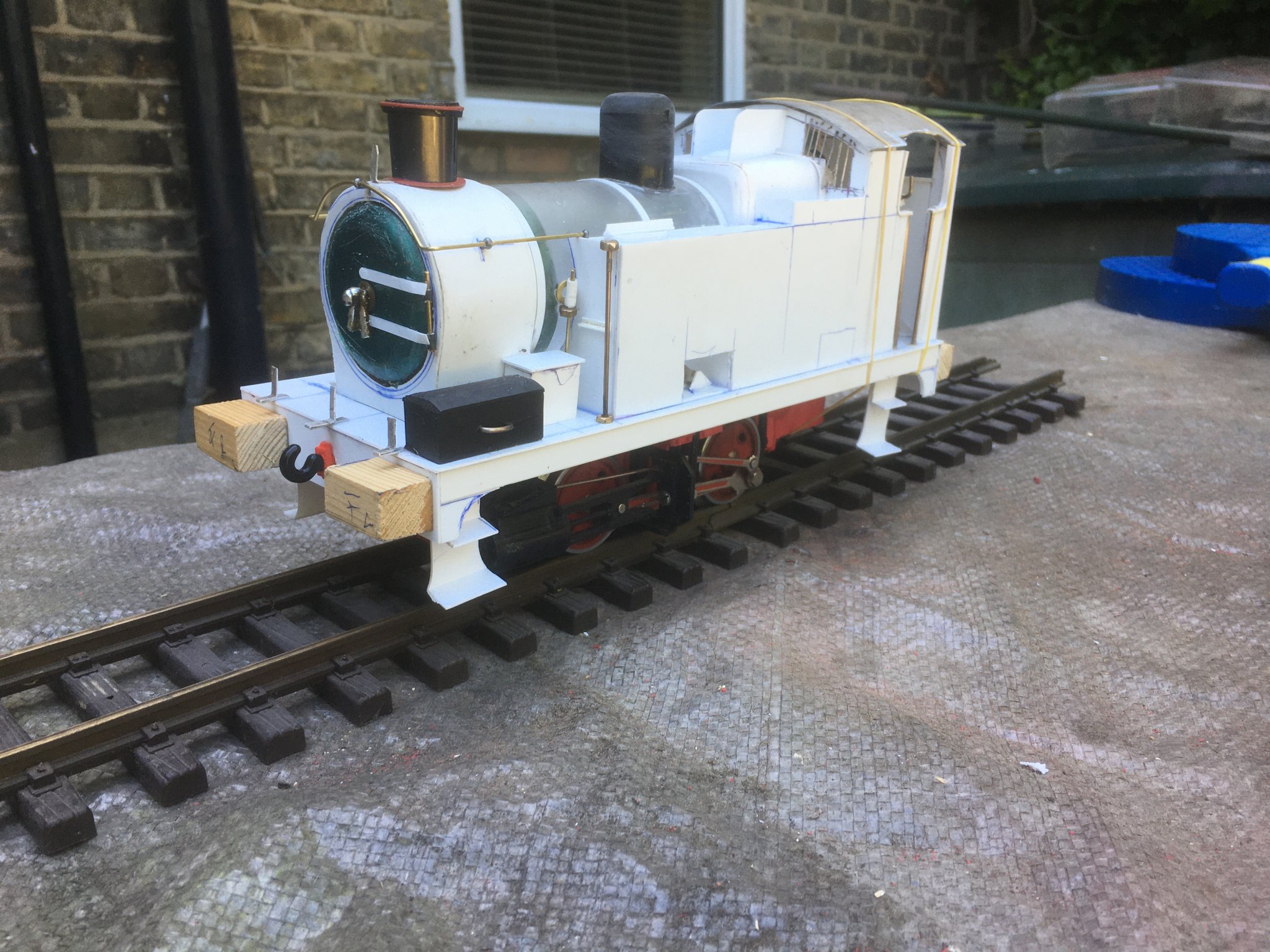

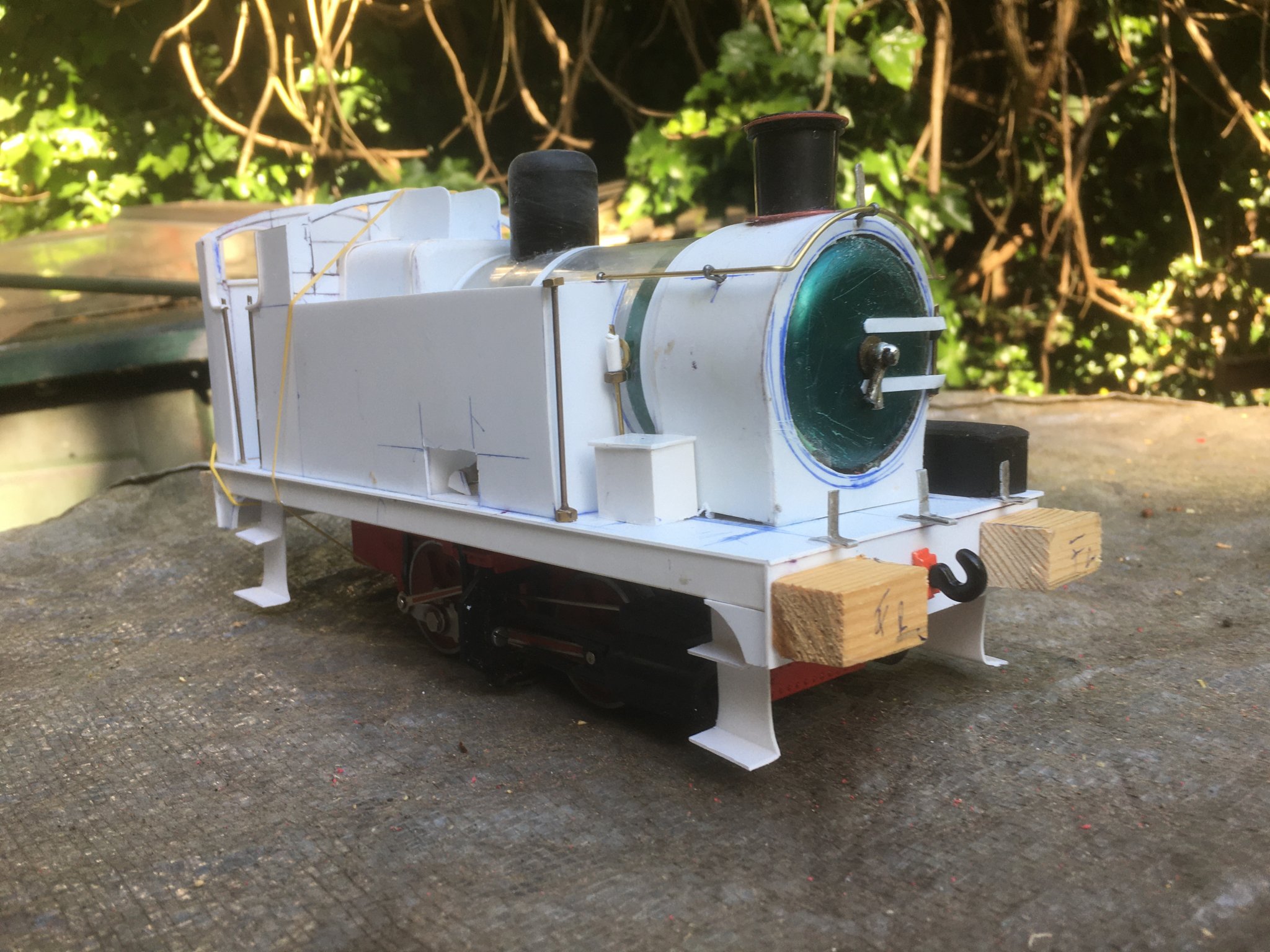

So the body was removed and the red plastic of the chassis set about with a power file
The cylinders were jacketed to better reflect those of the prototype and sand boxes added

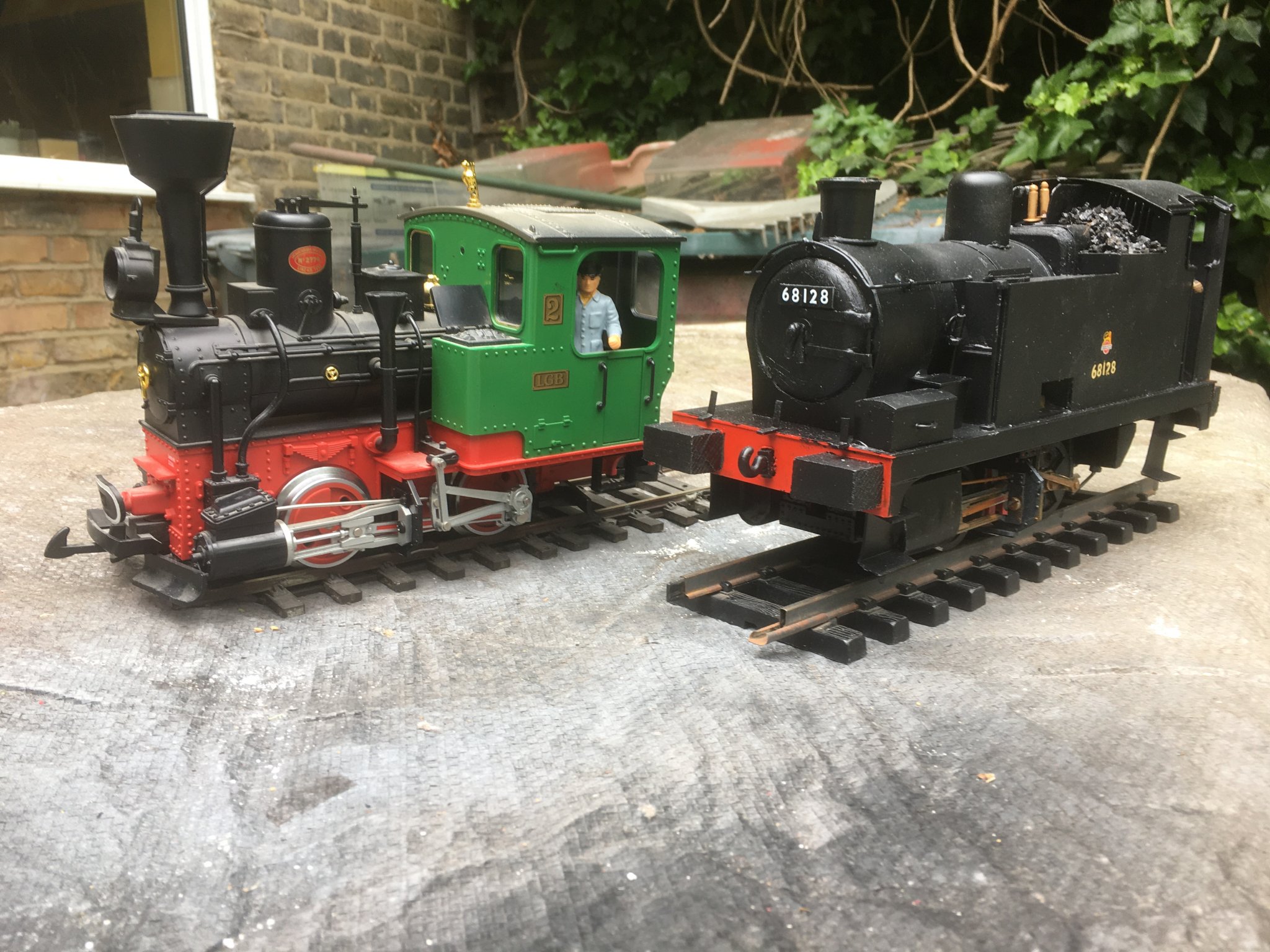

The body was a relatively straight forward build in plasticard with a waste pipe boiler; spray can cap smokebox door; a lotion cap dome and 22mm copper pipe with rim added for its chimney
Anyway there’s now one less Stainz in the world now and an unusual Shunter/Coffee Pot as it’s successor !
