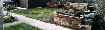

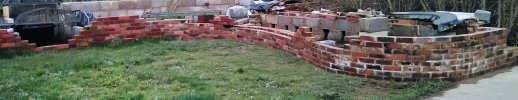

Above you can see where 2 lines exit the Shed and the one in the foreground cannot now be seen from this viewpoint. Note that when the base was put down a space was allowed for a walkway behind the Railway. The wall is a crib from a long time 16mm guy by using broken concrete reclaimed when recycled bricks are cleaned off (by me), Mike did this work and it is glued with No Nails or Gripfill works just as well. I recommend a backfill with Concrete just to finish the job off as those glues cannot be relied on to have a ling life through frost, beasts from the east etc when used in the Garden.

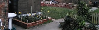

Another shot in a different location showing how Mike has supported the old Shed Panels, they were originally supported at each end but a central pier was deemed necessary after walking on them found them to be a little flexible. They will be walked on extensively to create Mountains in front of the Path at the rear of the Blue Juice Wagon. The front area here will be a modest representation of Boston Lodge as Mike has interest in FR as well as RHB. Shed at the right is RHB, another down the Garden to the left with be Portmadog.
