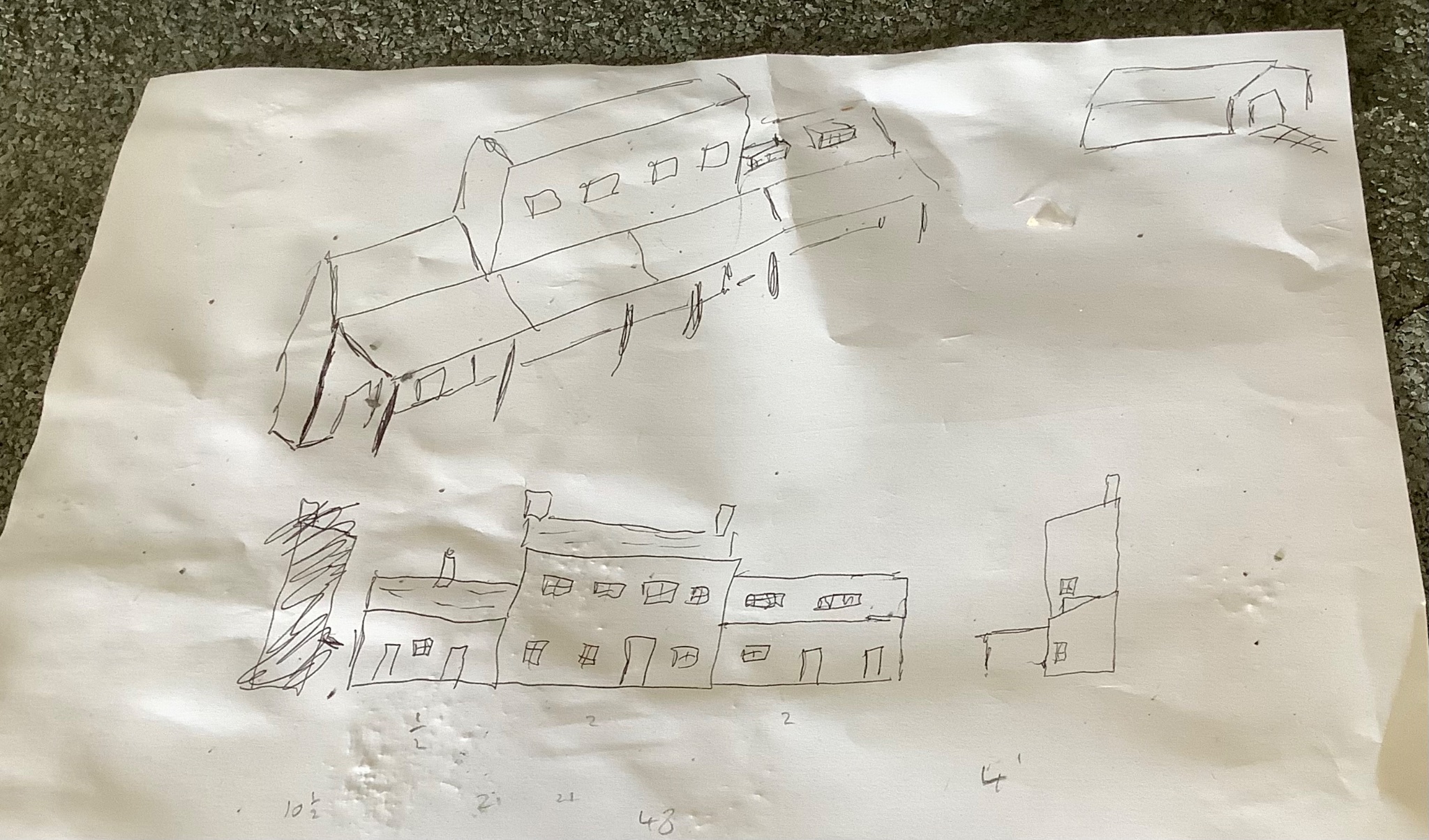

Then my rough of how I intended to do it.

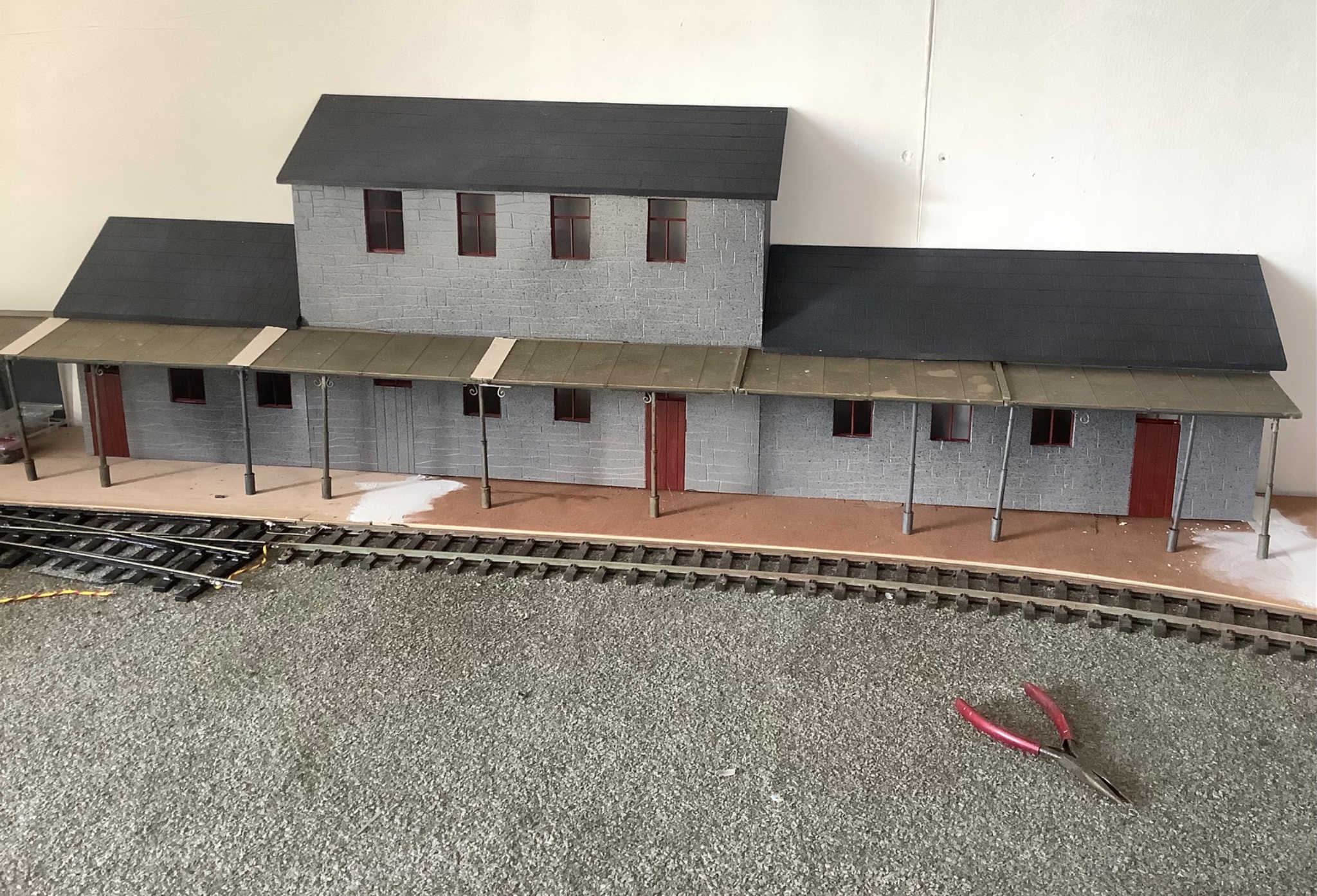

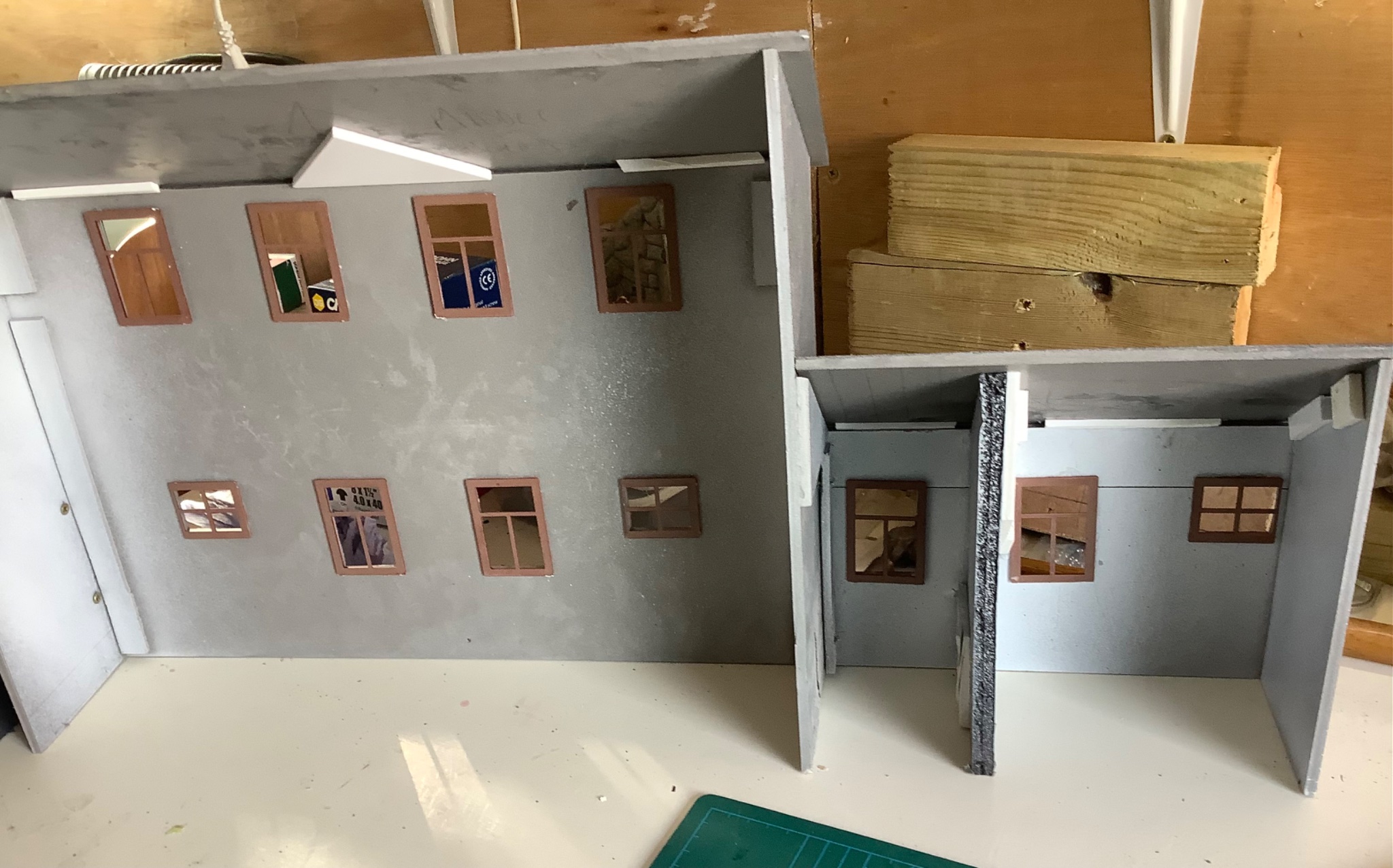

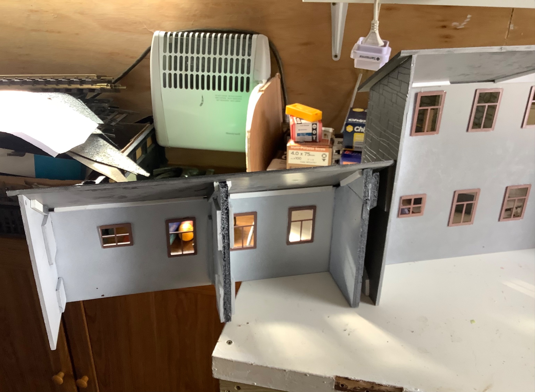

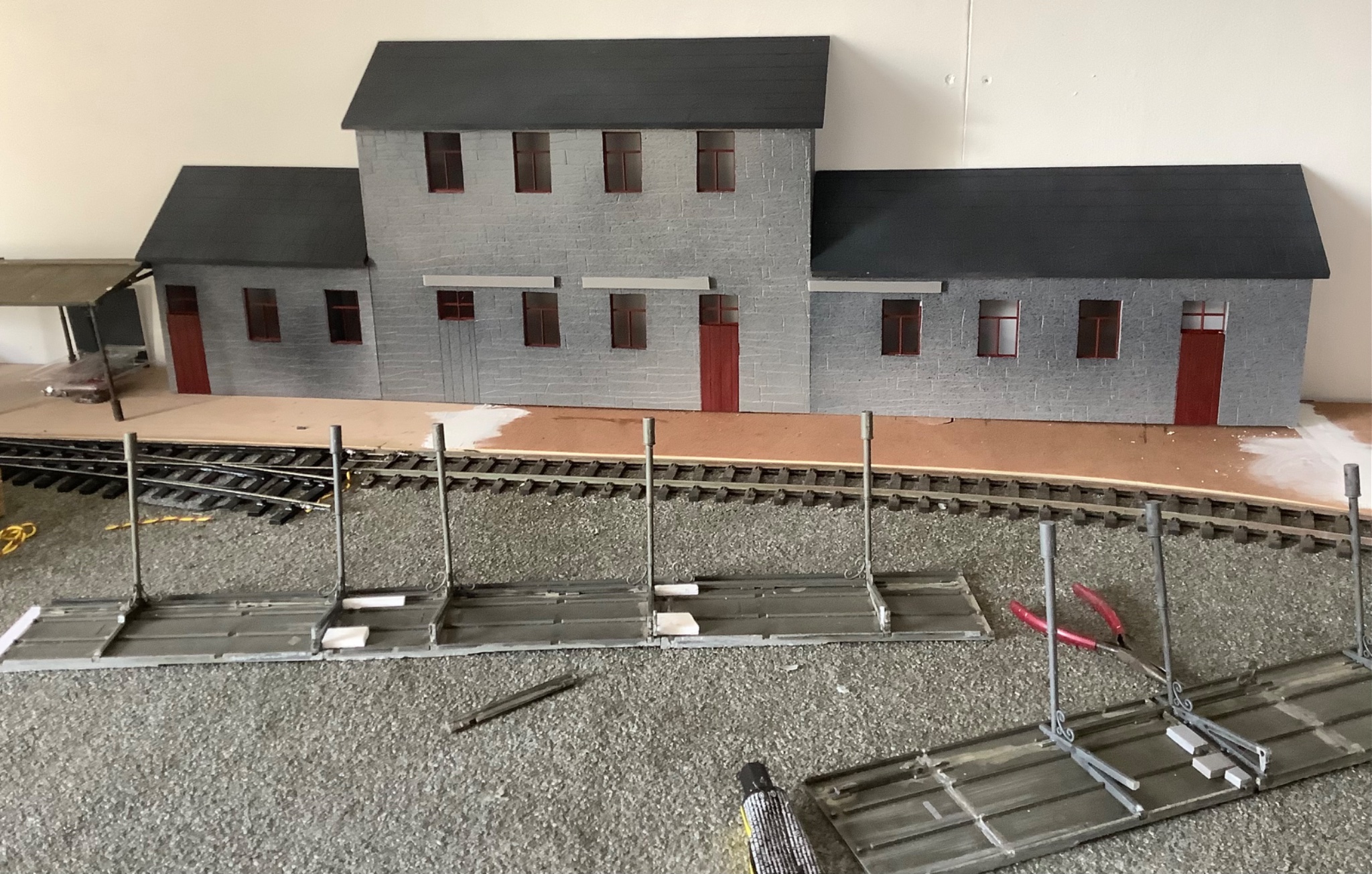

Work started cutting out lots of Plasticard coated Foam. Using existing windows to stock resulted in slight differences, with the windows clearly too small. Perhaps less height may have resolved this but. Ike was happy so onwards and upwards.
Being half relief the building has sides to match the required width, this is also a good place to put in some extra side support to keep things strong, on occasion there may be a need to move the building out and this has been considered on all I have done for this line.
With the building in place thoughts turned to the Canopy, this was an old Piko that had seen better days before it’s move to Somerset. Mostly half width but some over was repaired, joined and fitted into place on ridges glued to tye building sides. This is also removable in I think 3 pieces.
Shown in place with the Canopy in place, oh yes the platforms were cut from Ply to match the rail height.

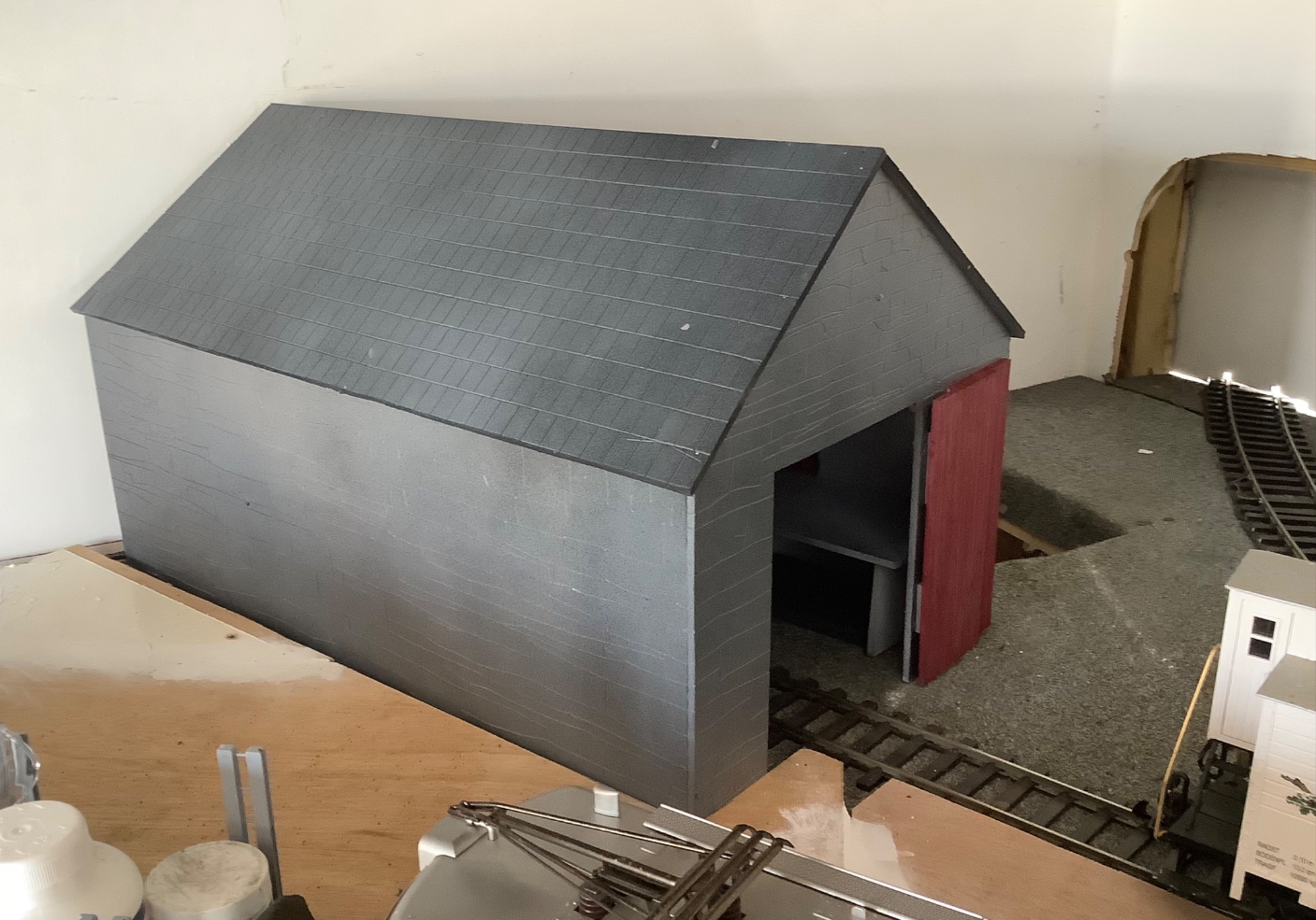

Next up was the Goods shed, this was a similar construction with be it noted no detail on the rear.IMG_8568.jpeg
In the case of both these buildings brickwaork and roofing slates have all been scribed onto the Foam Board with a small screwdriver, this is just pressed to make the uprights of the bricks all the Roof Tiles are fully scribed by doing the lengthways, then every other row vertivally followed by the others at 50% different starting point. Sound tedious but does not take that long and the effort well worth it.

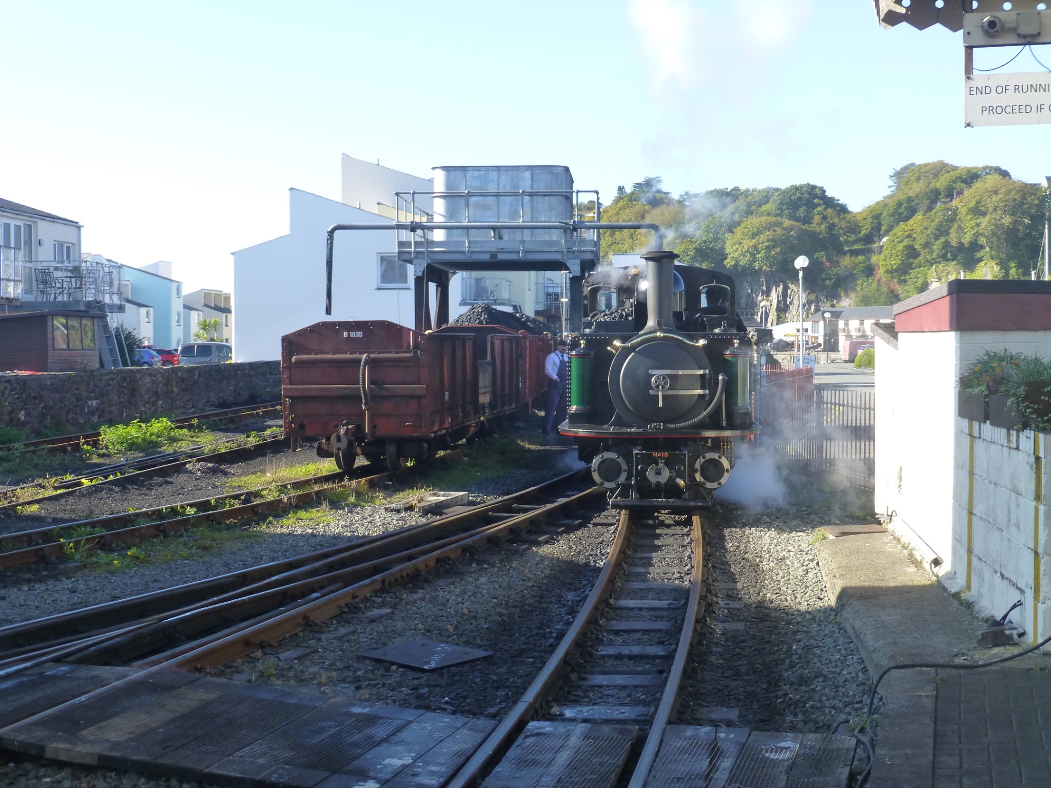

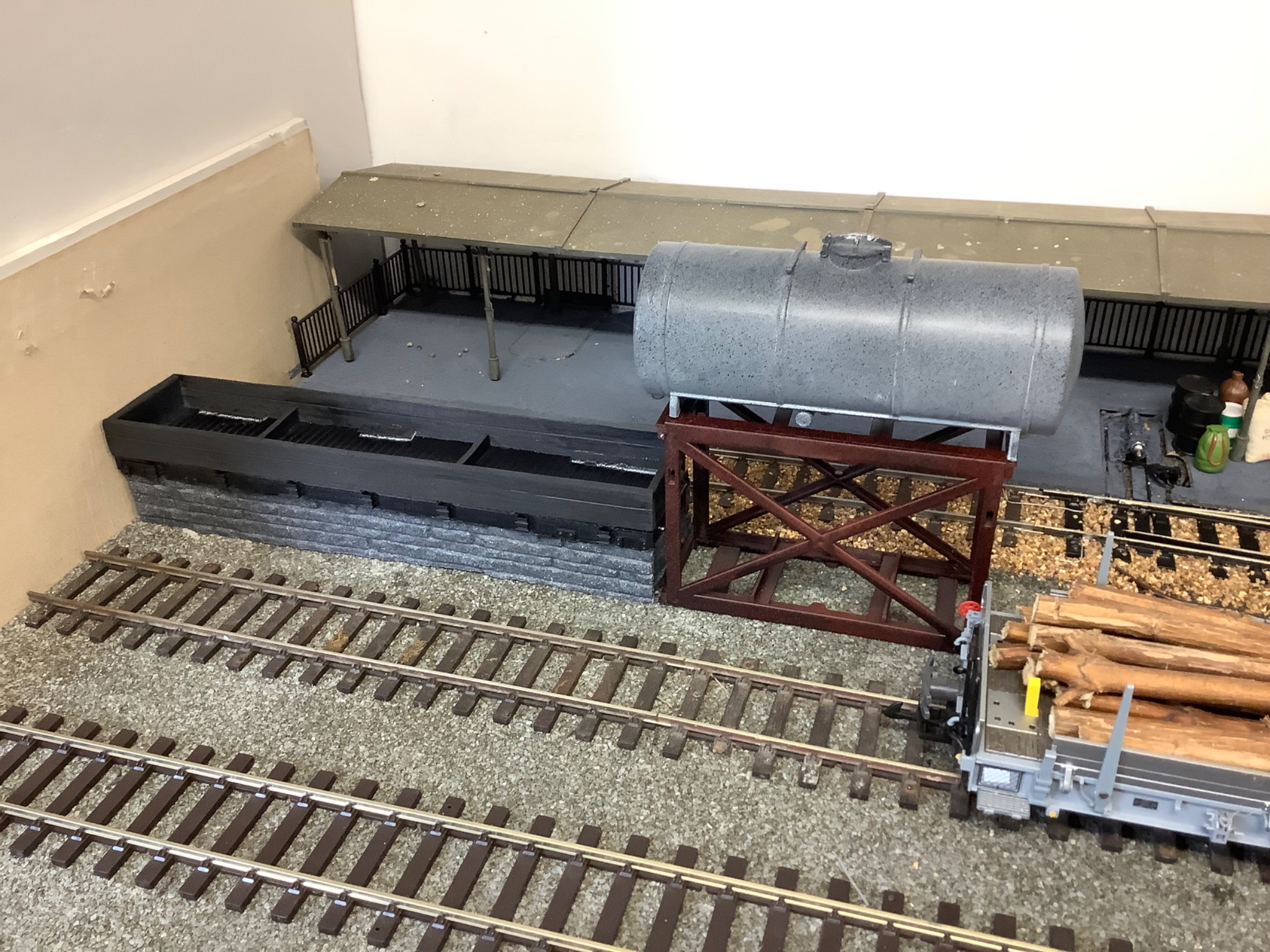

This month I worked on sundry jobs, one being the Coal Tower and Water Tank at Portmadoc. This is what I was attempting to achieve, but sundry existing parts suggested a ‘look alike’ would work nicely.

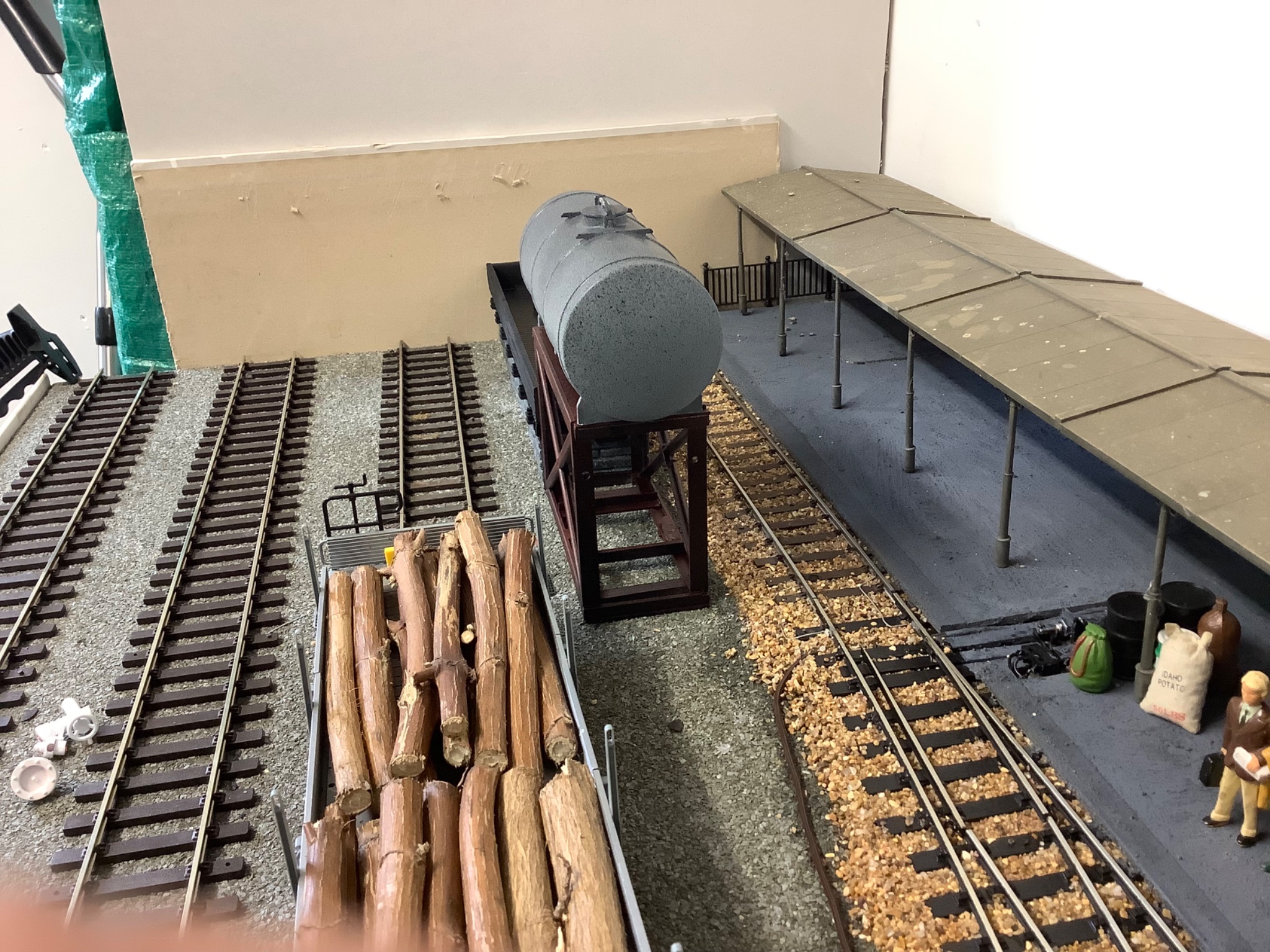

Mike had a couple of unbuilt Newquid Tank Wagons that he got at sometime from somewhere or other. So the Tank started as a basis, there were also some Tops from. Ewquid Bogie Stake Wagons and this was deemed to be appropriate. Having a rummage through the bits bixes found some cut off bits from a damaged LGB Girder Bridge thus we were on our way.
Base for tank utilised the. Ridge Sections to make a base with the Tank glued on top. Base was sprayed matt black with an over of matt undercoat brown to represent rust. The tank was sprayed matt grey with a modest overspray of matt black then glued on top of the base.
The Coal Bin needed to be thinned down thus part at the Station side was cut down to fit the space available with a base made by using one if those Aldi Stone looking Planters cut down to size.

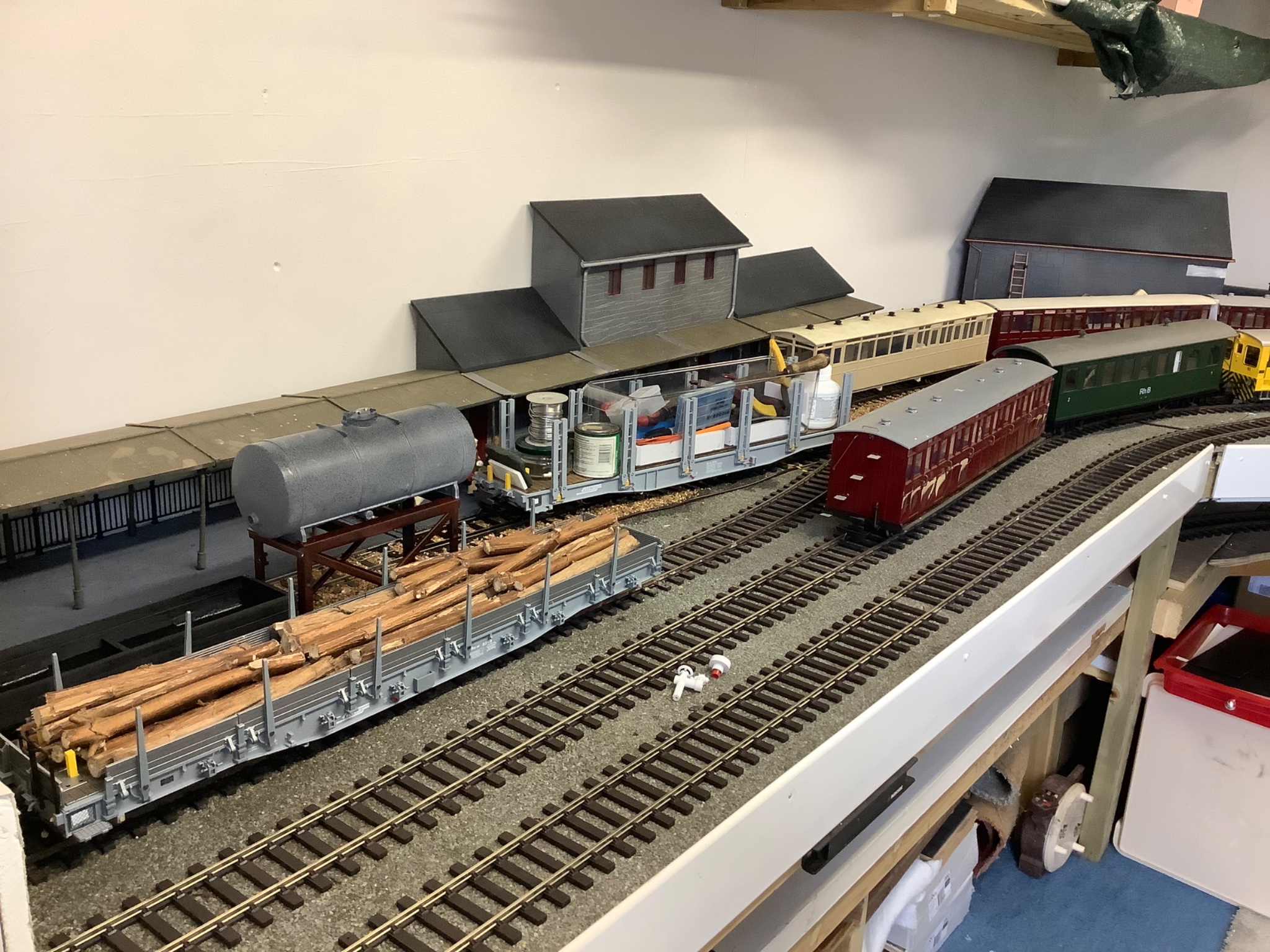

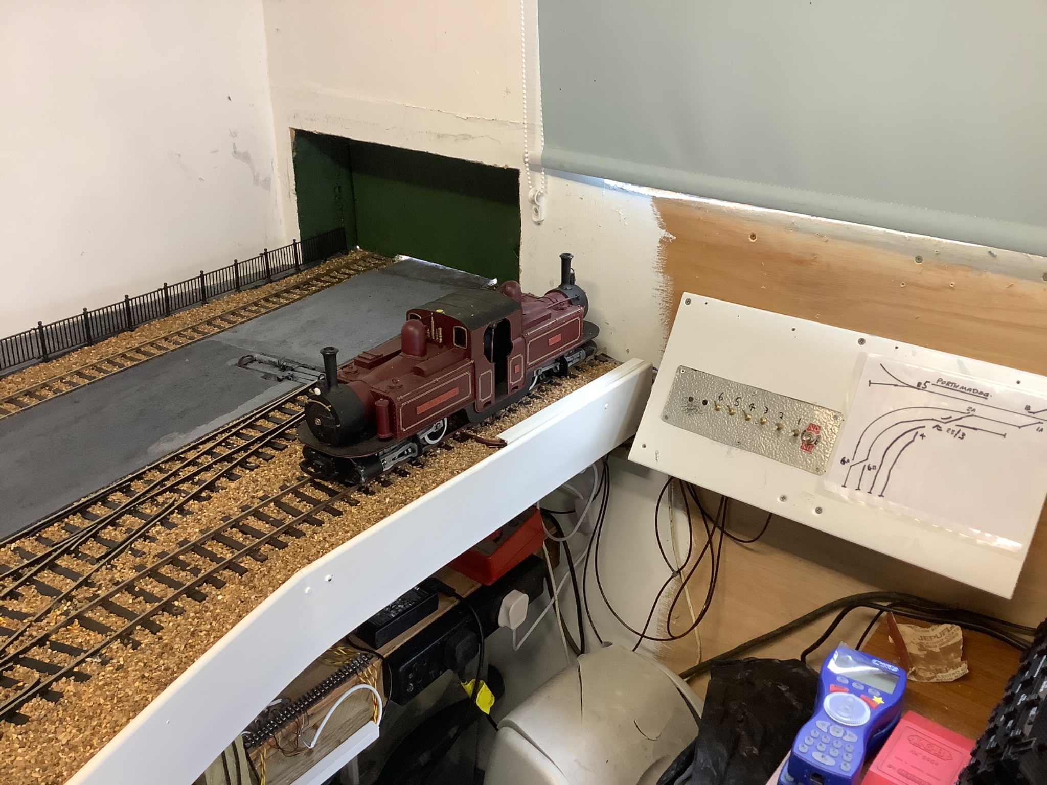

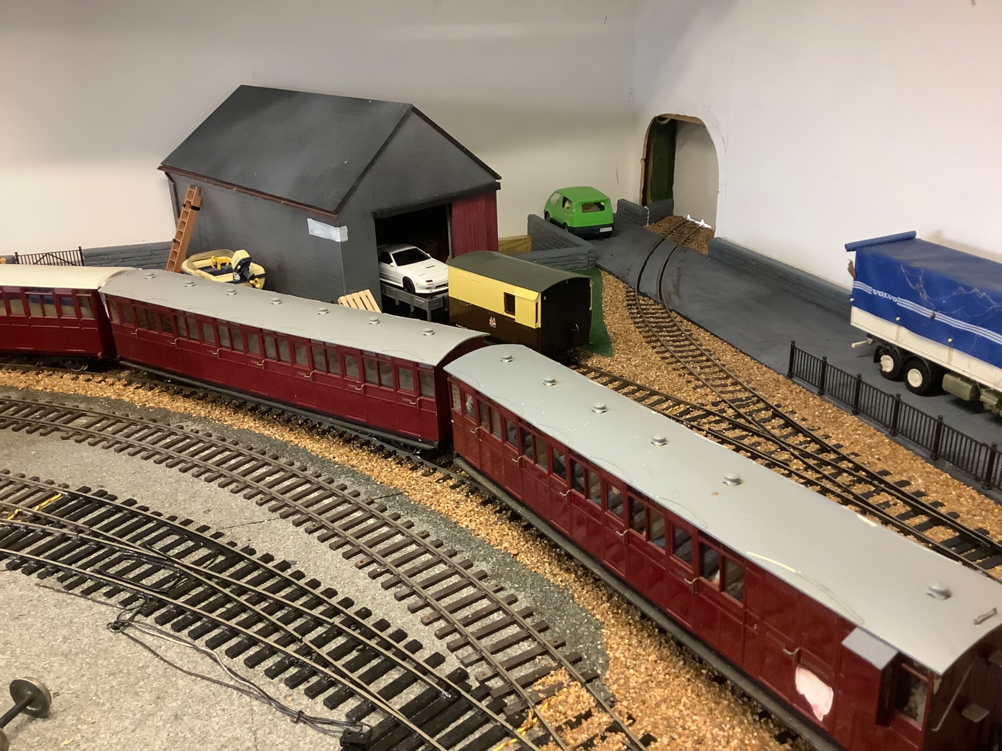

Ithing complex in any of this work so a few pics to show how the site has changed between my 2 visits.IMG_8859.jpegIMG_8858.jpegIMG_8860.jpeg
Ballasting will be next, but typically the supplier of this type of ballast does not supply any more, but Mike has probably enough in stock to finish this site off. Then he will attend to the Water Supply pipes, I could not find anything suitable in stock so Mike will need to attend to this.
