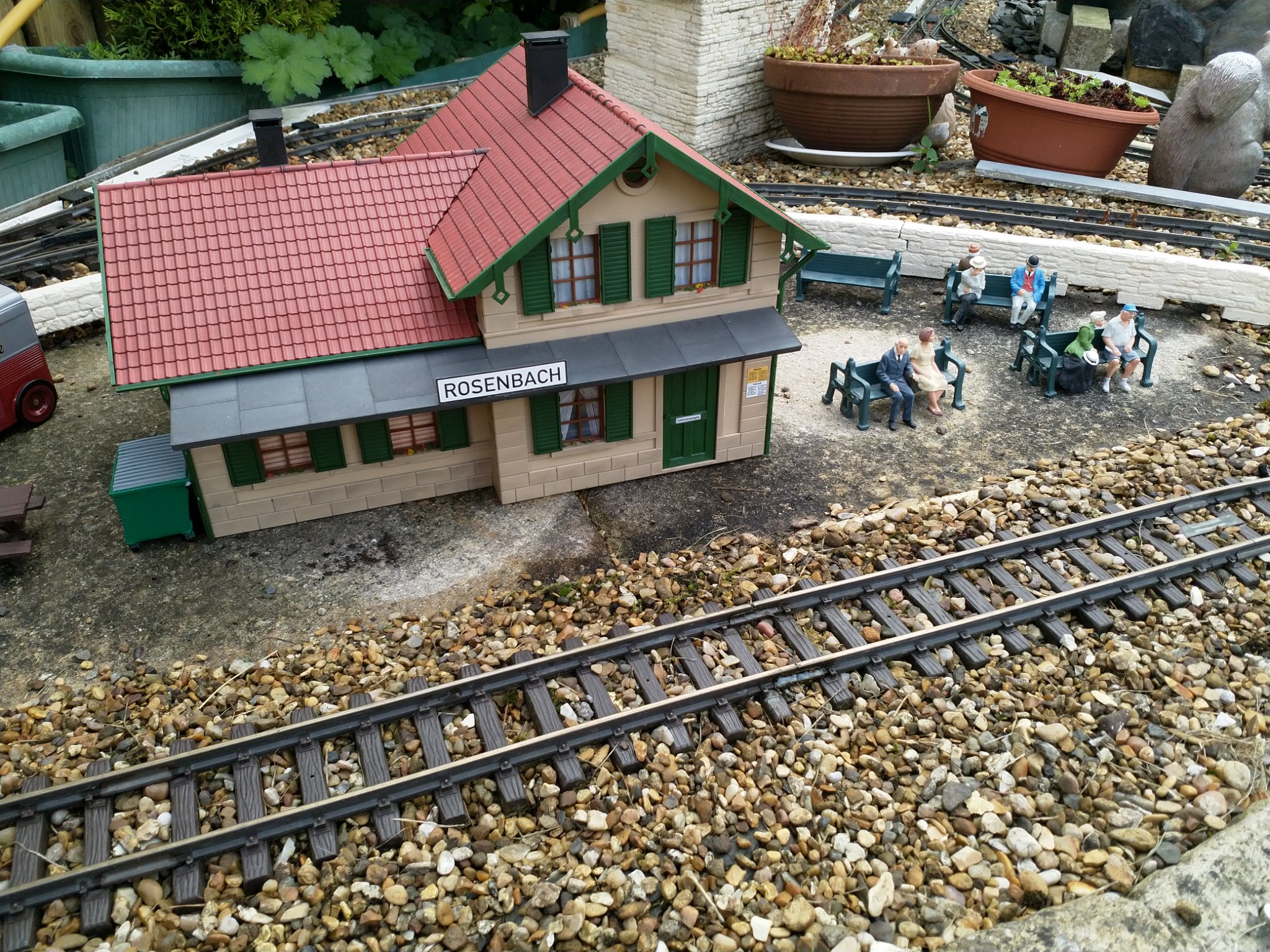

I think everyone has a Rosenbach station - usually bought with a massive discount. ;)

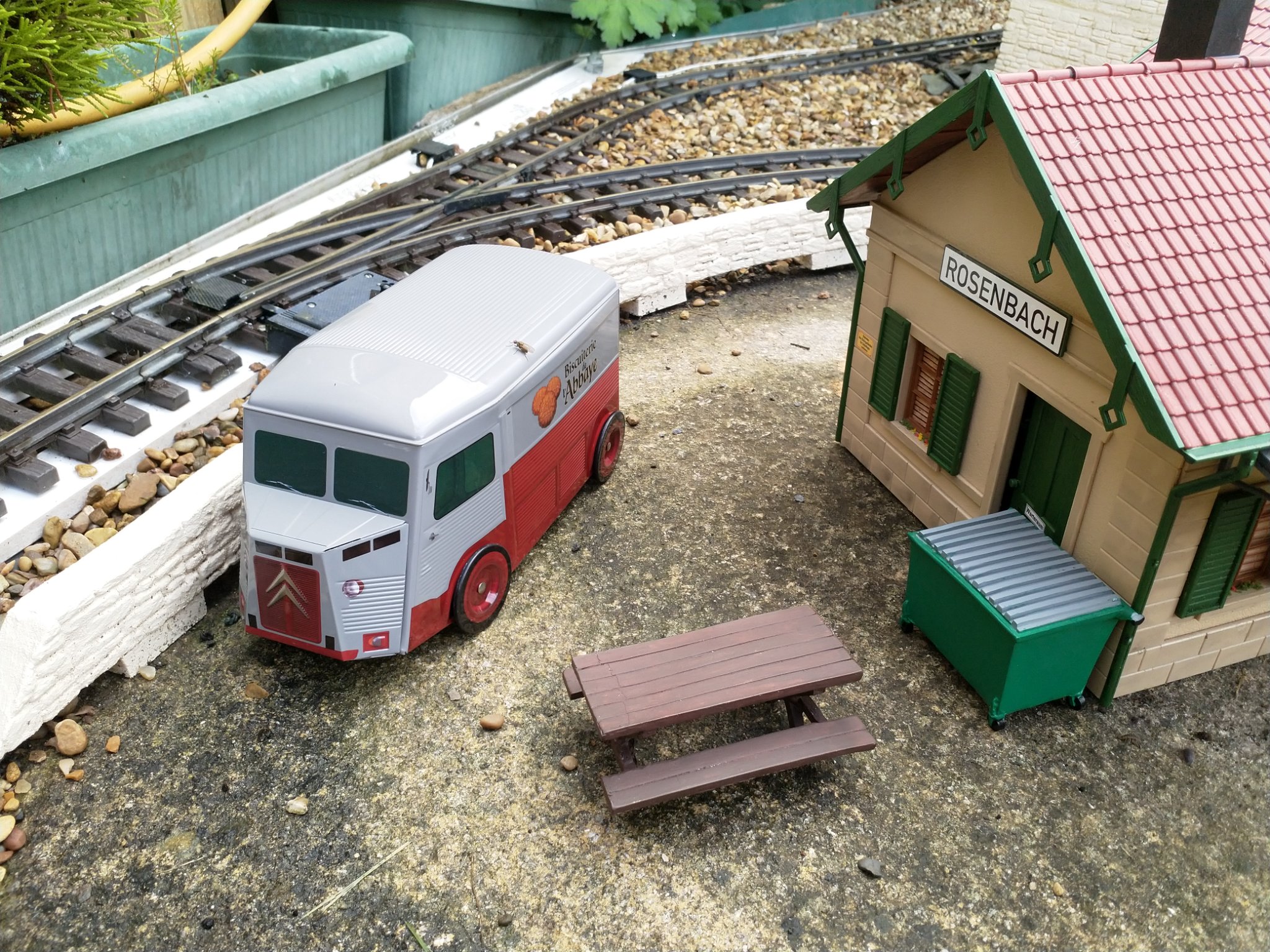

Mine goes back in the garage when not in use along with the pub which is basically the same, signal box and sheds.IMG_20210731_173400.jpgIMG_20210731_173452.jpgIMG_20210731_175827.jpgIMG_20210723_200643.jpg

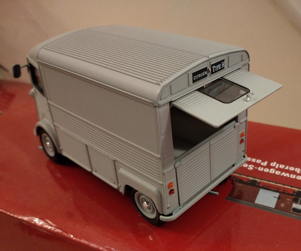

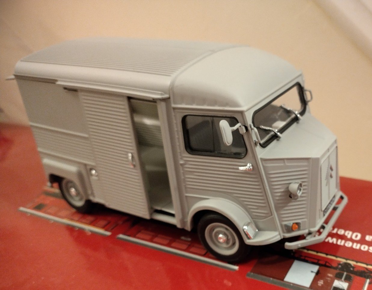

What make is the Citroen H van, please?
The pictured one was a biscuit tin, but I have others,

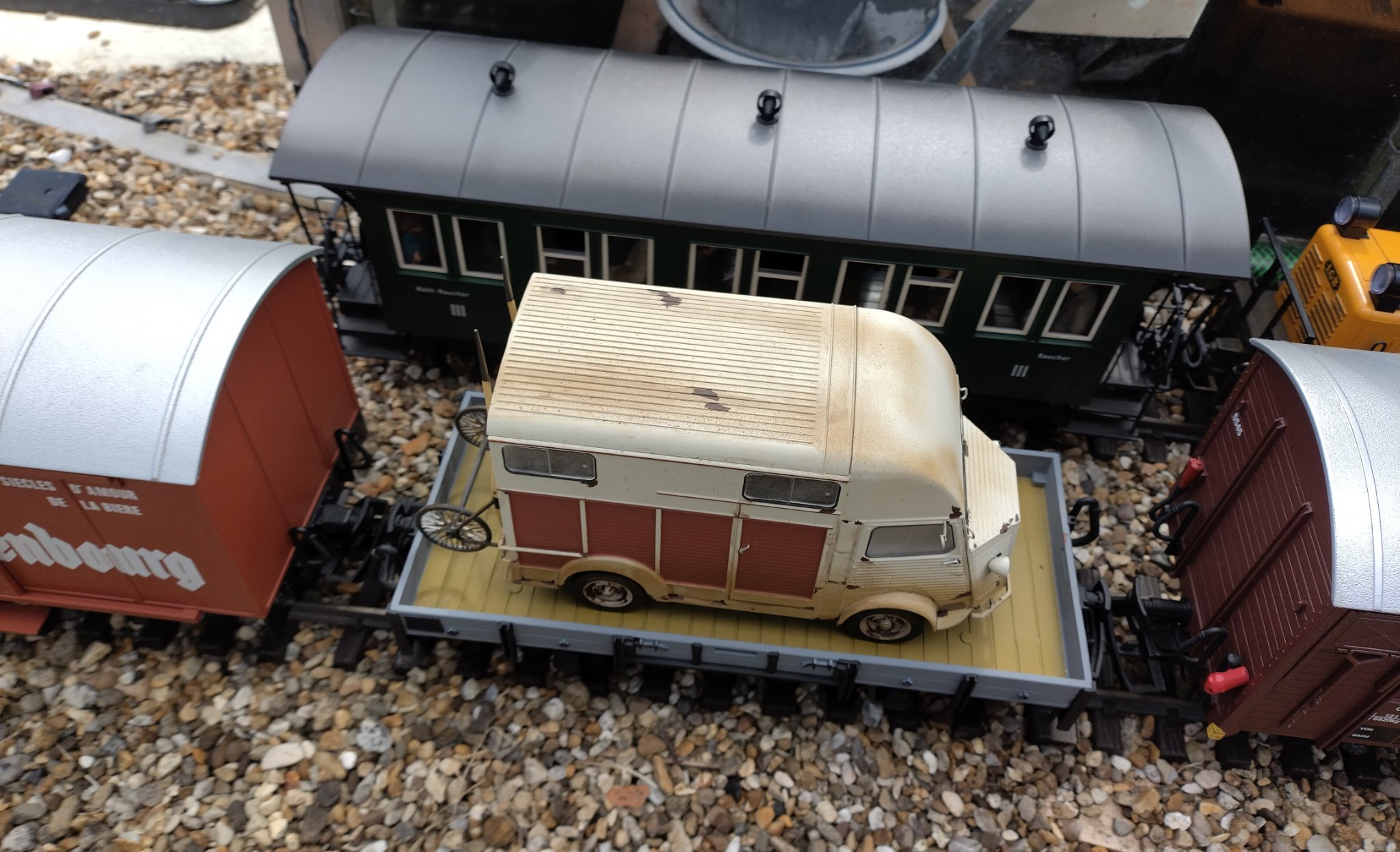

The one below is a Horsebox that I have weathered from Hachette
The one below is the more normal one from Welly - I haven't decided out what to do with this one yet.
