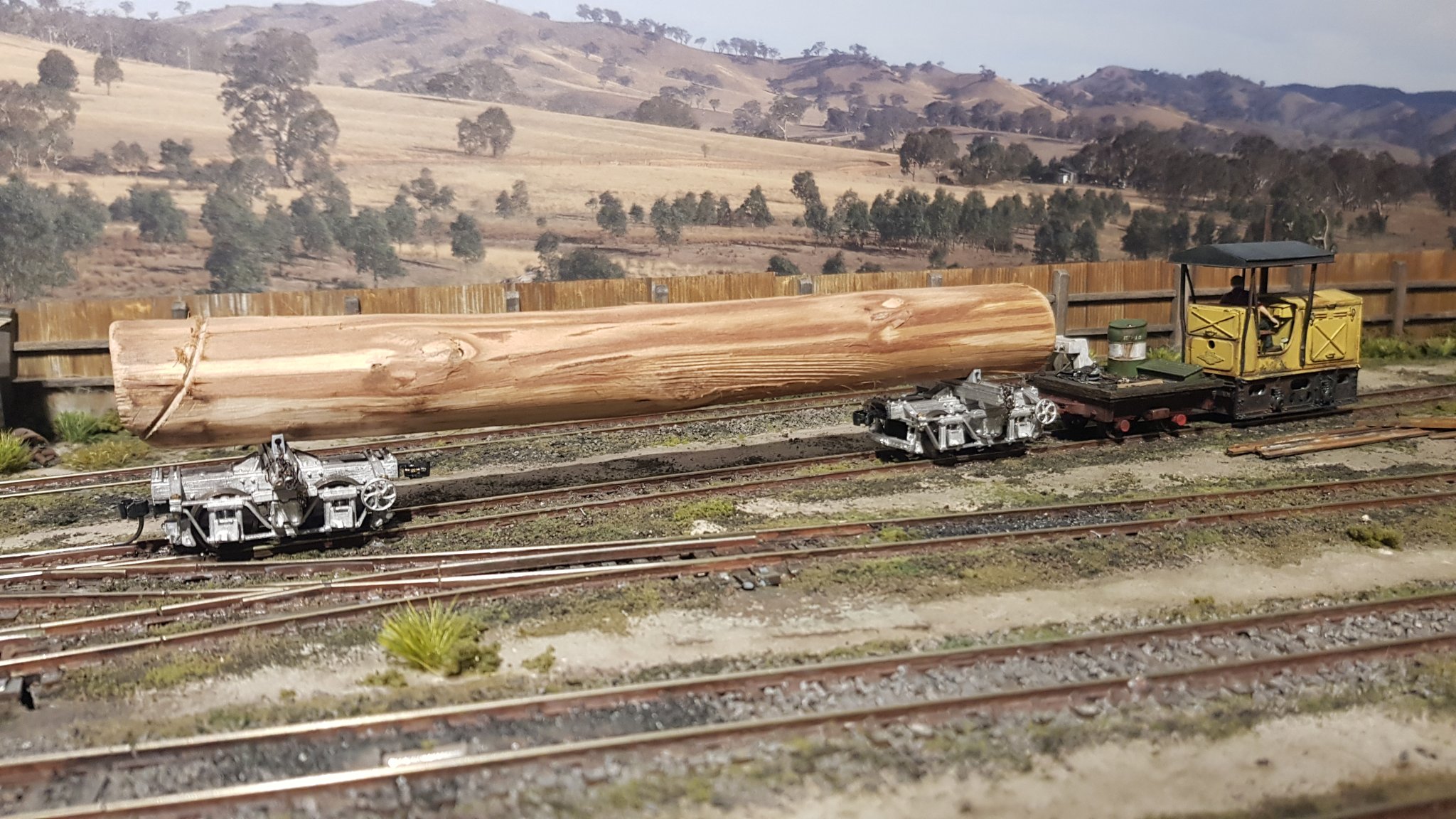

I agree with John's suggestion - using an air eraser with either a soft cutting compound or baking soda will remove decals/lettering in a non-destructive way (Jerry Kits of Foothill Models put me onto this many years ago).
I'm now applying the same techniques I have used for my 1/48 scale On30 work to my first Fn3 scale project ( a rebuild of a wreck of a Bachmann 3 Truck Shay).
This was my first weathering job done a number of years a go - a bright yellow Bachmann Bumblebee (now has TCS Wowsound decoder, lights, etc.):

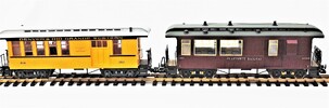

ciao, for me: no sanding, 1 washing, 2 primer, 3 light paint spray (2 -3 times), 4 transparent matt
here a small selection of my repainted LGB models
