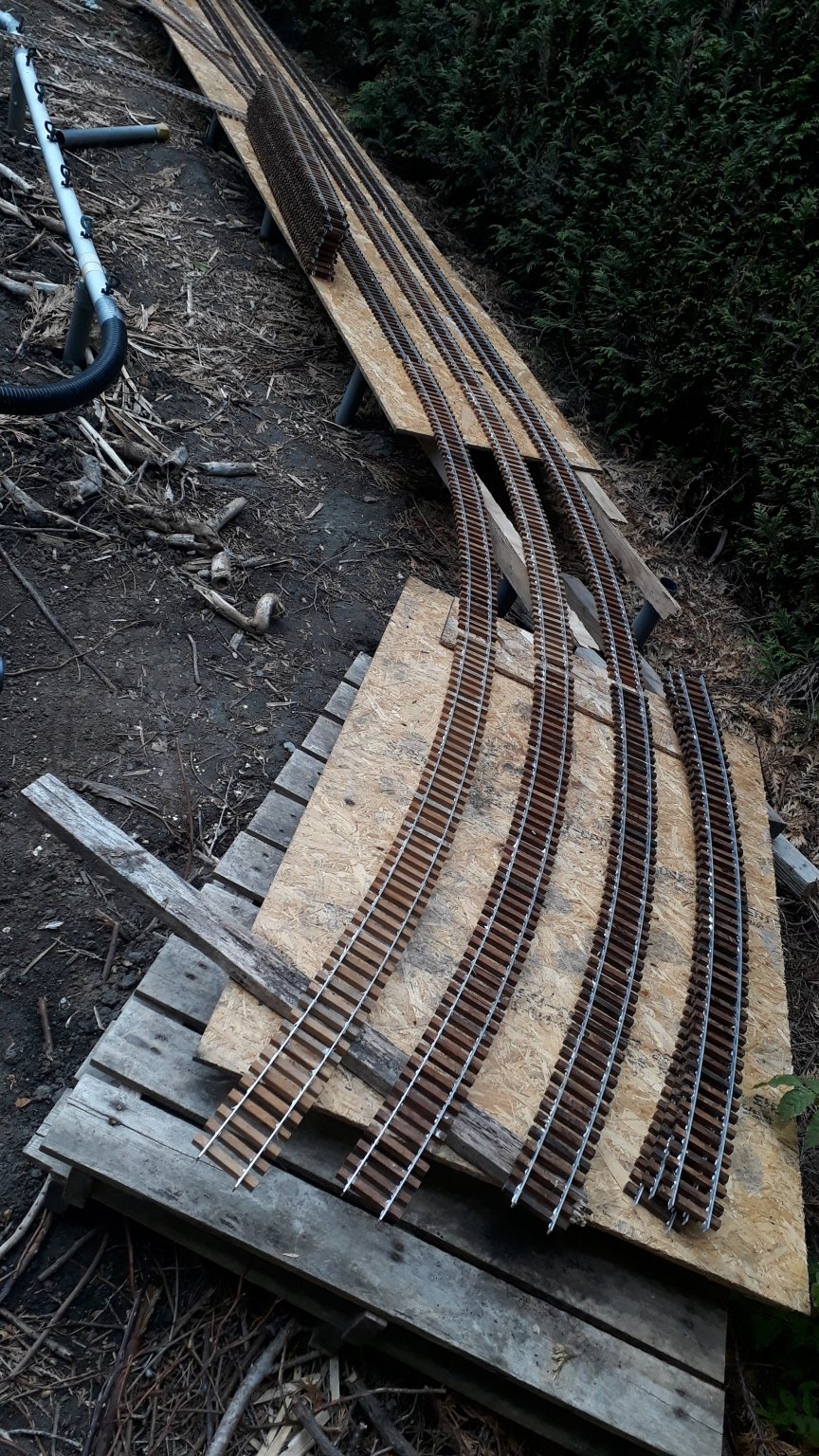

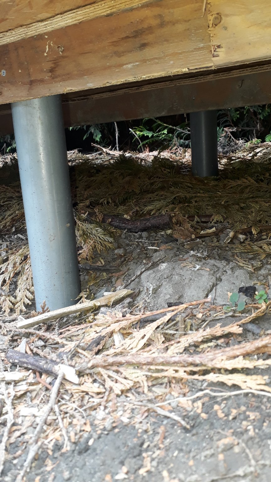

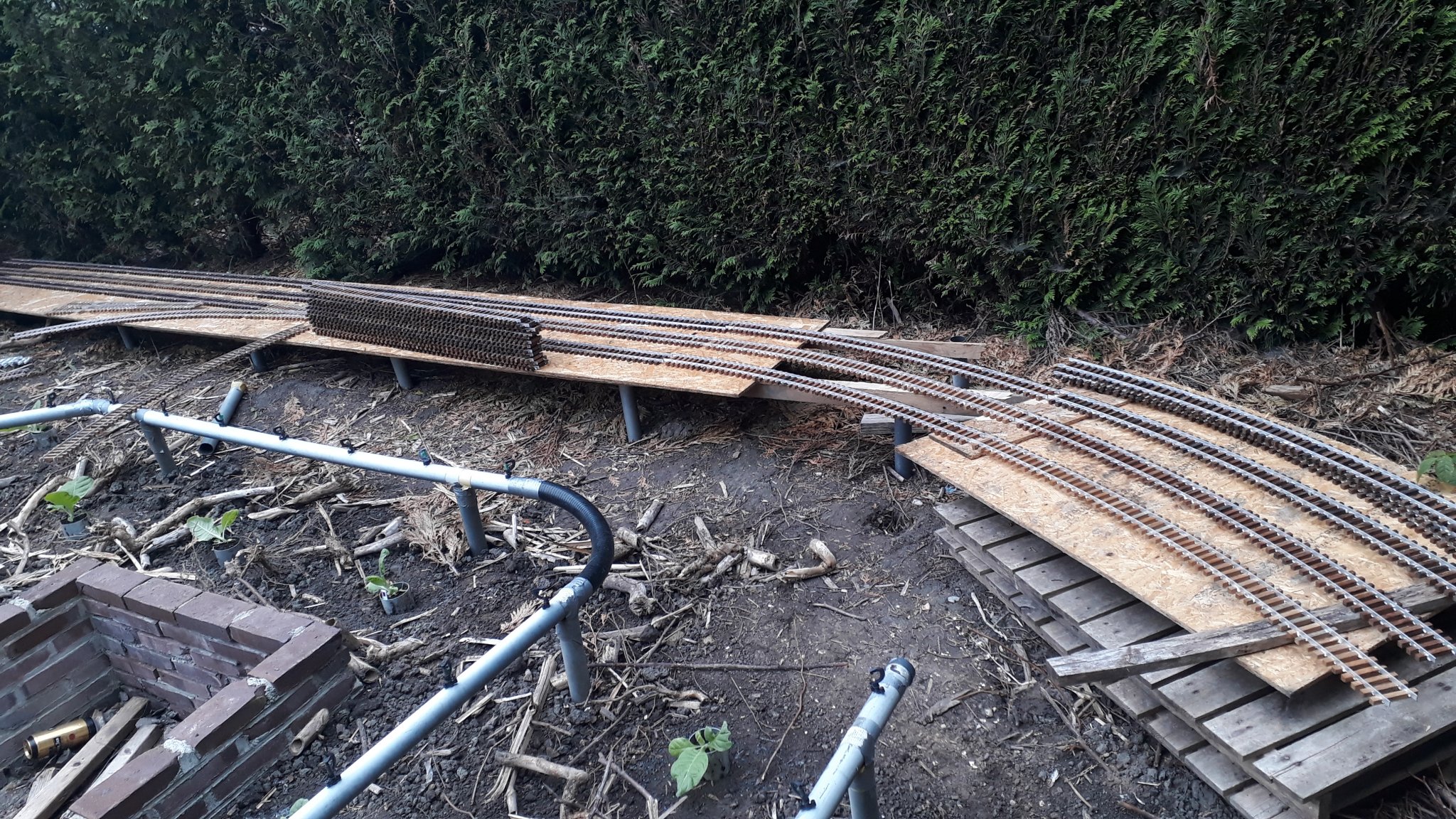

This experiment for the track bed: i use for now osb sheet, to see if i am comfortable with the structure on PVC pipes and a wooden frame attached(hanging) on them plus the height thru out the garden, i could walk over it with my 80 kilo's without deformation of the bed or taking it out of level.
For the sheets i still not figured that one out, could be hdpe, ~foam pvc, exterior multiplex or impregnated (greenish) fence wood covered with a rubber foil or roofing material.
(Even if i would cover the osb sheet to protected them from falling rain they will be good for at least 10 years)

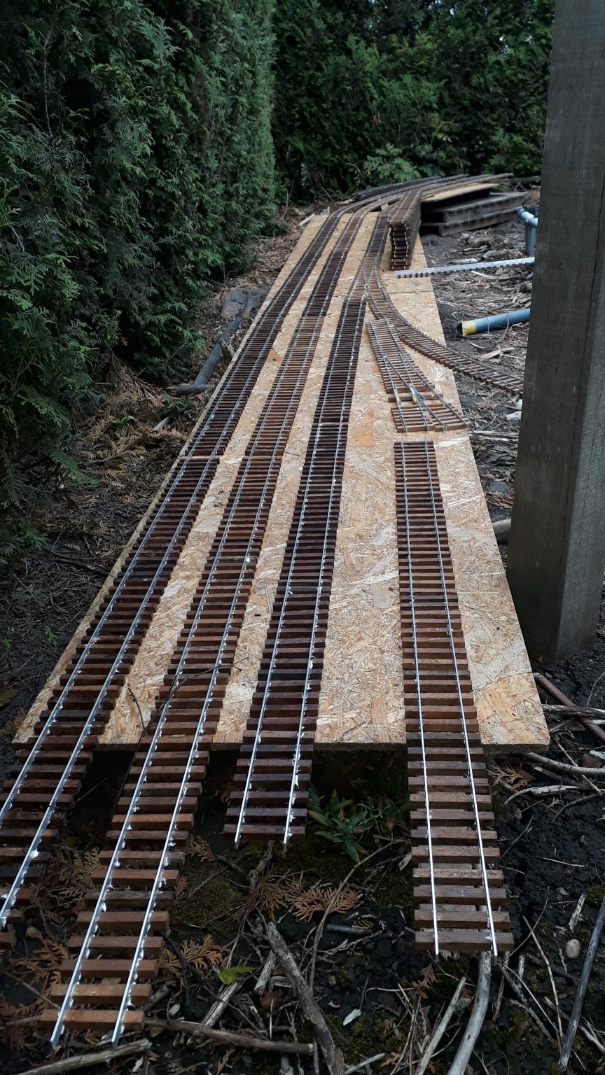

Ps i am able to make tracks in every configuration/ curve ect thanks to temp-lot2, i can produce in my molds ca 10 meters/33 yards a day, easy.
For the cost of a total of 1,20 euro, I can make 1,25 meters/4.2 yards: incl putty(bought), azobe wood(bought) and (homemade) wood stain, .

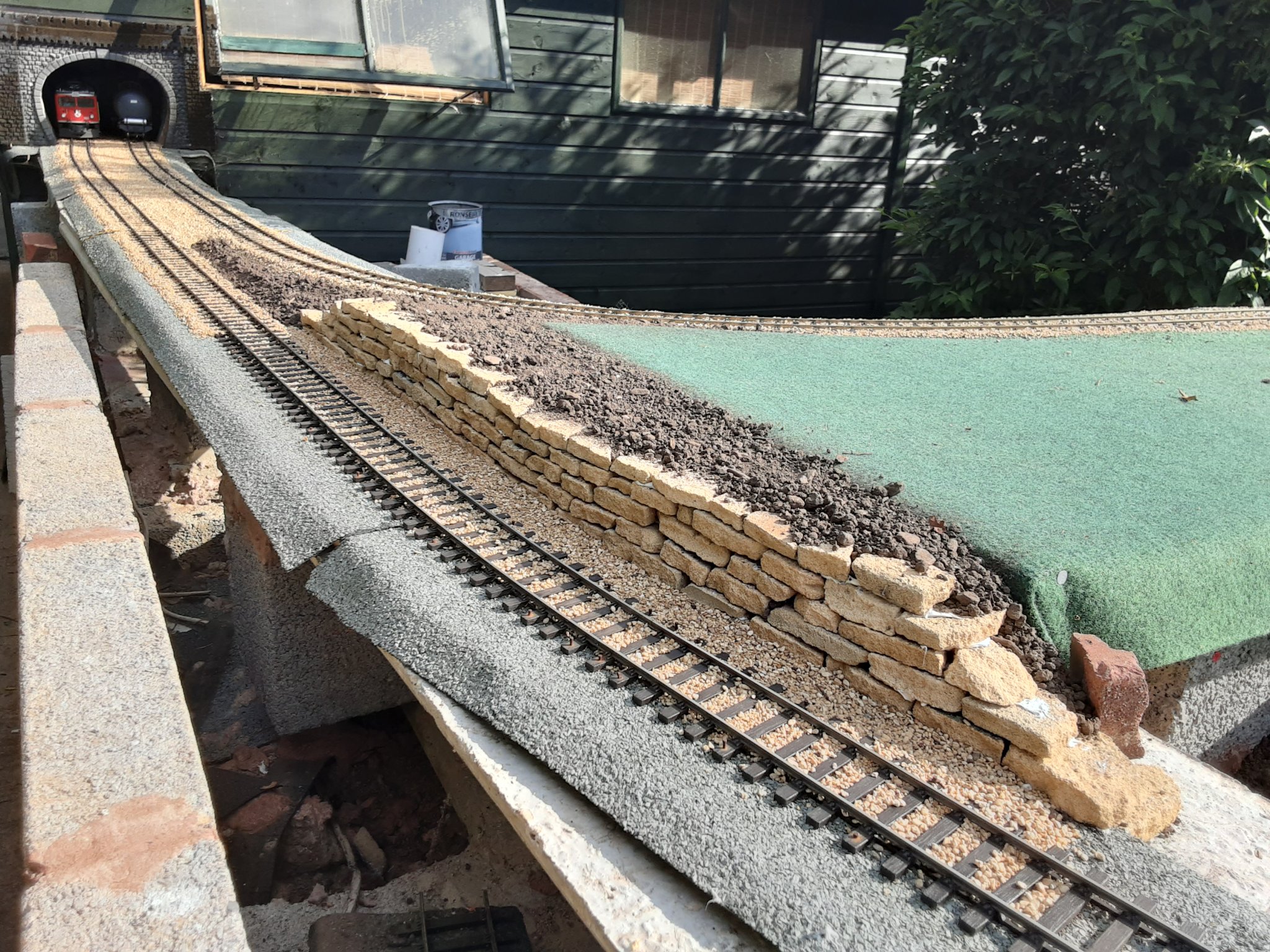

On the pictures is ruffly 45 meters of track(sorry i am a little proud of this achievement)
