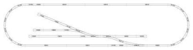

Hi All,
This will be my first "permanent" G Scale layout and due to limited space will be relatively small, certainly compared with some of the fine examples to be found on this forum. My available space is 5400mm (18` ish) x 1350mm (4` 5"
. Messing around with Scarm I found you can fit a lot of track in that space but wanted a less cluttered feel. I also wanted a loop to run a train while shunting in the "middle".
So these are the three I Like the most, I`d appreciate any feed back and if I`ve made any glaring errors. I appreciate that the loop will be R1 curves and therefore limit me to short wheel base locos and rolling stock and I am (for now at least) happy with this.
The simple plan with inglenook:

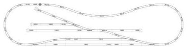

Looking at this I figured I could use a passing loop:

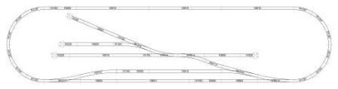

And finally I figured I had space to maybe make the continuous loop a little more interesting to watch trains run on, possibly with an elevation change (albeit slight) as well:
