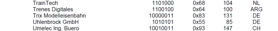

CV 8 is a mandatory CV, the value of which is given out by the NMRA. It is the 'manufacturer ID'.
As yet, I have not found an entry for the value '131' which the decoder I have come across gives.
According to NMRA 'standards', this CV should be 'read only'. it would appear you can write a value to this CV on these decoders to force a reset.. I can only presume the value is then set back internally to the 'manufacturer ID'.
As has been said somewhere on here before 131 is Trix

CV8 = 131, 131 = Trix ?? Did Marklin buy-up Trix? - I could not find '131' in the listings I went through on the NMRA site. ::) :(
Marklin have owned Trix since about the mid 1990's: https://en.wikipedia.org/wiki/M%C3%A4rklin
Yes 131 is Trix: http://www.nmra.org/sites/default/files/appendix_a2c_s-9.2.2.pdf
It you look at Trix decoder manuals they are very similar in terms of CVs to the new LGB MFX ones.

CV8 = 131, 131 = Trix ?? Did Marklin buy-up Trix? - I could not find `131` in the listings I went through on the NMRA site. ::) :(
[/quote]
Trix is defiantly in the list on the NMRA site.... http://nmra.org/sites/default/files/appendix_a2c_s-9.2.2.pdf
