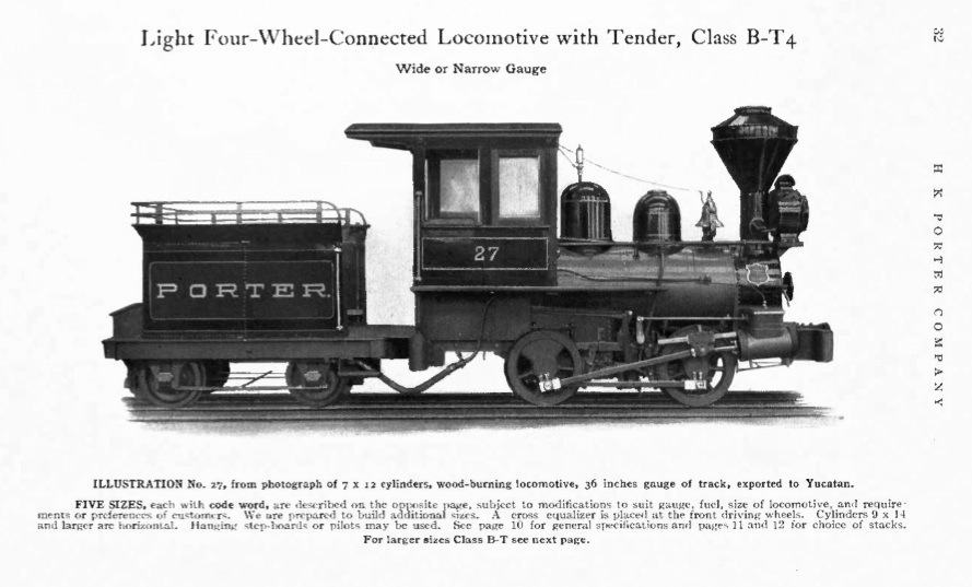

I have one on the workbench - must get it finished - and another I knocked about a bit! What I wanted .......
....and my attempts so far

- and this was the inspiration .......
I printed the road name with my inkjet printer - alas the black has faded. I should have used white stick-on lettering straight onto the black-painted tanks!
