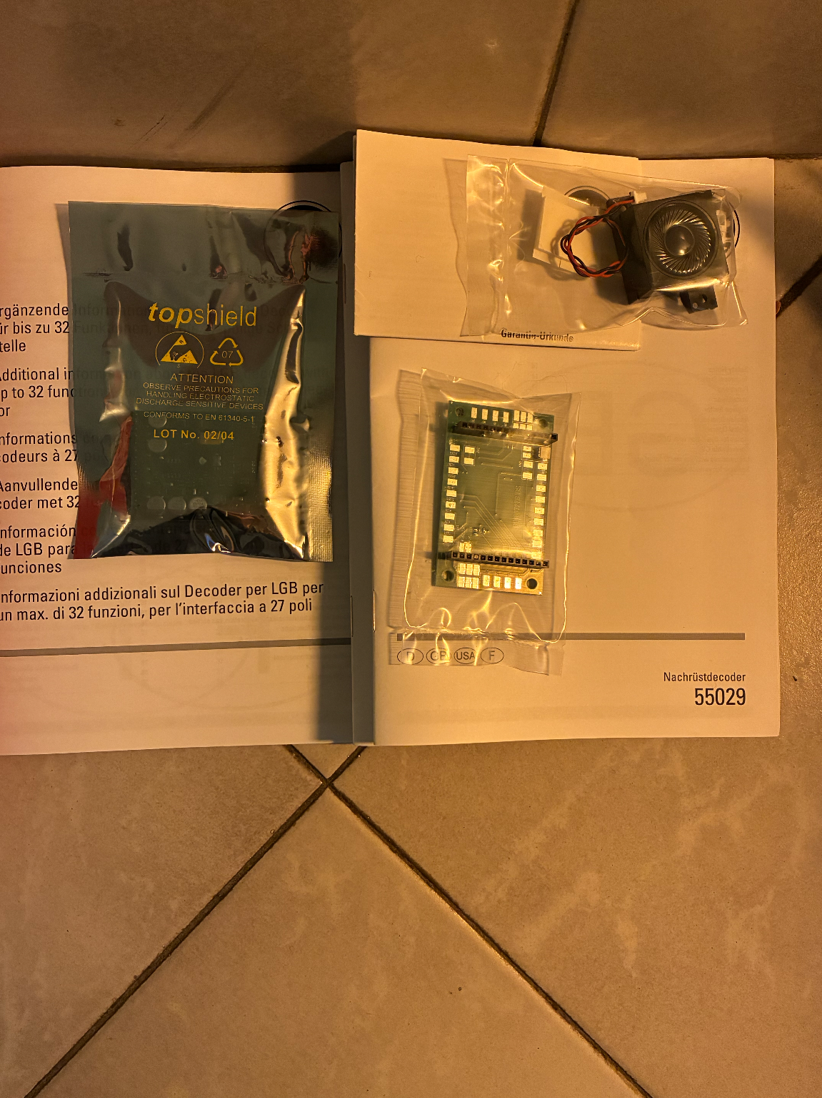

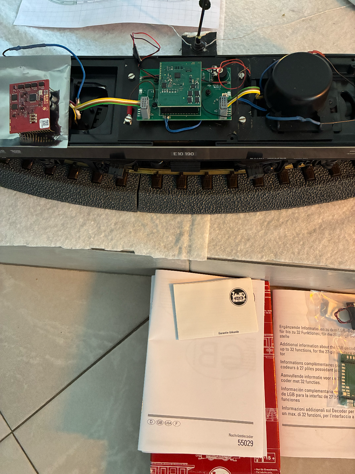

Good day all. Finally i gave up this project, cause it doesn't work, and my LGB K.Sächs, i was not sure, but is able to pull my 6 Christmas train cars. I preferred to replace LGB 55028 decoder by a new 55029 in my LGB E10. This time it was quick install with no issues, and the good surprise is that the sound works whereas not before. And so i will try later to install 55028 in my tender ....

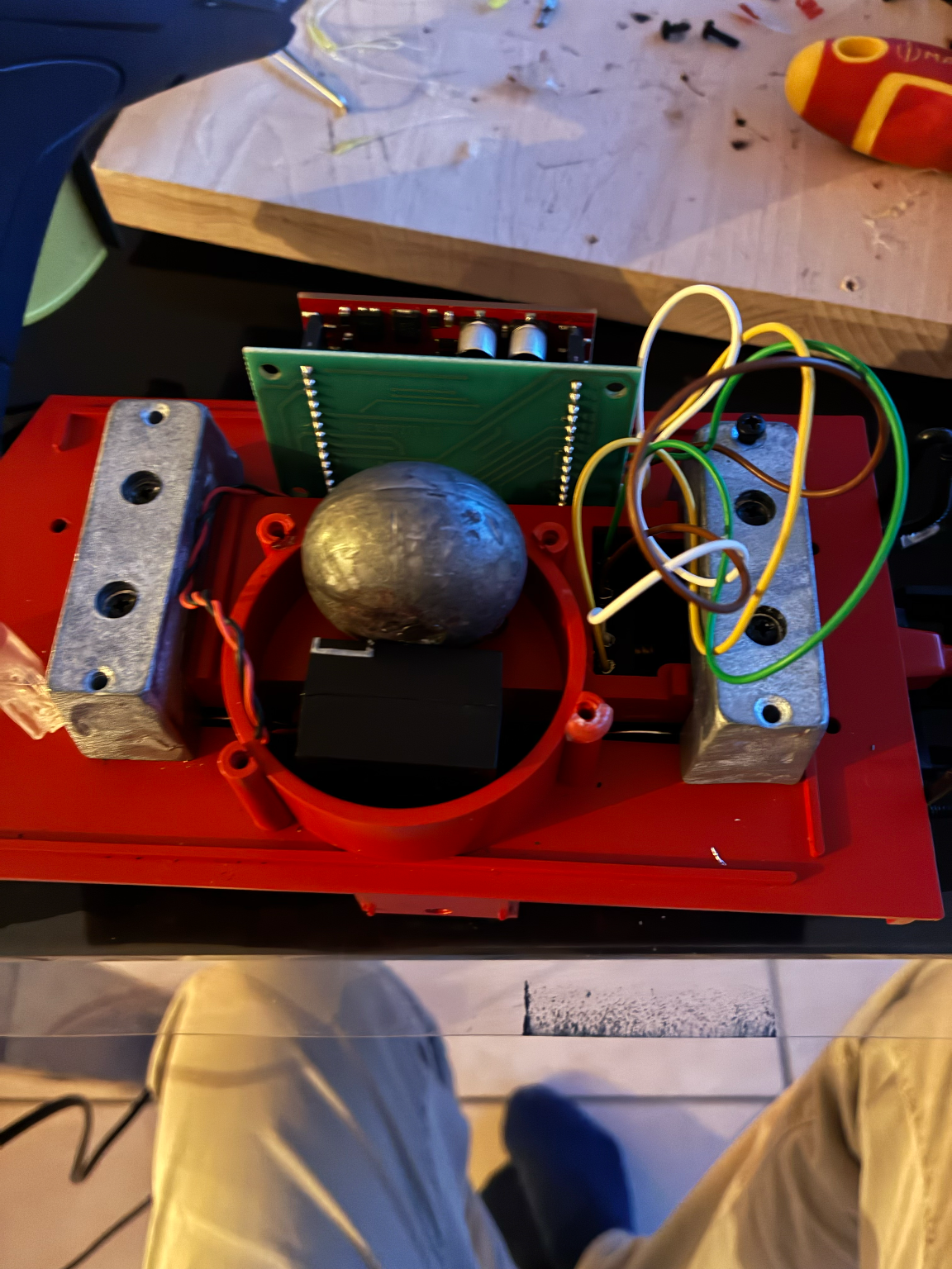

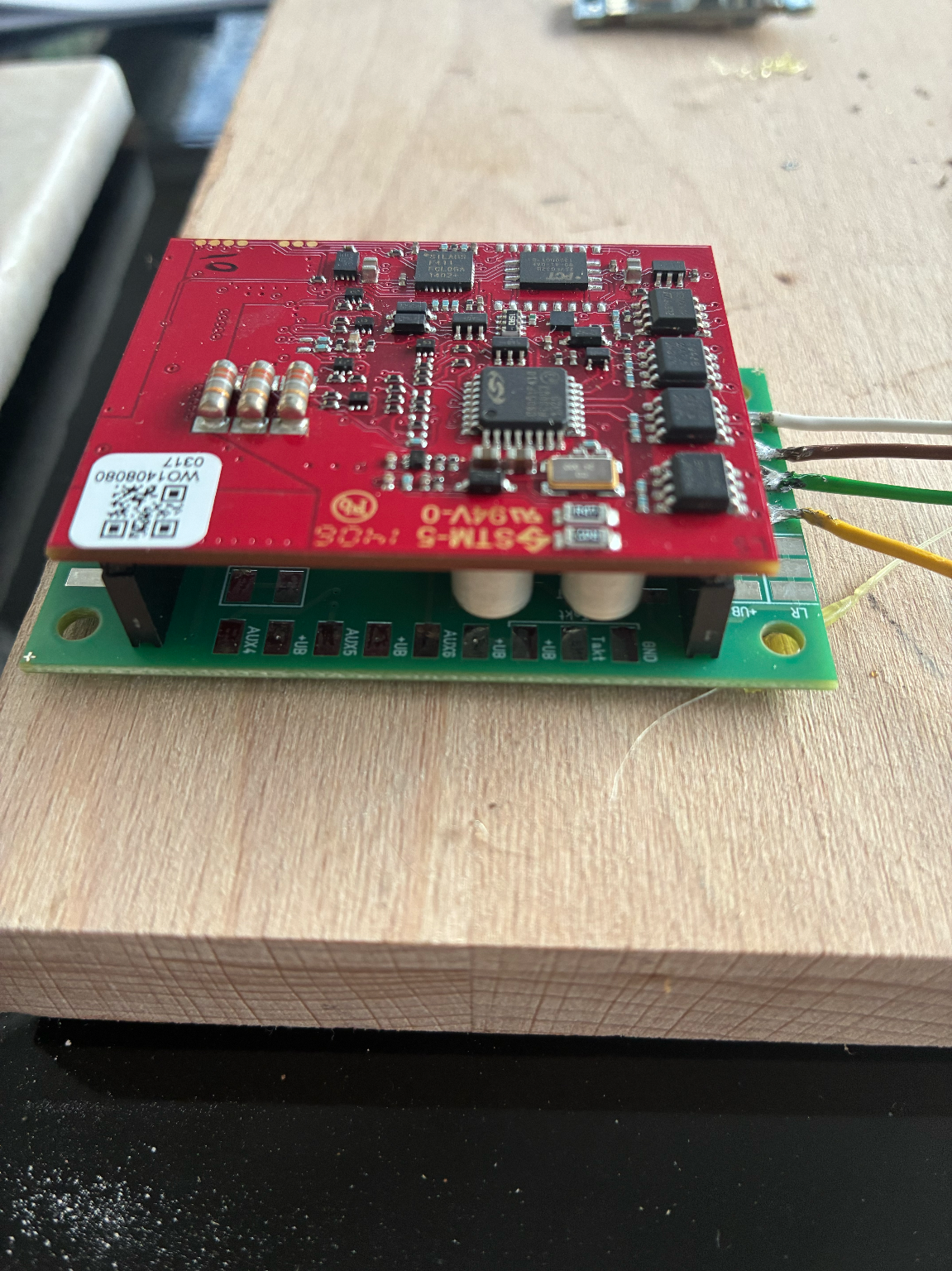

Today i finally installed LGB 55028 decoder in the tender, because after few turn, the K.Sächs was not so powerful as expected ... installation was easy, i've removed the analog platine, and now it runs great !
