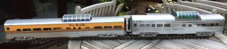

Here is a photo of a USAT streamliner end to end with an Aristocraft late model streamliner (with the lowered bogies.
The Aristo one is little higher.

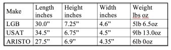

Here is a measurement of all three Brands of streamliner (excluding American Great Trains)
