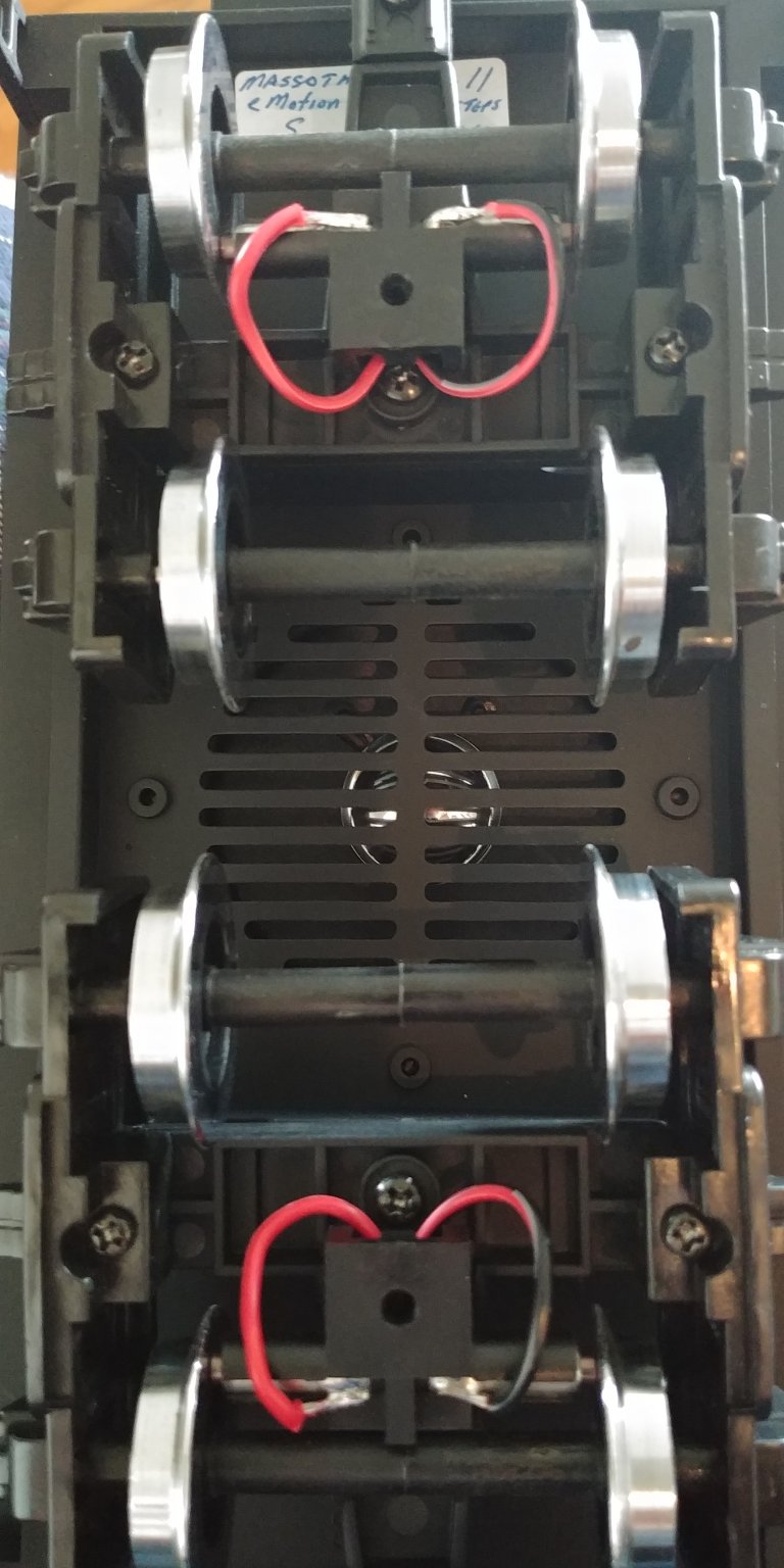

I used the LGB 63193 bogie pickup set on mine and installed a Massoth S decoder with Mogul sou
D
Distrackted
16 Apr 2017
7
1
63
Swansea, UKE
I used the LGB 63193 bogie electrical pickup set on mine and installed a Massoth emotion S decoder with Mogul sound file. I had to modify the holders a bit to accomodate the smaller wheels on the tender and glue the holders in place on the bogies, but i
t worked out really well and the sound is awesome.
