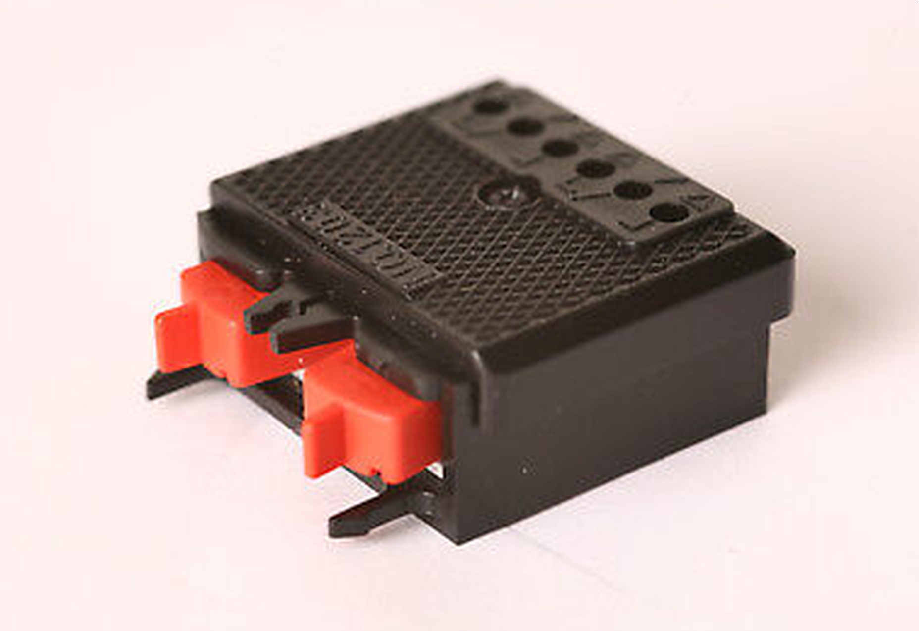

Do you mean the LGB EPL supplementary switch ref 12070?does anyone where I could get hold of the moveable switch in LGB point/switch motor

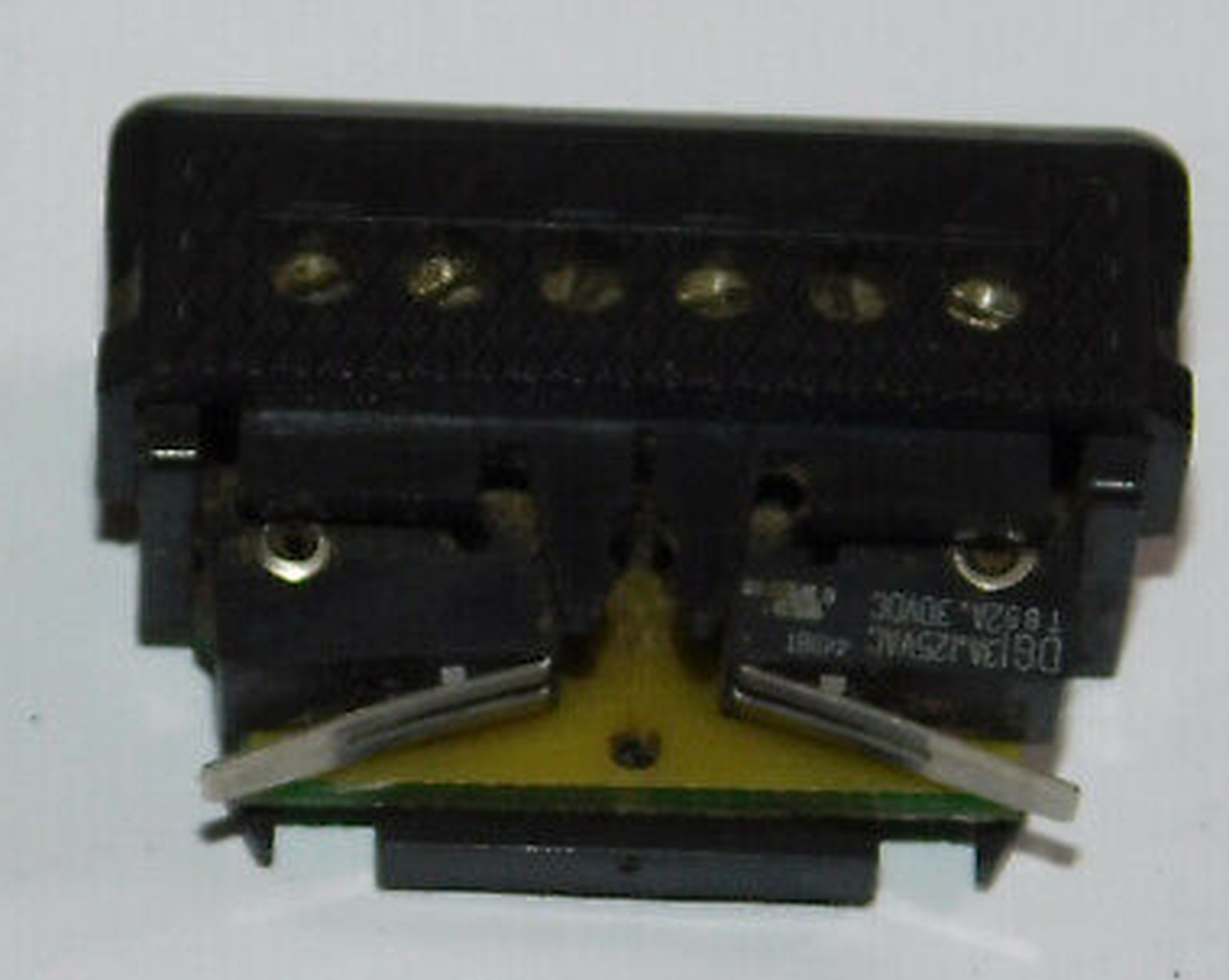

Electrically and functionally they are identical. The 12070 is a bit shorter than the 12030.I note that this is a type 2 and not sure what the difference is between this and a type 1 ref 12030
Yes they do look quite different, for my auto line I have the older 12030’s cos that is the era I come from. No doubting that both will be equally effective being LGB.Electrically and functionally they are identical. The 12070 is a bit shorter than the 12030.
The 12030 one uses a pair of toggle switches which are driven by the actuating bar
The 12070 uses a pair of micro-switches, also driven by the actuating bar.

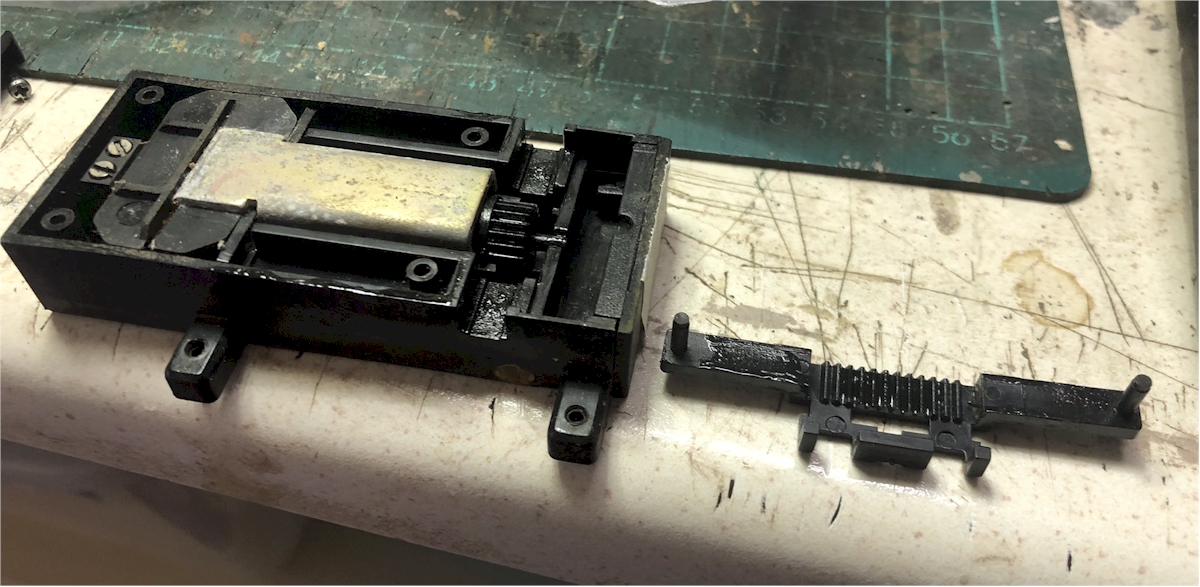

What I require is the arm that goes in and out of the point motor to move the blades
The component on the right? Ah, that's very different to what we had assumed! Unfortunately I've managed to fix the one duff motor I had, otherwise you could have had that one, for the part. Maybe someone else has one?What I require is the arm that goes in and out of the point motor to move the blades
if they'll send it to you post-brexit
Also from Champex Linden
PM sent to you, Ralff.I have just checked...and I do not have any...sorry.
