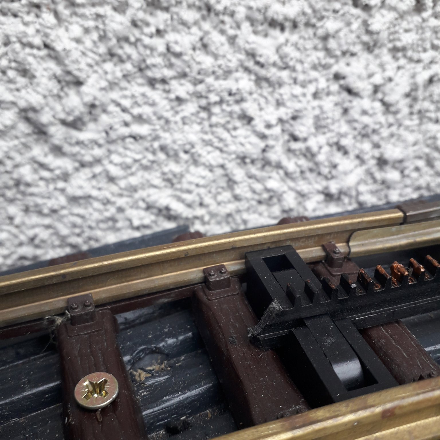

![20240618_171645[1].jpg 20240618_171645[1].jpg](https://cdn.gscalecentral.net/attachments/512/512926-a2c65a5e53b04e98d44b6cfd86df37d4.jpg?hash=osZaXlOwTp)
Probably does, but without a photo it's difficult to say.Thanks Gizzy
"modified version of the hook on couplings" think i have modified myself with a pair of wire cutters and created a slope into them ? do you think this does the same thing ??
The bottom of the coupling hook is reduced in depth to stop clanging along the top of the rack gear and possibly causing uncoupling.Thanks Gizzy
25 % rack operations here now and still fowling on the coupler, Nothing a bit more wire cutter removal cant help !I found that replacing the standard coupler hook with the rack-specific one made no difference and they still caught on the rack. In fact by eye (not micrometer) I can't actually see a difference. So I resorted to butchering standard couplings by cutting through just below the spring retaining hole. I did wonder if it was a function of my rack slope but that's only 33 cm over 180 cm. Which IIRC is well below the max quoted by LGB.
