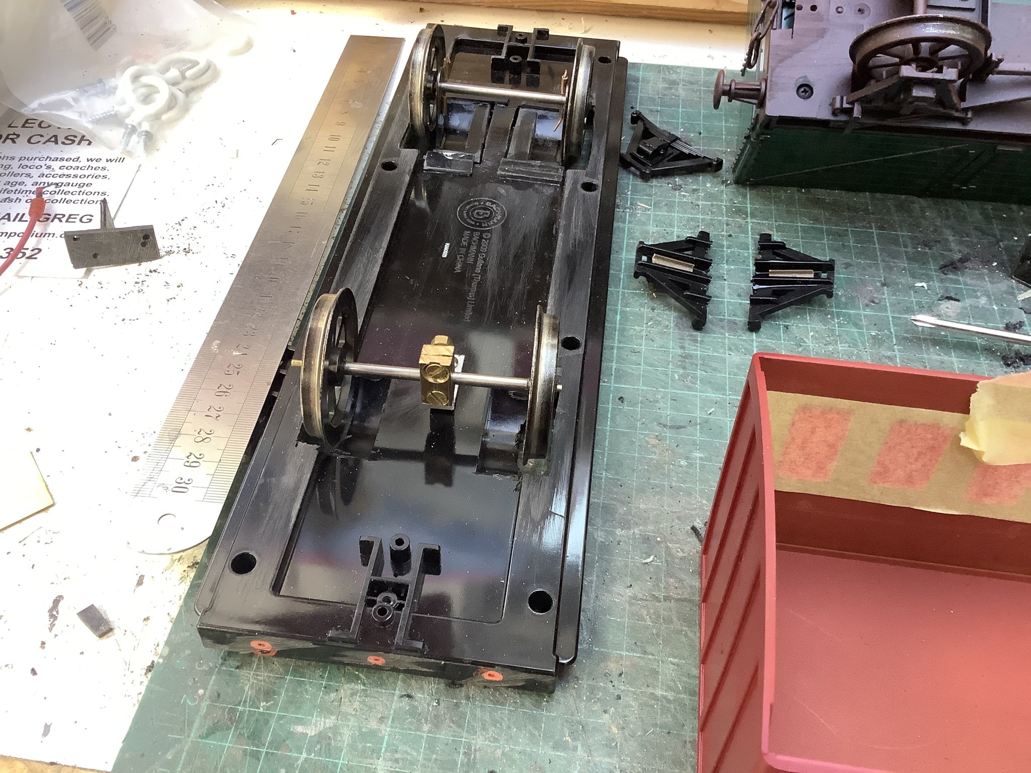

You might try kits for gauge 3 rolling stock but modify and fit 45mm gauge axles:wheel setsKeith - Im still waiting on my joblot of engines to arrive, been watching your vids to get ideas of their expected size. But with some Thomas rolling stock and eBay purchases arriving ahead of them, I now realise people are using G Scale and Gauge 1 rather too interchangably on there! Pic:
Doh! Chassis is too low to convert it to something either.
Do any companies models scale with our Thomas rolling stock, or is the Thomas line its own completely unique scale? I had been hoping I could scratchbuild more variety of troublesome trucks, but now Im not sure what to look for if at all now.
Would you or anyone seeing this know: are LGB trucks the same rough size (~100mm wide ~40mm wheels)?
The Thomas stuff is as near as you can get to Standard Scale in so called G scale, they can and are converted to Gauge 3 running on 63.5mm gauge for standard gauge. Running them on 45mm tracks means that they are running around Metre Gauge hence the ‘odd’ look when viewed from the front on the track. LGB messed with scales to get 750,760, Metre, 3.6” and standard gauge all on 45mm track. Commonly known as their ’flexible’ ruler!Keith - Im still waiting on my joblot of engines to arrive, been watching your vids to get ideas of their expected size. But with some Thomas rolling stock and eBay purchases arriving ahead of them, I now realise people are using G Scale and Gauge 1 rather too interchangably on there! Pic:
