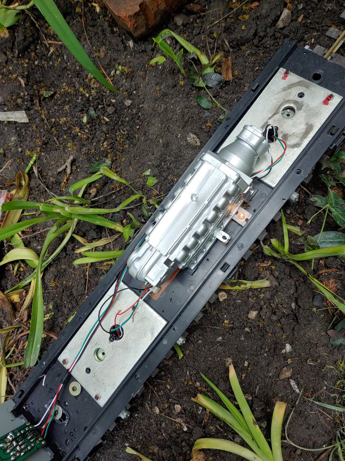

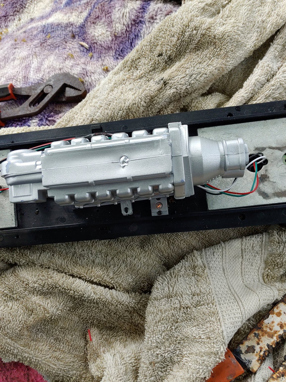

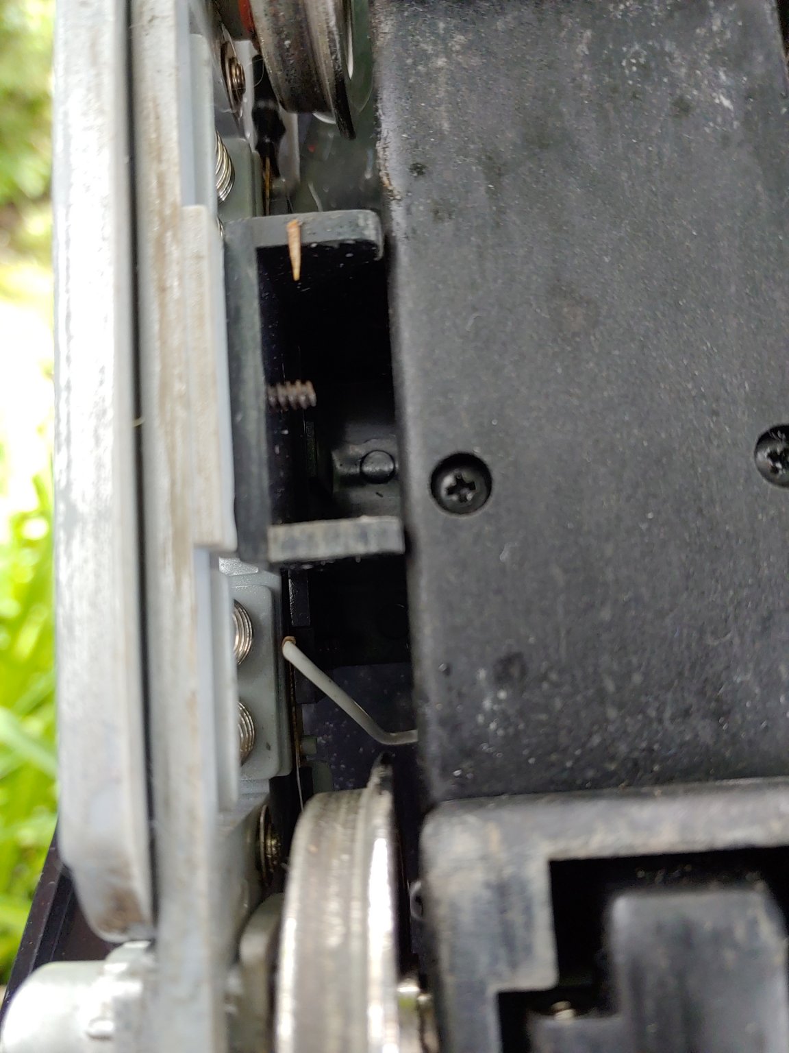

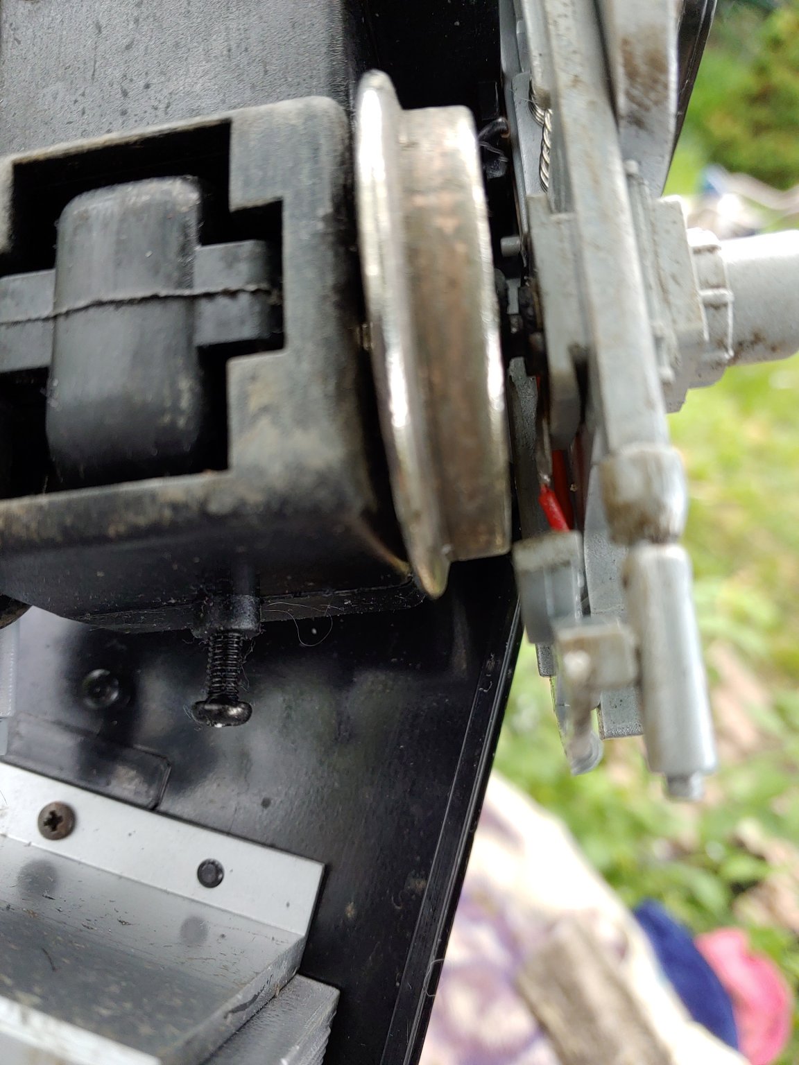

The train didn't go. I am breathing all this crap so I gave up. Last I saw the lights were on but the train was dead otherwise. I looked under the train it has a white on one side of the truck. A red on the other. The wires are so fine my wire cutter does not go that low. So used a blow torch to melt the wires. Still nothing but I still get the lights on inside
Ya
I hope my train is not toast. We just had lots of rain maybe something got wet

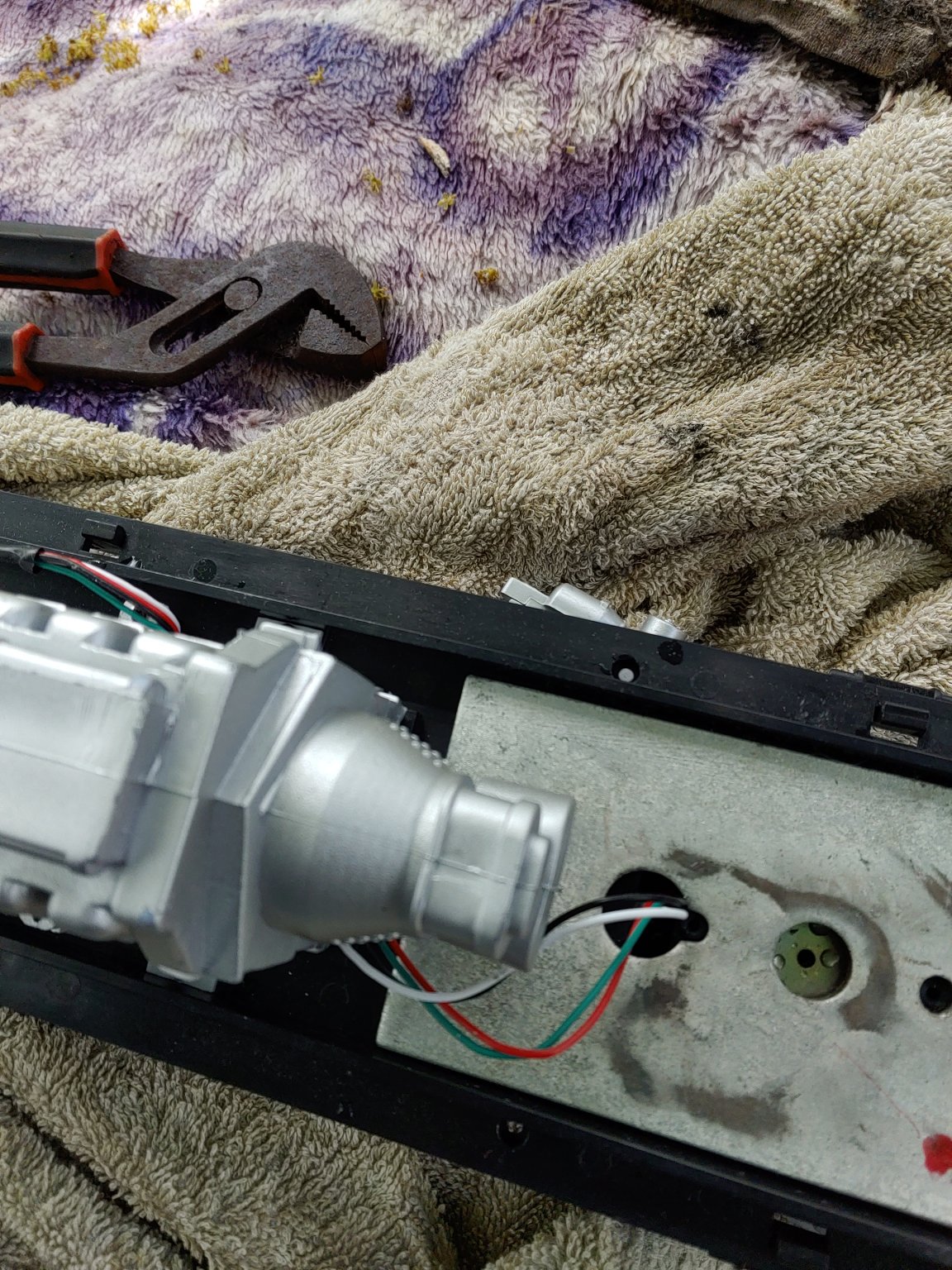

So it is not the battery. There in now something wrong with the engine. See how much brighter it is track power. The 9 volt will make it go very slowwww
It was working 20 minutes before the first post of it being dead. I cleaned the engine using the 9 volt battery belly up. Then put it in the tracks where it struggled big time. Went under a wet evergreen then this happened.
