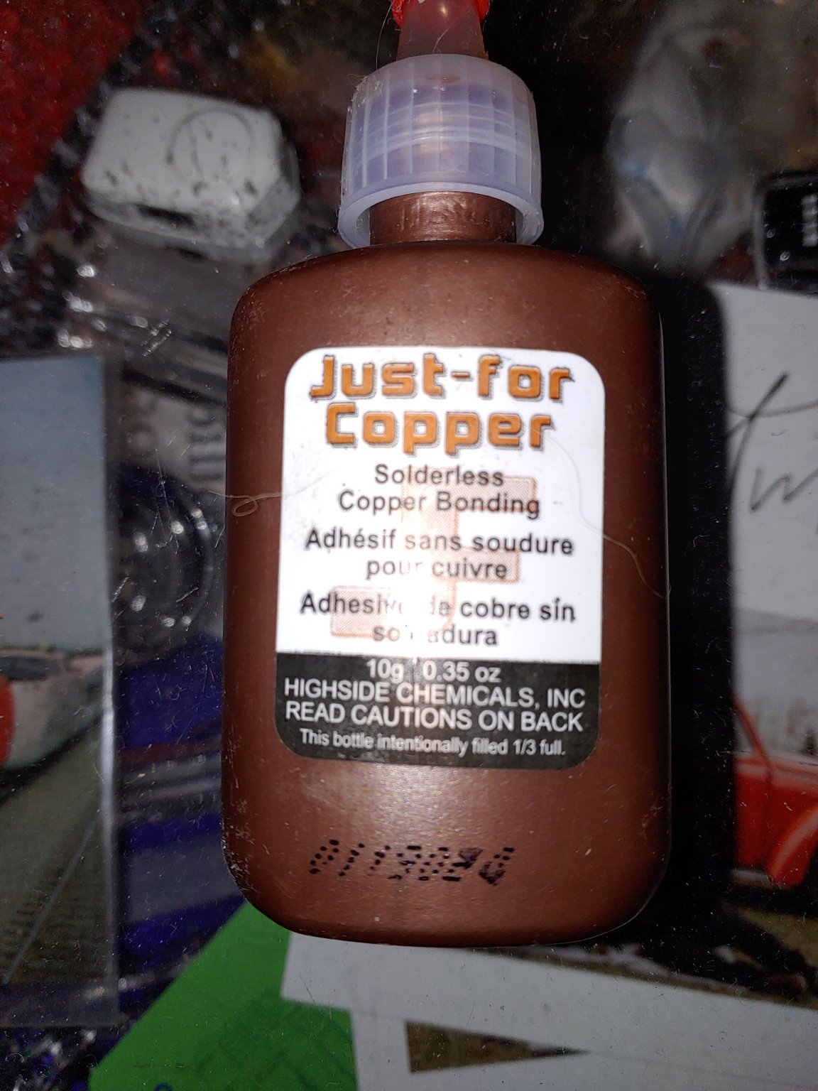

It is a tight pressured touch ...I will put up a picture of the stuff I use to solder my house plumbing with later today if I can find it. It is a small bottle with a liquid in it. In the mean time I am going to take the shell off of the f unit and look for wiring to connect the battery to. I opened up the rear truck yesterday and did find wiring I might possibly be able to use.
A lot of "liquid solder" used for making joints with copper is not conductive, (ask me how I know). I suggest you confirm you are using a conductive liquid, otherwise you will constantly have issues.

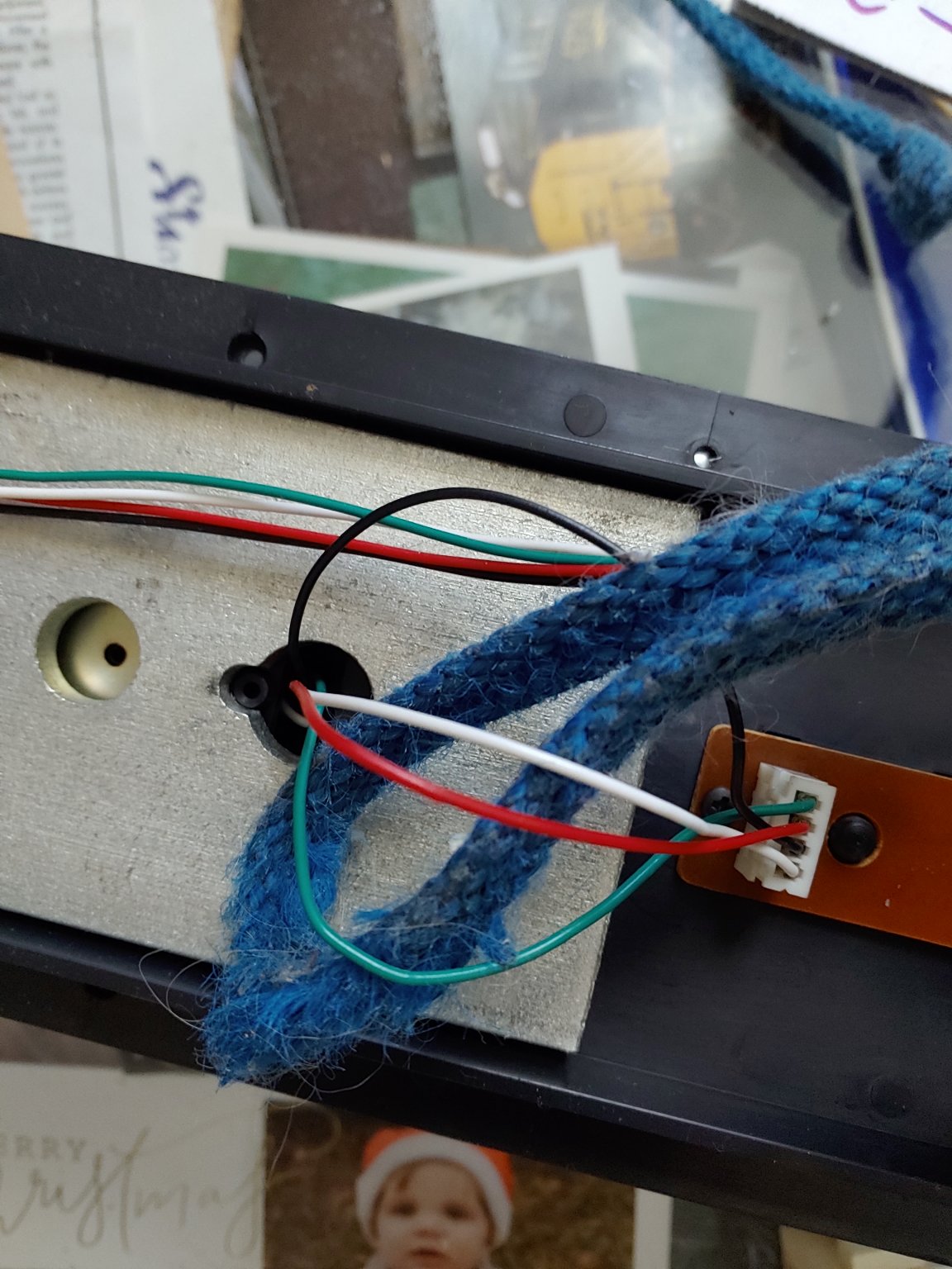

Ok got the shell off. To add the 9 volt battery pack I plan on snipping the white and red wires. The ones that are above the blue leash. So after snipping I will have 2 red wires and 2 white wires to the battery pack. As well it has dried out but this is the liquid I use to solder my household plumbing. It has copper in it apparently so should be conductive. I replaced the 10 gage wiring I was using with cheap home extension wire from the transformer. I James it into the rail joints. It worked but my other track joints are loosing conductivity fast.

That stuff is junk, it is not soldering, and is NOT for electricity, it is GLUE for copper pipes!!!
From the site:
Will not conduct electricity , Tensile strength in excess of 1000 psi
