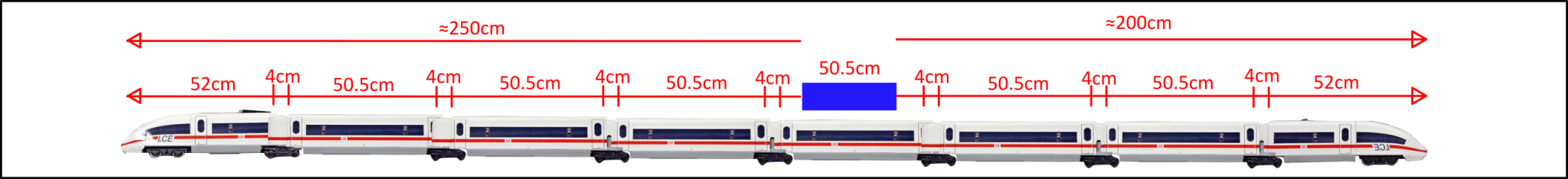

My current plan has the main components of the system, that being battery/receiever/soundcard etc, in one of the 2 middle carriages, as to lessen the distance and amount of plugs to each power car. The battery I'll be using it a 19.2V 4x4 AA NiMH battery from Fosworks.
I'll be using 6 wires; one each way for motor/speaker/lighting. With a 6-pin DIN plug between each carriage.
I'd roughly measured out that the line from the central block to the end carriage to be either about 2 or 2.5 metres, depending on which end. It will also have either 3 or 4 DIN plug connections to go through.
With extra wire in each section for a bit of reduncancy, that roughly makes a length of about 2.5 and 3 metres back and forth, give or take.

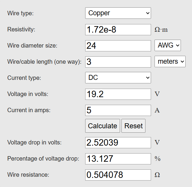

I've been told, and from what little I could find, 24 AWG wire is good to use. Though putting that into a voltage drop calculator, with 19.2V and what I assume it to use as 5amps, the drop comes to 2.5V, which sounds like a lot?
I don't know if that's significant enough to make a difference, or if 5amps is what goes through the wires.

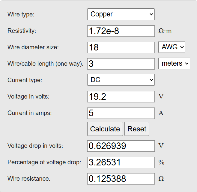

I've looked into getting 18AWG wire, and that has a lot lower voltage drop. But is that suitable to use between the receiver/esc/soundcard as well? Or can I use a thinner gauge between those components, and use the thicker for the long run to each end?

Where do you get 5A from?
Remember you are feeding out either way, so only half the current will be going to each end.
I can't see your motors pulling more than about 1.2A maximum. LED lights take mA so will not put any drain on things. Speaker wires are also not going to be doing much.
24AWG will be fine.
I have never worried about voltage loss in a train, even a relatively long unit like you are creating. Tis relevant in the garden where you could be talking about lots of feet and dodgy track joiners but in your situation no worries so long as the joiners are in good condition. Perhaps after time with regular pulling apart and putting together you may have issues with them but would take a long time.
24AWG will be fine.

As a general rule when the doing traction-current wiring within trains.... use the thickest wire that has adequate flexibility for the purpose.
