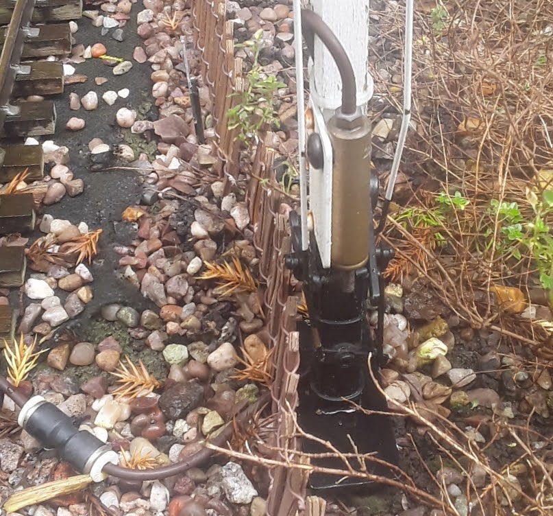

Air powered point motor in-situ on LGB R5 radius switch. These straight drop ins to fit LGB, Piko, USAT and other compatible makes of switches.
Detail of Klippard pneumatic motor based (from Sunset Valley Railroad, US based supplier) air powered signal application. Same pneumatic "motor" is used to actuate a switch, which is "inline" to this one to actuate and show direction point is set to.

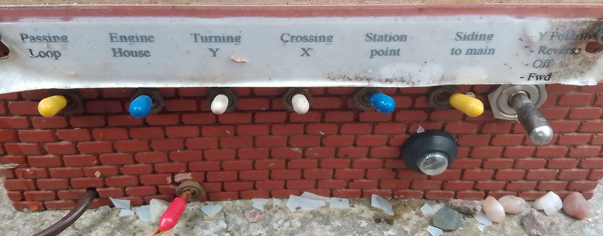

The back of my little signal box. This houses the toggle switches that actuate the individual or grouped parts of my system. Big switch is a hangover from my track powered days - used to reverse polarity of track in my turning Y .

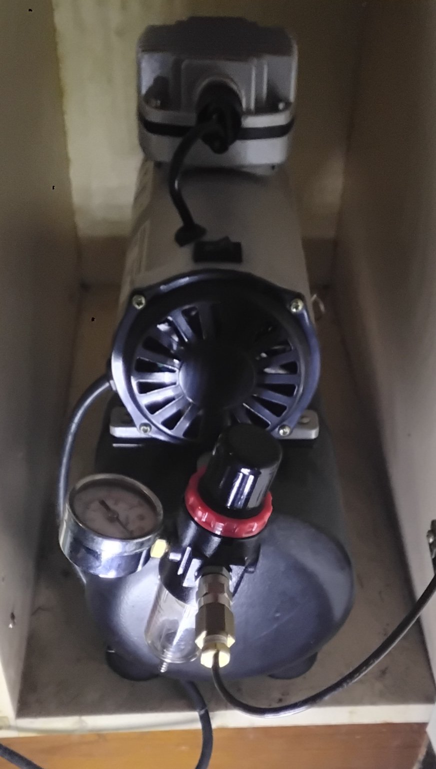

Compressor in its hidey hole in the kitchen. It's actually a 3ltr receiver with this compressor, with its heat sink on top, that this one is sitting on. The water trap is the glass bowl at front. Pressure gauge and dial to set pressure at desired 30 psi level is there too. Note the size of the pipe feeding the system, same as the rest, 2mm od/1.6 mm id.
