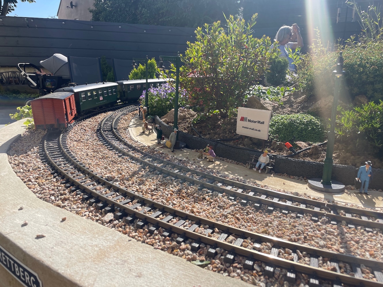

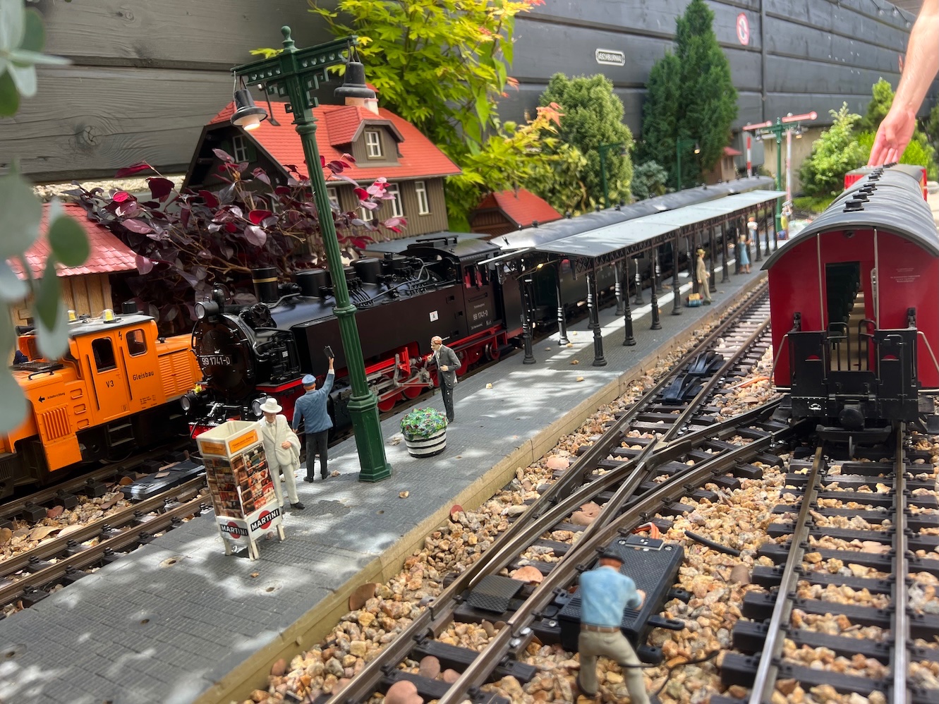

A couple of pictures of the final effect:
What Curtis said about solid blocking of some sort under turnouts is a great piece of advice. Ask me how I know.
Gardens move, soil moves. If you keep the track base simple, then it's not a major job if it needs adjusting and re-levelling every few years.
Yes amazing where the ballast goes, so buy extra, otherwise when you want to top up, you can never find the same stuff again - don't ask how do I know, but then look at 12 inch to one foot, and ballast is different colours.

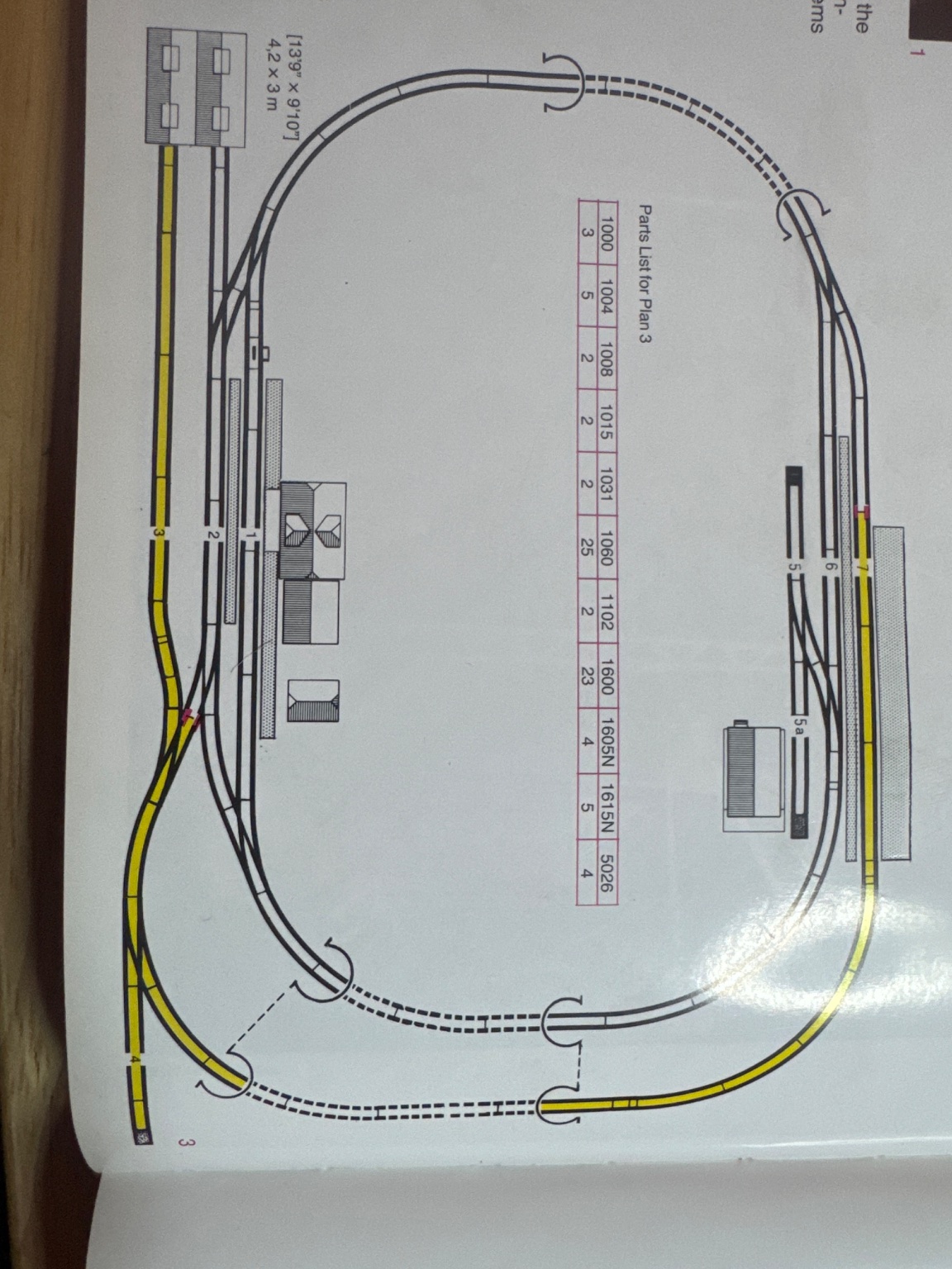

I’ve hit a snag. I was trying to replicate a layout in the lgb track planning guide.pg 74. I acquired the parts from the list but can’t get it to go together. I even tried putting it in any rail. Any tips suggestions or maybe I’m doing something wrong. Maybe someone else can take a shot at any rail or scram etc ?

So where does it not work? To be honest the plan looks a bit off around the left outside curve.
For one it says it’s 14x10. Second I tried counting the pieces but I can’t seem
To understand where the 3-1000 go. Thirdly which ones are the short tracks?
I think there are two on the inner loop, lhs just above the platform, and one just below the point, by the platform on the right?
3-1000(0) should be the 12 in Long straight tracks qty 3....

The 3 x 1000 tracks are the 12 in straights, which look to be where the engine shed is....

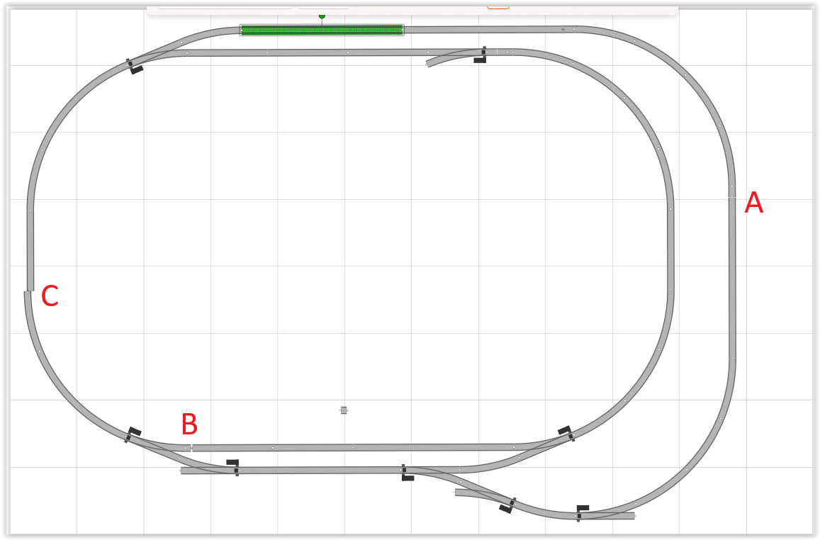

With my "50 free pieces" I've had to replace each 2 x 1060 with 1 x 10610 (as in green), and had to omit the sidings, but I seem to have made it sort of work (though not fit the size specified by a long way (5.5 x 4 metres?).
I had to omit the 1004 at "A" to get that loop to rejoin . . . and there are small disconnects at "B" and "C" but not so much that they can't be dealt with "a little flexing".
I also used a 1060 at "B" instead of whatever (four pieces???) they intended.
How far out from this is what you achieved?
Cheers

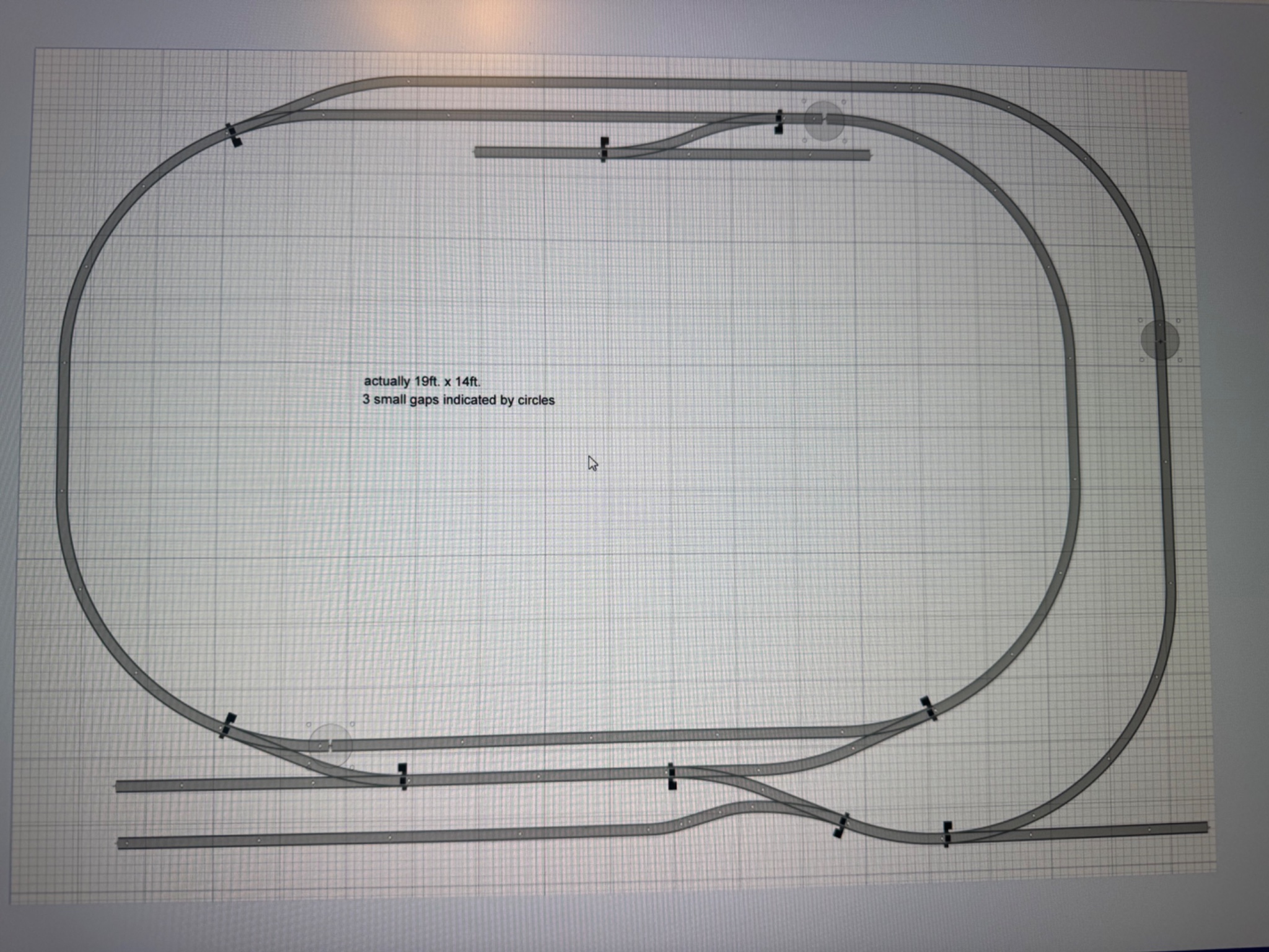

Thank you. I took another shot at it and it turns out to be 19’x14’ actually and 3 small gaps
Now I actually have to build a raised platform. I was hoping I could drop it on my deck just to get something running and save a few dollars. Oh well I guess!

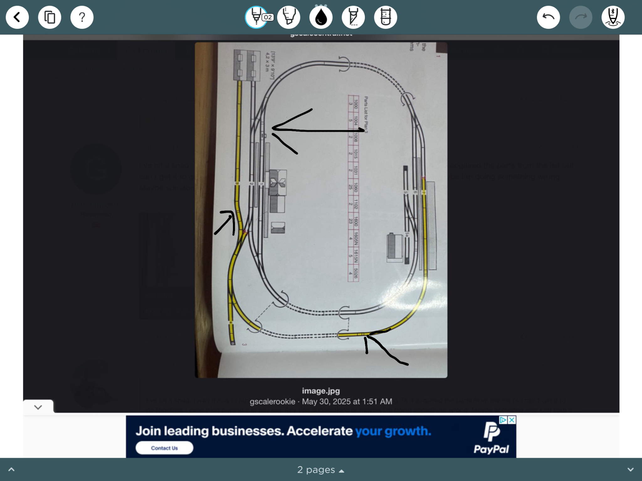

From what I can see most of the straights appear to be 1000 type, short sections appear to be where the arrows are in the pic below. I would suggest making up what works then see where you are. This is a very odd track plan by LGB typicalling I believe making you buy more track than is really needed to make a balanced interesting line.
The long line to the loco shed looks very odd to me, also a couple of very short sidings could do with a remodel. Far better woukd be to loose that short siding on the loop at the bottom left using the point at the end of the loop to make a balanced curve at the bottom of the line. You could then use a left in the loop to make a slightly shorter shed line. The spare right point could make a third loop on the right hand station. Any spare track could be possibly used on sidings to the right station.IMG_8581.png
