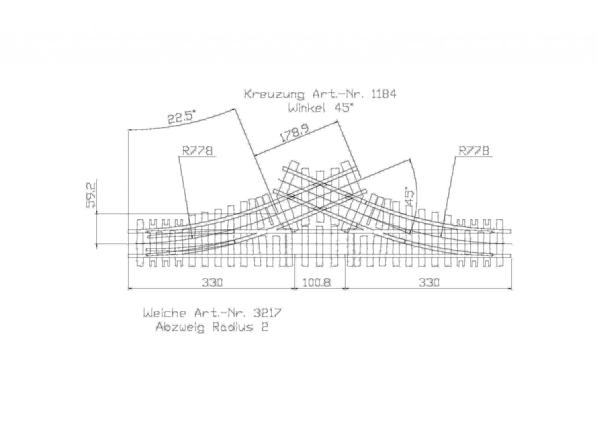

Hi, do peko make an R2 curve to match the R2 LGB ??. Cant find one on their site. Thanks

Train Line 45 does a 900mm radius turnout which is wider than R2 (~780mm) but tighter than R3 (~1195mm)

I found the reference to "LGB R2" points..... Model Workshop Bertram Heyn makes them.I have it in the back of my mind is that one of the boutique G Scale makers may, but I can't recall which one.... and it is likely to be expensive.
Trainline45 also make R2 points - several of us on the forum have used them for a while.I found the reference to "LGB R2" points..... Model Workshop Bertram Heyn makes them.

Sorry - missed your earlier post. However, when I installed some TL R2 points they simply dropped in where I’d previously had an LGB R2 curve - weird.As noted earlier, the Trainline 45 medium points are 900mm radius, which is non-trivially larger than LGB R2 at ~780mm!

Looks like I was wrong (again) have just taken an LGB R2 curve to compare with a TL45 R2 point, quite a difference in length as the pics below show.Do you know I think I had that as a plan on my Railway in Hemel, bought the point after checking that they were a perfect fit for an LGB R2 curve but never got round to fitting it before the line was dismantled. But it eventually got used on my new line though not in that configuration. Silly really as it would have made the run round potentially longer at my Harzegerode Station always a thorny place to get a train reversed and shunted with the limitations on train length.
